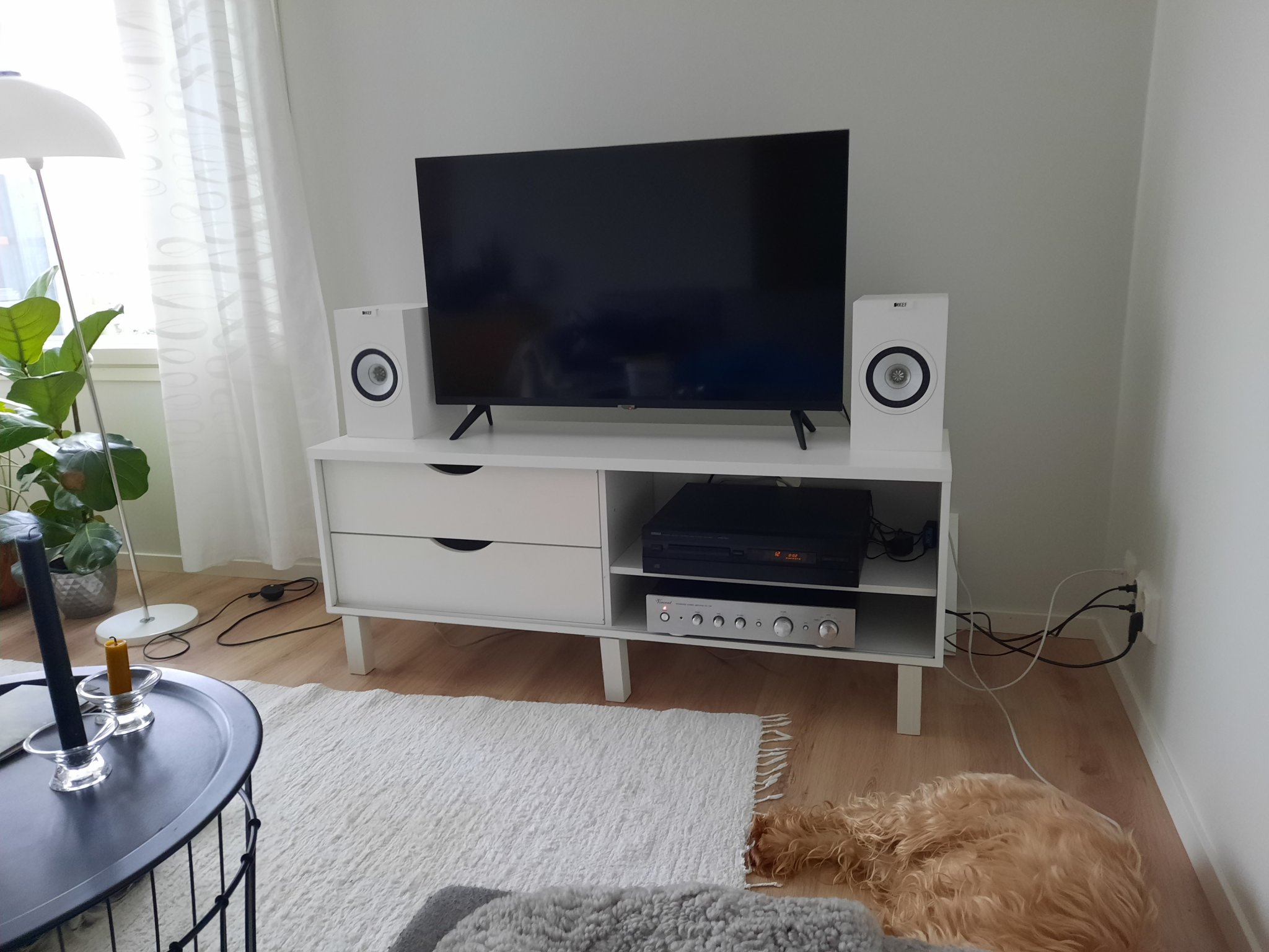

One pair of Q150 will go to my daughter and the hobby pair moved to my new "girlfriend's" apartment accompanied with some of my vintage gear. They sound amazingly good as such, also bass is decent with modest spl.

Q150’s are my main mixing monitors now with a twist. I modded the enclosures last year and created a passive cardioid design similar to the Dutch and Dutch 8c. This took a lot of trial and error to get right but I’ve got a fairly even directivity out of them down to 500hz which was needed with all of the reflective surface area of the screens in between them. They’re actively crossed to a compact stereo subwoofer at 100hz that sits behind the screens with the drivers firing left and right. This arrangement was possible only because it’s such a nearfield installation. For the regular listener, a pair of fwd facing woofers in a box/stand would be the better way to go.
The Q150 will likely go back on sale near Black Friday for $350 a pair or less and it’s a great stepping stone for DIY efforts at that price. If I had the space , I’d grab another pair and do a quick and dirty dipole with the Q driver mated to an 18” woofer or a pair of 15’s……that would be a fun project for sure. Or for those that can’t get the clearance from the front wall?…..take the D&D approach the whole way with a new enclosure and two rear firing subwoofers coupling to the wall. One of those Dayton DSP plate amps and another ICE module and you’ve got a $10k for around a grand with some effort and ingenuity.

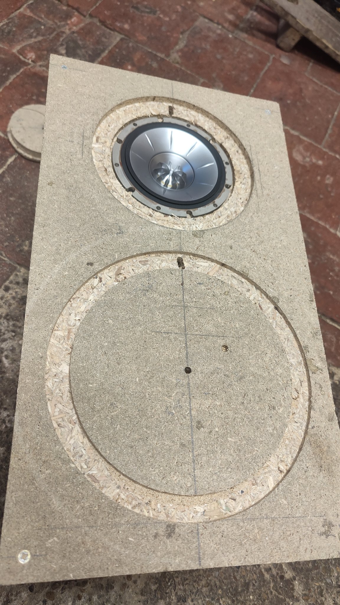

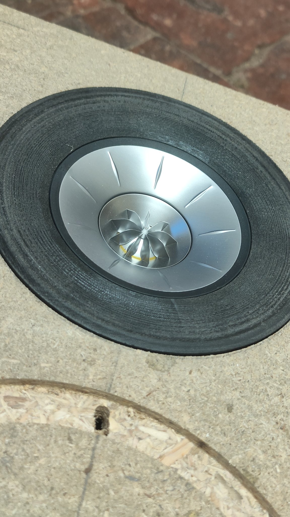

My current diddlings.....
Where did you get the driver from? Butchering R3s is getting expensive.Stiffer cone and surround and an evening lower profile 'z' surround than the Q. Much cheaper than LS.
