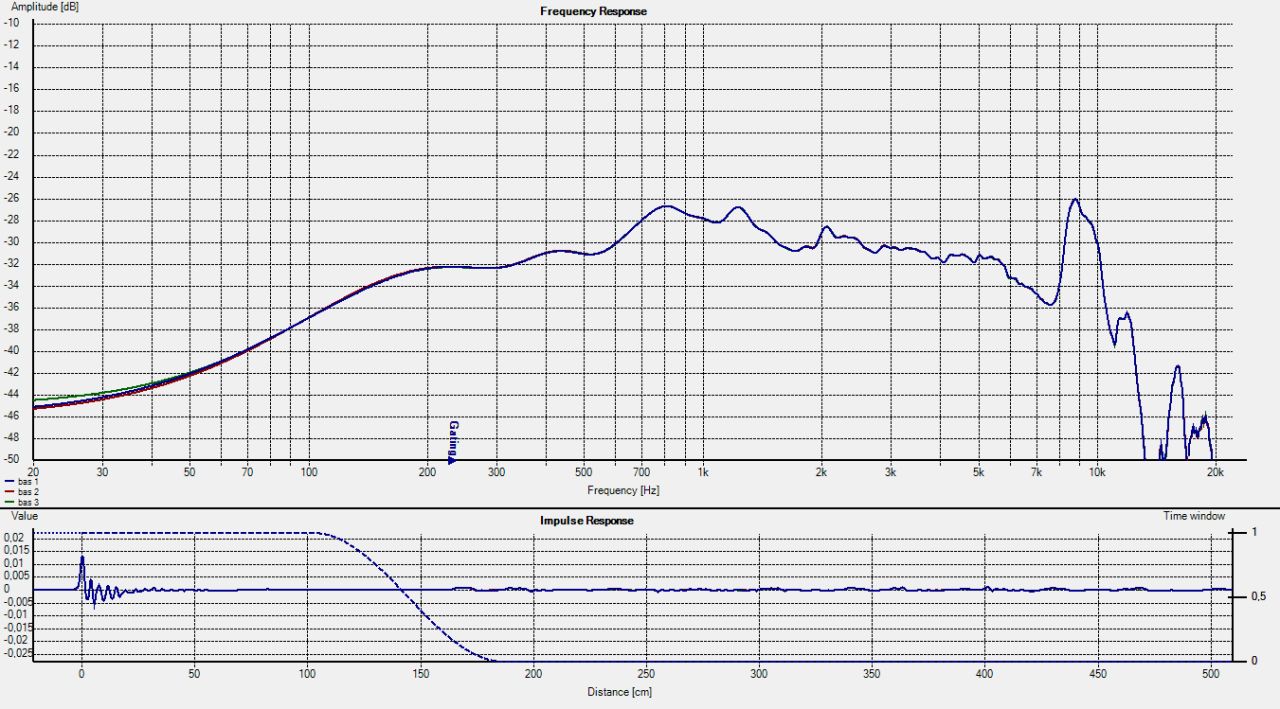

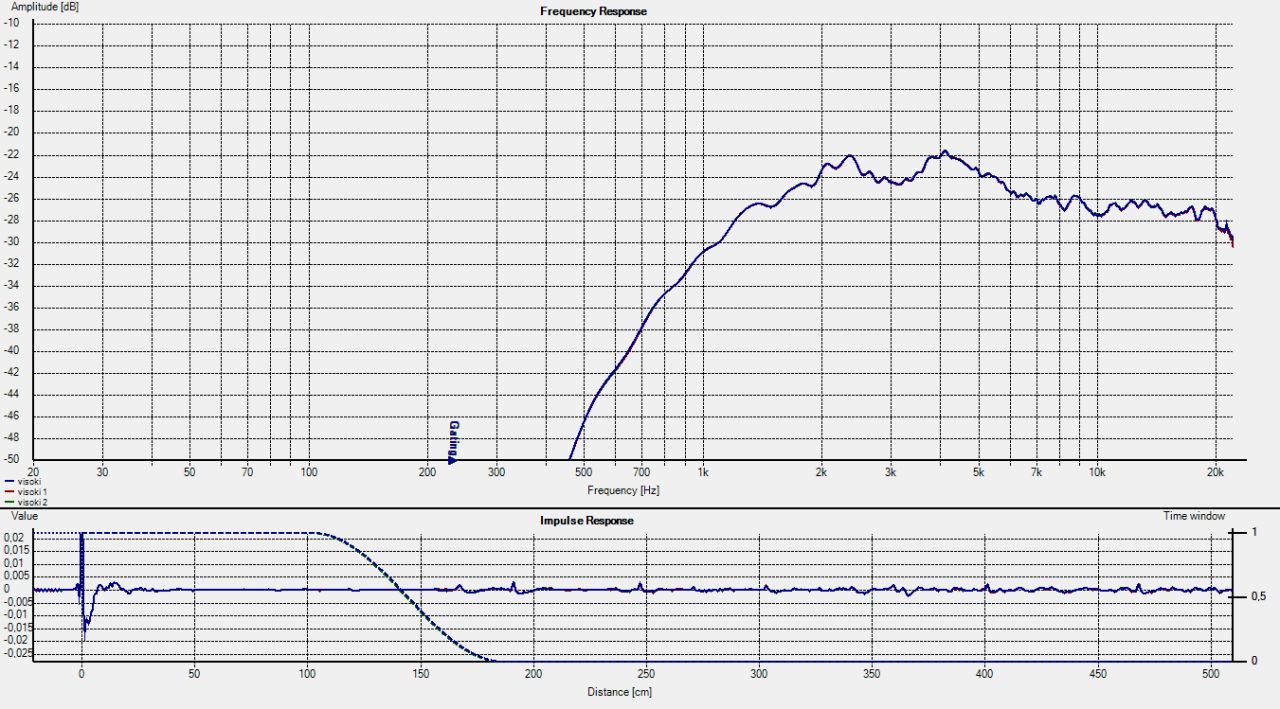

No, I have spend too much time to measure my big system when I was designing-it: tired, now.
Those Kef are is a self powered closed system: I plugged them, and... did not enjoy after the first surprise. My listening room is... as it is.
Worse: I prefer listening to my 150$ PC speakers. Not detailed at all, but, at least, balanced: full range (no tweeter) + little sub.
I will try to build an amp in order to can use my big sub with those: will see, but don't have a lot of hope. Fundamental of voices are not so low in frequencyand I will not gain a lot of "presence".
Kef made a mistake, IMHO, in offering a unbalanced system: when you lack of bass, you have to cut the trebles. Those speakers have lot of qualities, but they certainly do not desert the rave comments that I have read about them: they just sound ... unrealistic and unpleasant.
My purpose here is to moderate those comments by a more realistic report.
