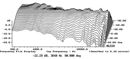

Here are the horizontal polars of the LS50
Here are the horizontal polars of the 207/2

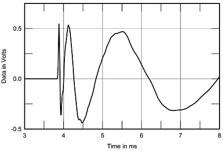

Here is the step response of the LS50
Here is the step response of the 207/2
If we look at the loudspeaker enclosure, the polar response, and the step response, there's only one thing that's changed dramatically : the step response of the LS50.

For comparison's sake, here's the step response of Dunlavy's SC-IV
And the ideal step response, from Linkwitz's site
Jack Oclee-Brown said they didn't want to make the flattest measuring speaker but the smoothest sounding. Reason for that philosophy is beyond me.

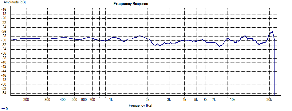

Here is my measurement factory vs modified on axis.
https://s15.postimg.cc/mysuaxv57/image.jpg
One thing though (i'll get in trouble for this) tweeter in Kef R300 with modified crossover is much better than Seas DXT in Kii3 that i listened.
Interesting project to make a new crossover for the R300! Thanks for sharing 🙂 I just thought that could also be a nice project to activate the speakers.
