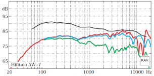

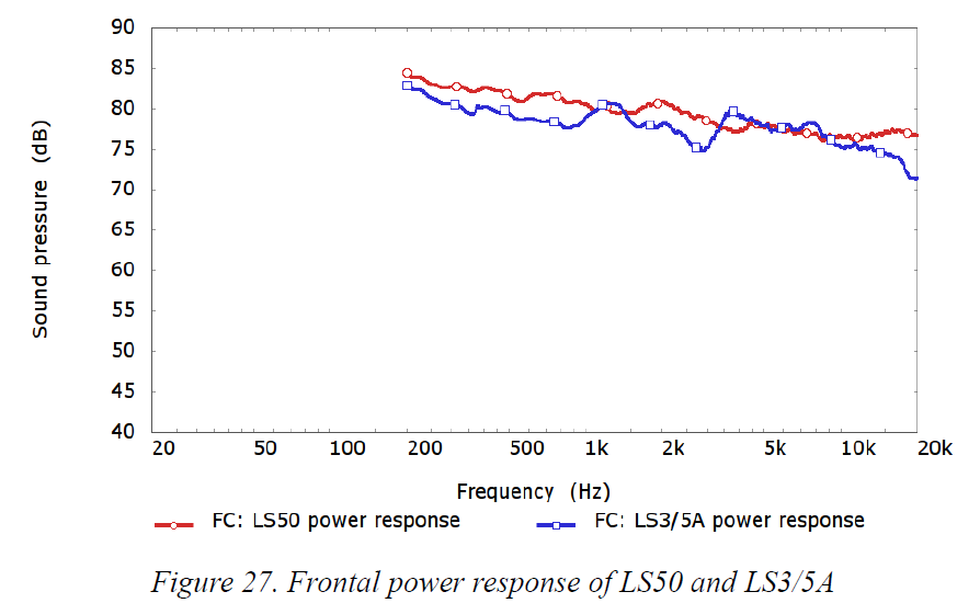

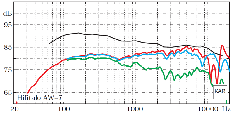

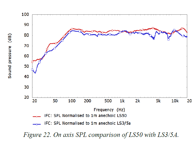

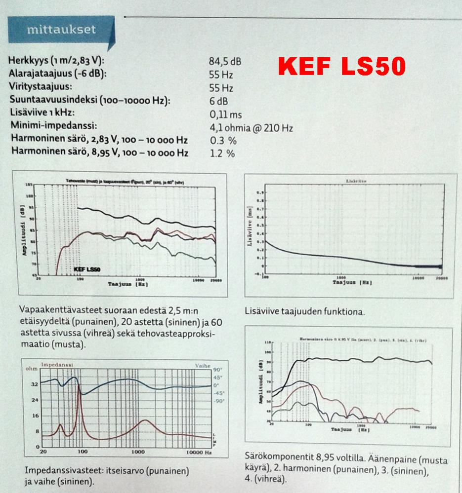

There is a test of LS50 in a Finnish hifi-magazine. The voicing is indeed bright and dry (monitor like?) Bass rolls off like a closed box until tuning fq and treble is high from 3kHz up on-axis. The overall verdict is very good for the price. Hifimaailma.fi - Etusivu
I guess you would like to have subwoofer(s) with them. I have a triplet of SEAS coaxials in closed boxes in my HT room and I like the sound very much. Could be rather similar to LS50.
