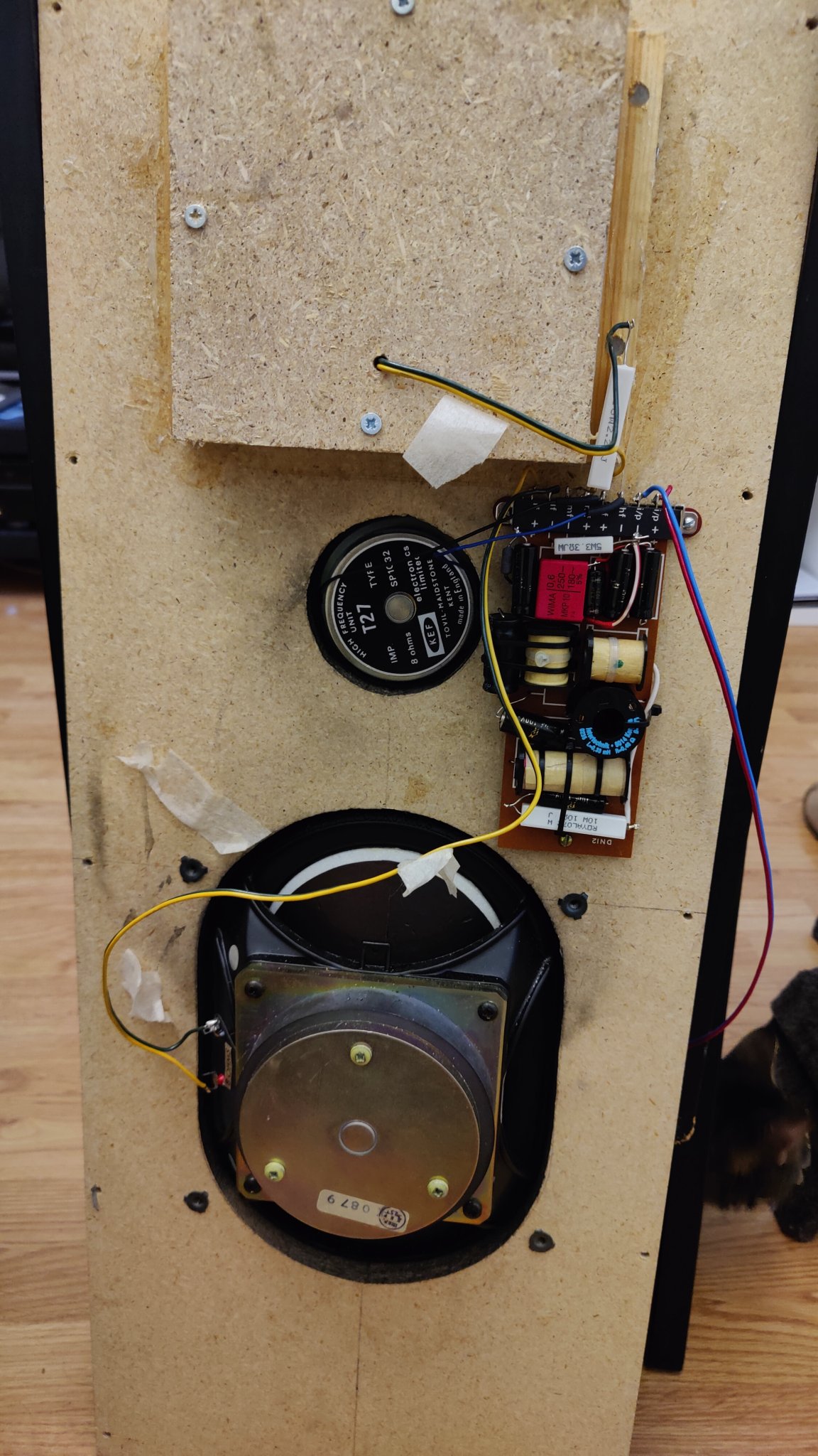

I made this crossover mod with mostly standard alcaps to my kefkit 3. I have about 65 litres closed encloser for b139 and about 0.2-0.3 litres closed encloser for b110. This crossover made huge difference to original and im in love to these speakers now.
I might need little more something in lower bass and higher mid am just wondering should i make bigger box for b110 and maybe something like 60litres open encloser for b139? Heres my example of the crossover
I have tested speakers with priboi 2x50w tube amp and Rane Ma6 6x100w amplifier and i can spot same problem with these amps. Just wondering what you guys think before i start to do anything.

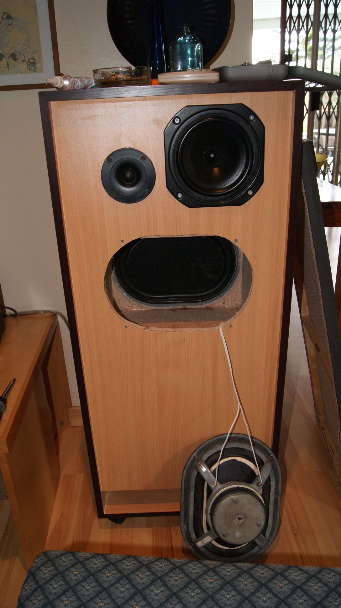

Your mid enclosure is too small for the B110. If closed, a 60 liters box is to small for the B139. You could drill a vent of the right dimensions. I like the B139 in the Concerto better than in the (closed, bigger) Cantata.Hi

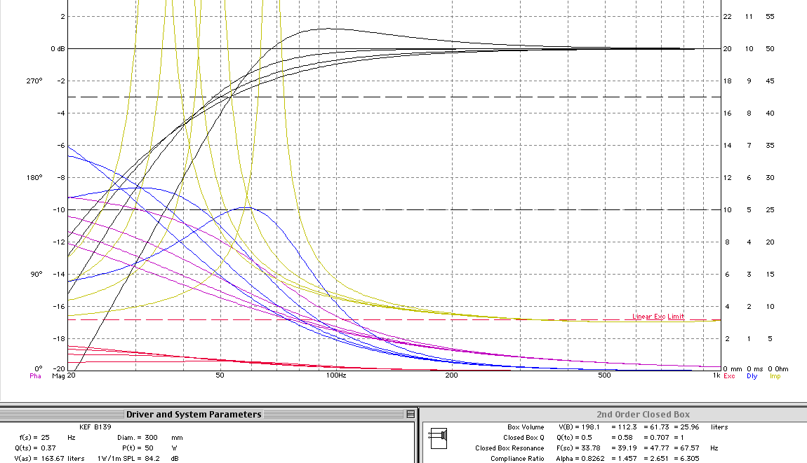

Okay i bought 6" plasticpipe for b110 and i could make 2,5litres closed encloser for b110 and still get something like 62litres for b139 just wondering does it sound good to you guys? For b139 vents i have to put two pipes maybe 2".
that will make things much better for the mids.
as to the size of the whole box, I am still not sure if it would not better to have it vented (vent with right dimensions!) like the Concerto is. I cannot sea which lines are which in @planet10 's simulation above.
Remember that the Concerto (with about 60 liters) already shows a slight bass hump (i.e. enhanced bass) below 100 Hz. Can find and show KEF's own frequency graph. So with a closed box that bass hump imho will be farther upwards in f, maybe around 100Hz, and higher. --> not linear anymore.
I found that the Cantata (B139, B110, T52, different crossover) has this bass hump, although it is bigger (I think about 80 liters). If you have time you could simply construct a new enclosure and test. After listening to both the Cantata and Concerto (I own both, Concerto w "new Crossover values, Cantata w restored original Xo) I prefer the Concerto's bass.
It should be obvious. As the Q rises the peak rises and the curve does not extend as low.
