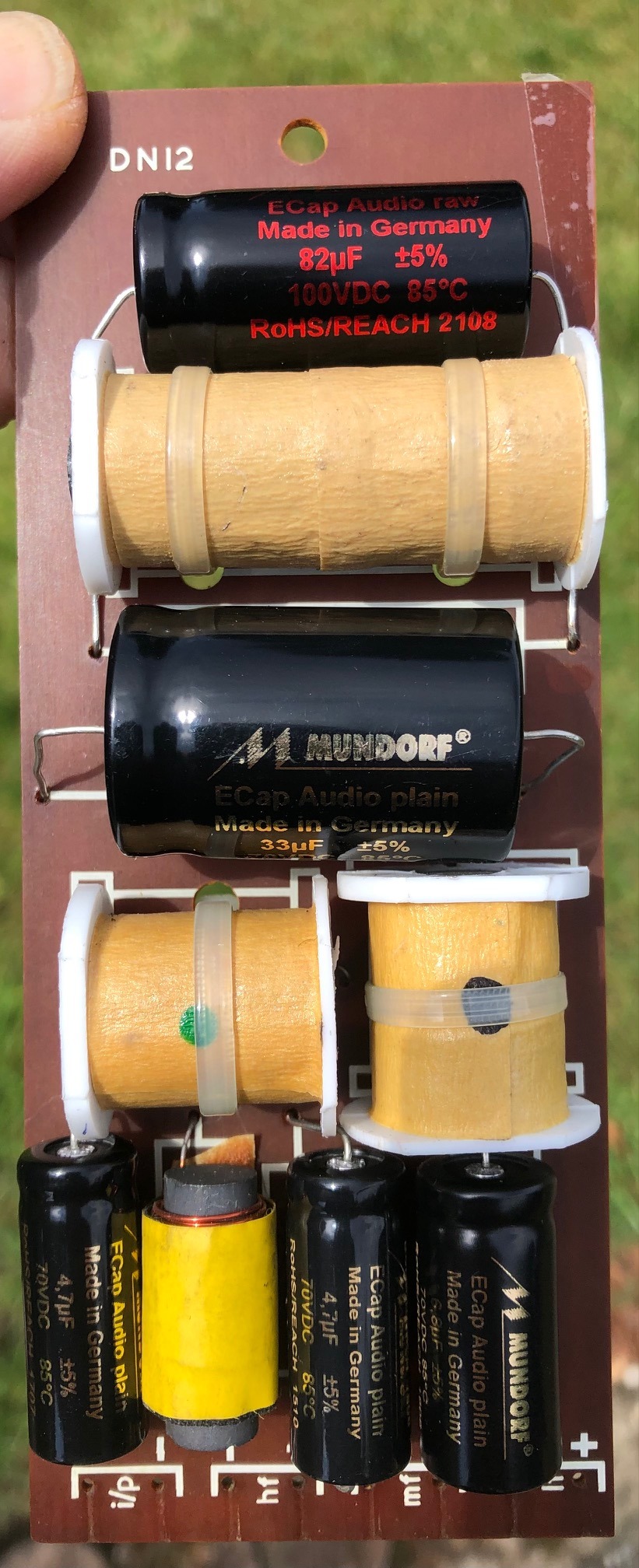

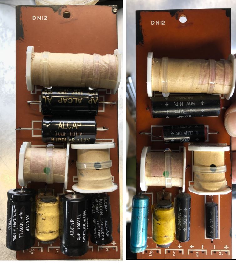

I have already recapped my 2 sets of Concerto’s.
Set I witch Alcaps from Falcon. (see image)
Set II with Mundorfs. (see image)
The inductors of both crossovers are still the same.
Would it really be recommended to replace these as well?

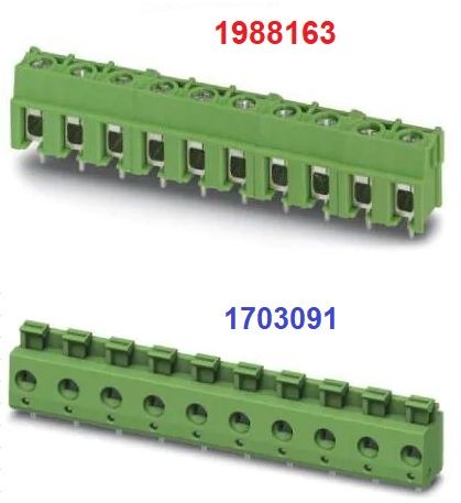

From set II, I removed the connector as it was severely corroded.
I was advised to use a Phoenix-connector instead (PTS 1,5/ 8-7,5-H 1703091 PHOENIX CONTACT PCB terminal block or Phoenix Printed circuit board terminal - PT 2,5/ 8-7,5-H – 1988163 ), but I soldered the wires directly to the filter. A lot cheaper … and quite difficult AND expensive to buy in Belgium
(see image)
