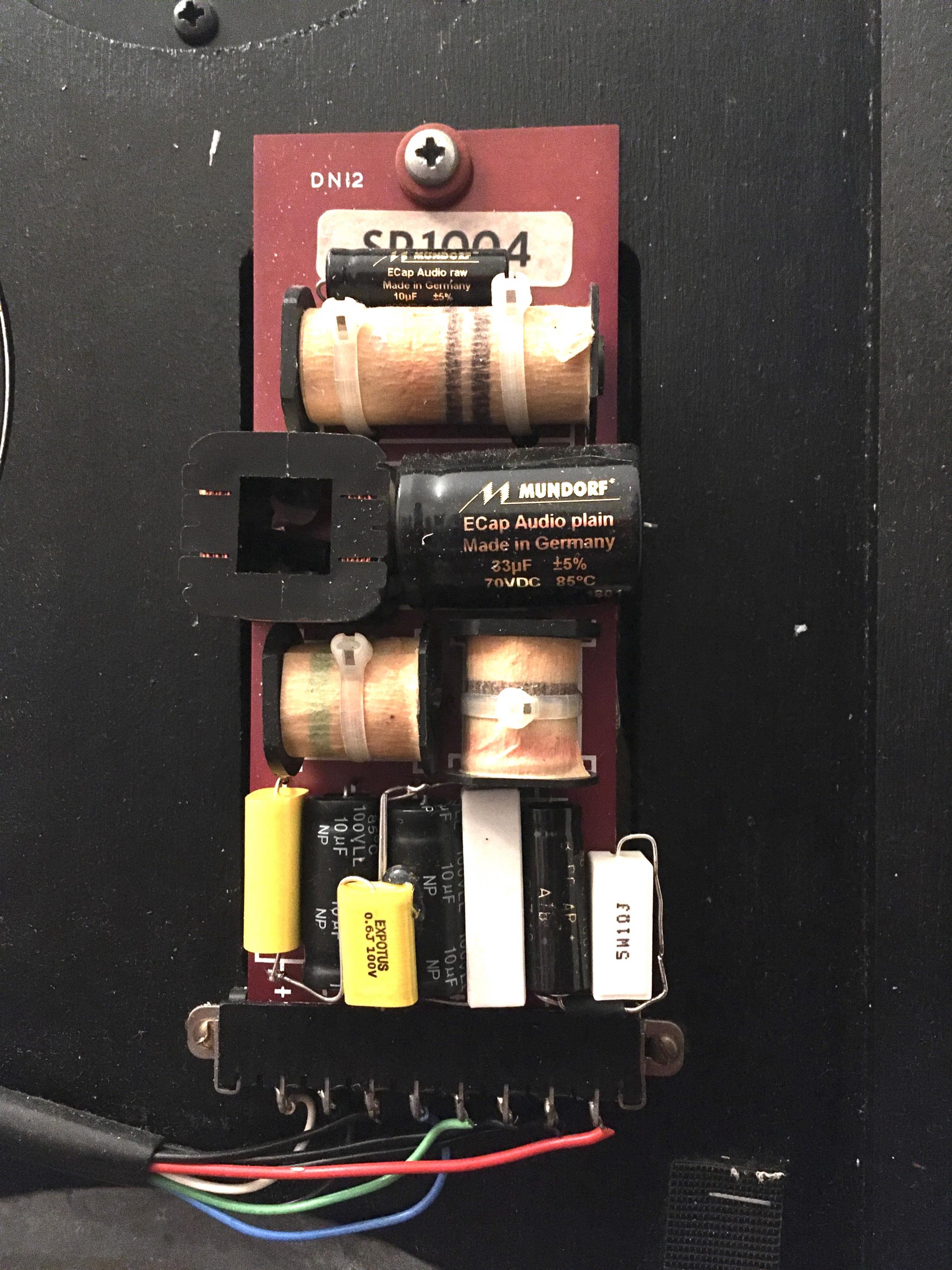

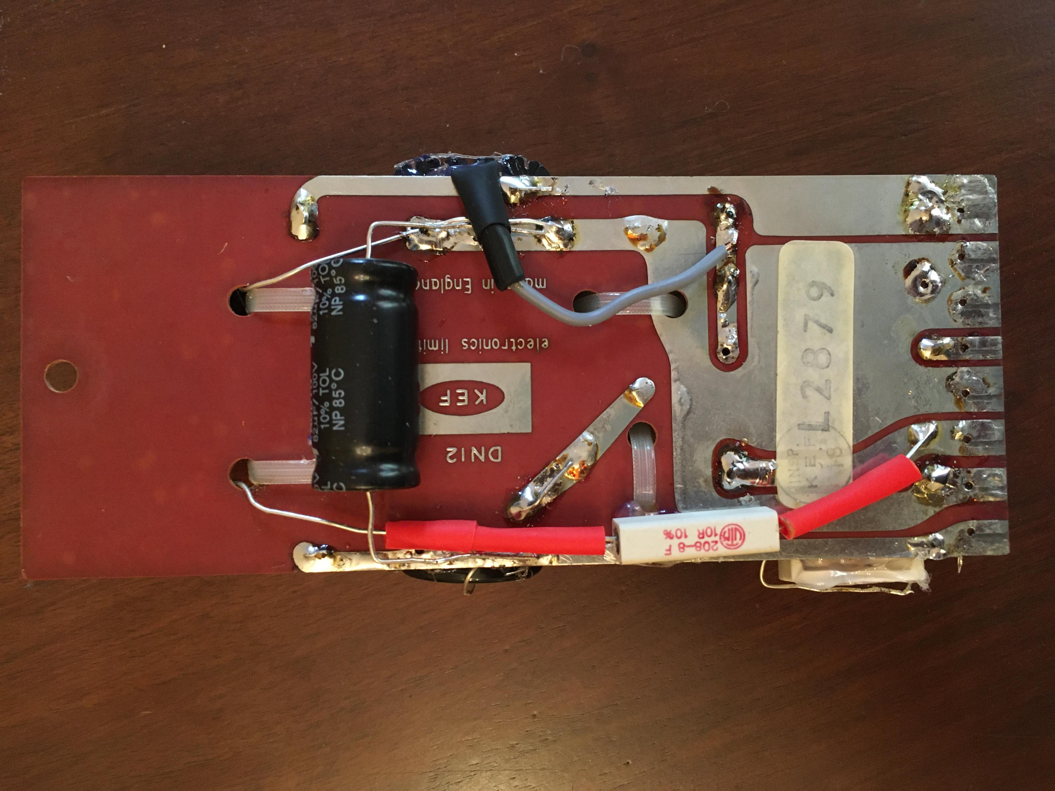

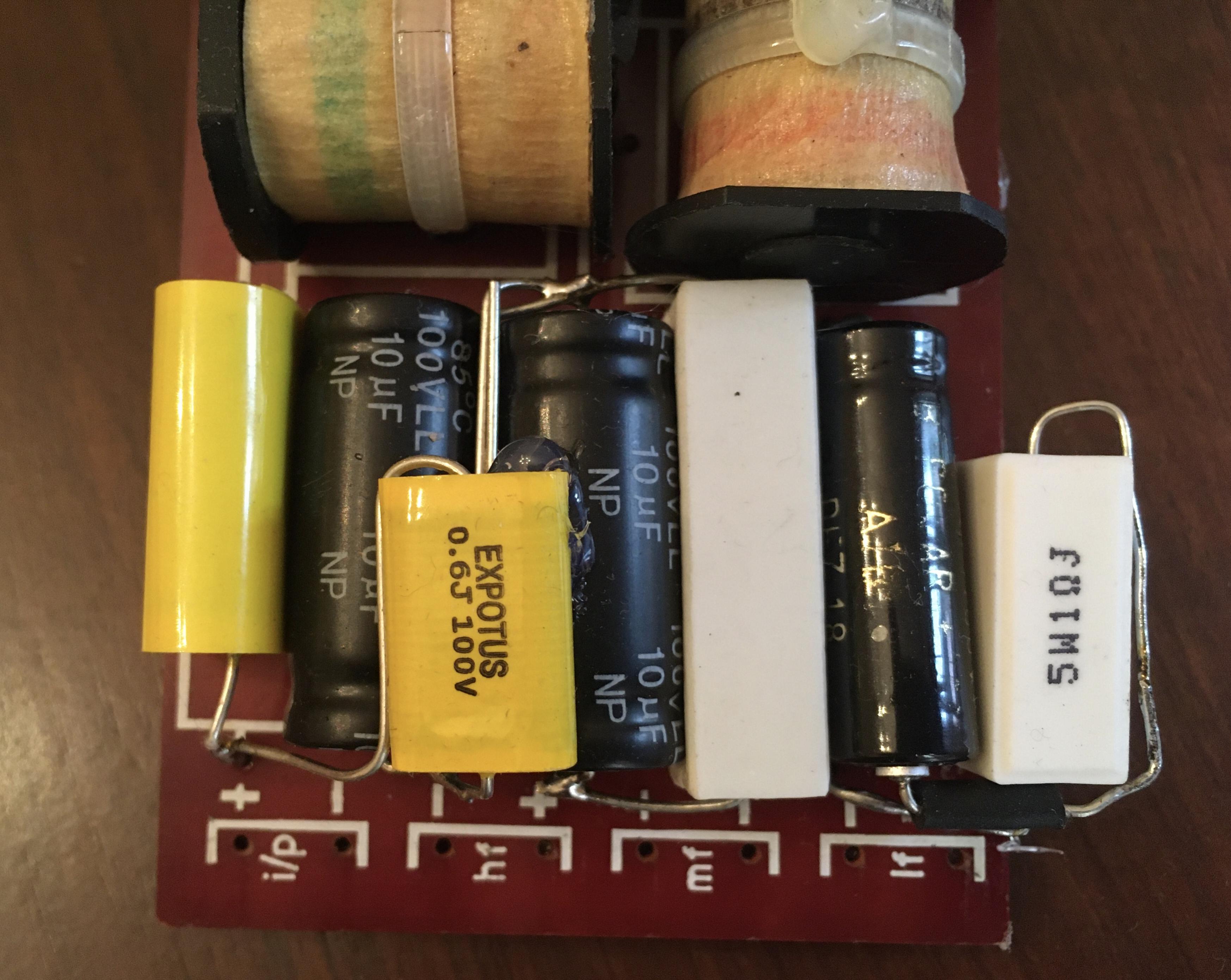

now some pics. I relocated the new air core inductor for the tweeter section as the caps of the aB section were to many and to big, so needed all the space in that row. I also put some elements on the solder side of the xover.
it is still to "thick". but as the textile on my grilles is worn out anyway and needs to be replaced I didn't bother with it being a bit stretched. So cosmetically with the grilles on the whole thing is a bit tight.
And please bear in mind that I turned the connectors 180 degrees (the wires are long enough but you'd need to proceed with care).
It pays to thoroughly clean the connectors and the contacts on the boards. I used stiff cardboard drenched in De-Oxit for the connectors.

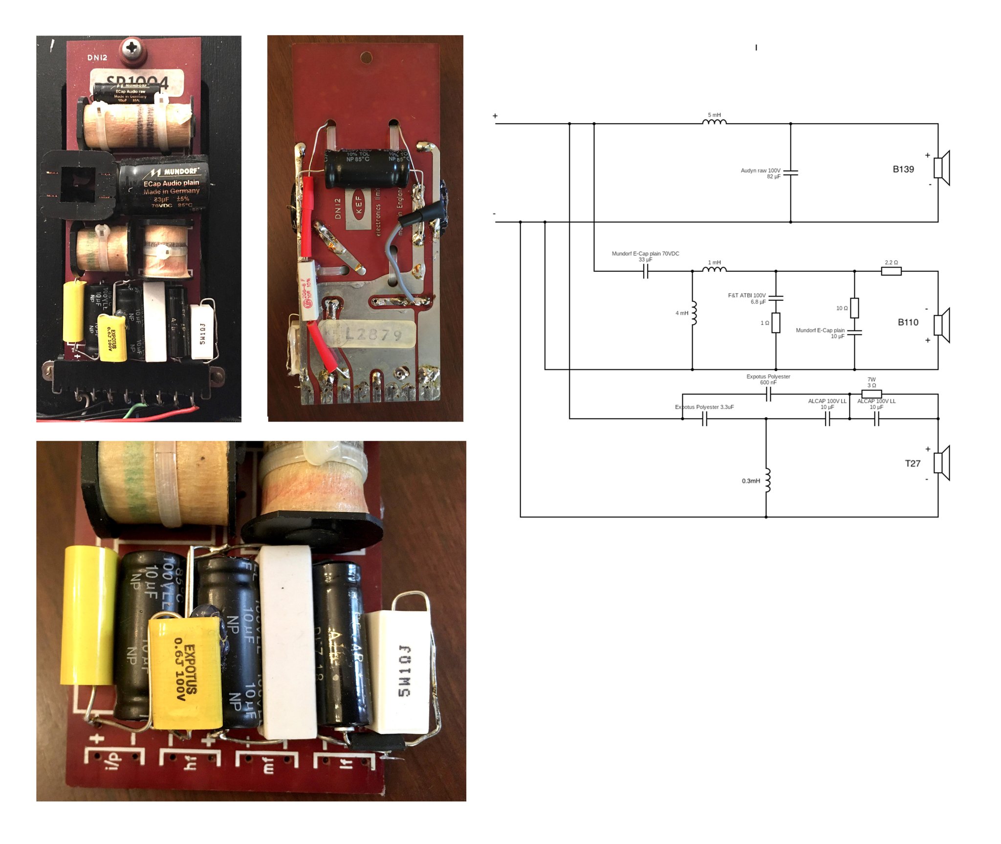

Hi @eschenborn 🙂
Thank you for sharing all of your experiments and findings on this crossover rebuild.
I unfortunately have no technical knowledge/skills and can't follow along, but am going to look for a local technician to rebuild my KEF concerto crossovers to your spec.
I have 3 questions:
1. If I provide a technician with these schematics and reference images,
is that enough to understand what's been done, or would a summary of written instructions be necessary?
2. I copied this list of parts from your diagram, is that everything I will need? I want to save the tech the job of ordering them if I can.
(I think you said I won't need to replace inductors, as they don't expire - not 100% sure which parts they are, but have put in brackets with "?" )
5 mH (Inducter ?)
Audyn raw 100V 82µF
Mundorf E-Cap plain 70VDC 33µF
1 mH (Inducter ?)
2.2 Ω (Resistor ?)
4 mH (Inducter ?)
F&T ATBI 100V 6.8µF
1 Ω (Resistor ?)
10 Ω (Resistor ?)
Mundorf E-Cap plain 10µF
Expotus Polyester 600µF
7W 3Ω Resistor
Expotus Polyester 3.3µF
ALCAP 100V LL 10µF
ALCAP 100V LL 10µF
0.3mH (Inducter ?)
3. Where should I be able to buy all the parts?
(I live in Australia, but don't mind paying international shipping to get the right stuff)
Sorry for the very basic questions, and thanks in advance 🙂

hey @Dyleet , thank you for asking. The technician should be able to do it if he knows to hold his soldering iron on the right side. I will look at the parts list again and make it a little bit more generic, so it will be easier to choose the capacitors. Inductor can remain in place. You should get all the parts at the big electronic distributors. Please allow a moment to have a second look at my parts list.
These should work:
Bipolar 100V 82µF
Bipolar 100V 33µF
2.2 Ω 10W
Bipolar 100V 6.8µF
1 Ω >= 5W
10 Ω 10W
Bipolar 100V 10µF
Polypropylene or Polyester 0.56uF (not 600 as you have written! 0.56uF is easier to get than 0.6uF, will do)
7W 3Ω Resistor (can be more than 7W)
Polypropylene or Polyester 3.3µF
Bipolar 100V 10µF
Bipolar 100V 10µF
If you find Mundorf or Fischer & Tausche or Alcap bipolar caps, use those (an option is to order from Falcon Acoustics UK or from Darisus Germany).
thanks for the interest. I think the specifications do not matter so strictly, as the other values of the tweeter filter network are the same as in the version that KEF used, e.g. for the Calinda, and they did not choose air core inductors but standard iron dust core ones. I would not worry here and just buy any generic air core inductor.
