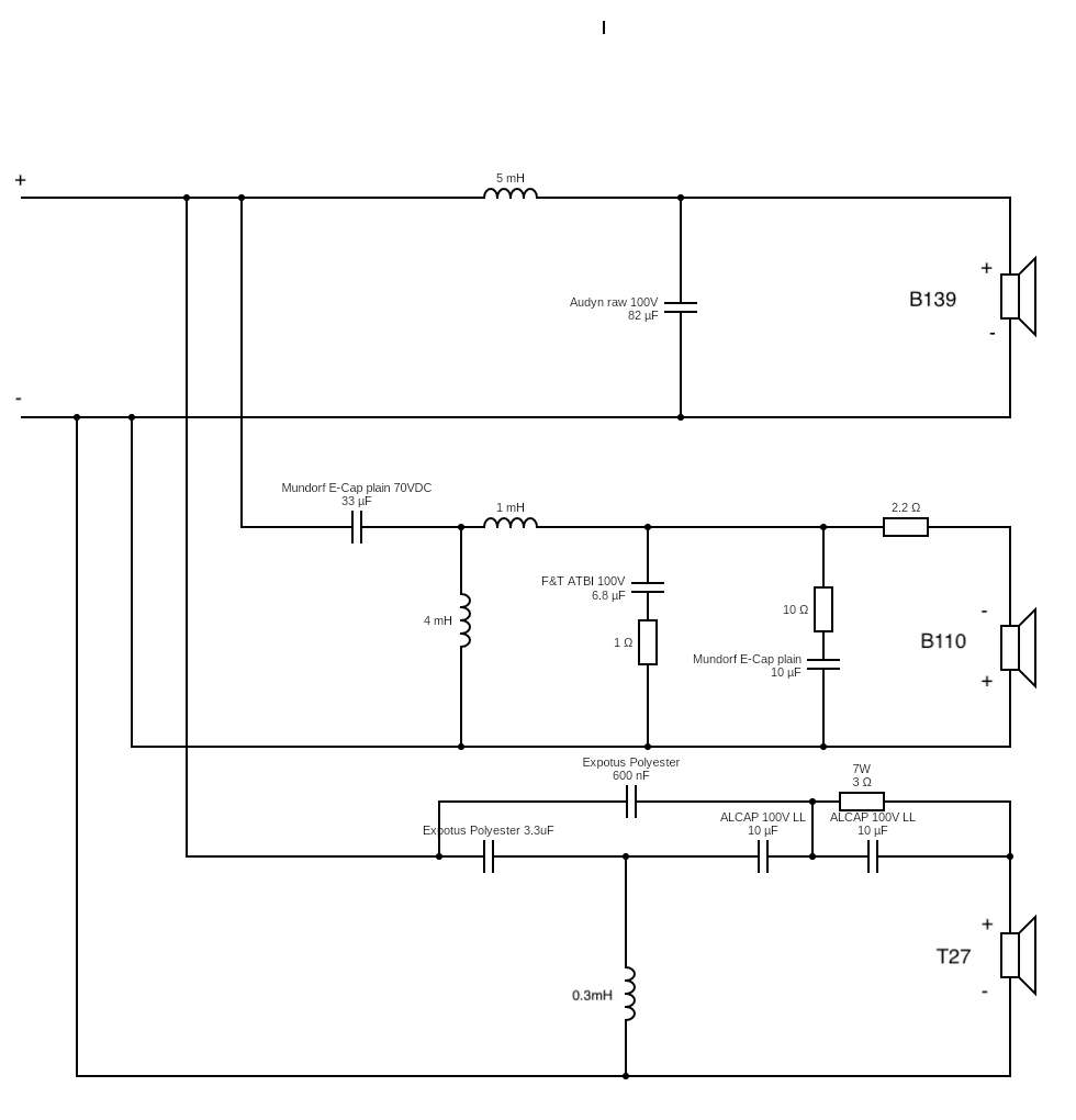

I have recently bought a pair from a kind gentleman who sent them to me their huge size notwithstanding. The original crossovers (schematics is somewhere on this site) were a bit tired sounding and gave too much mids for my taste. I researched the cornucopia of different filter networks for the combination of drivers which is huge (new “improved” Falcon and Wilmslow crossovers, old “improved” Falcon crossovers, the elusive Falcon “AusKEF” crossover (found only two blurry photos on the web, no circuit), Radford crossover, IMF crossover, Cambridge R50 crossover and more).

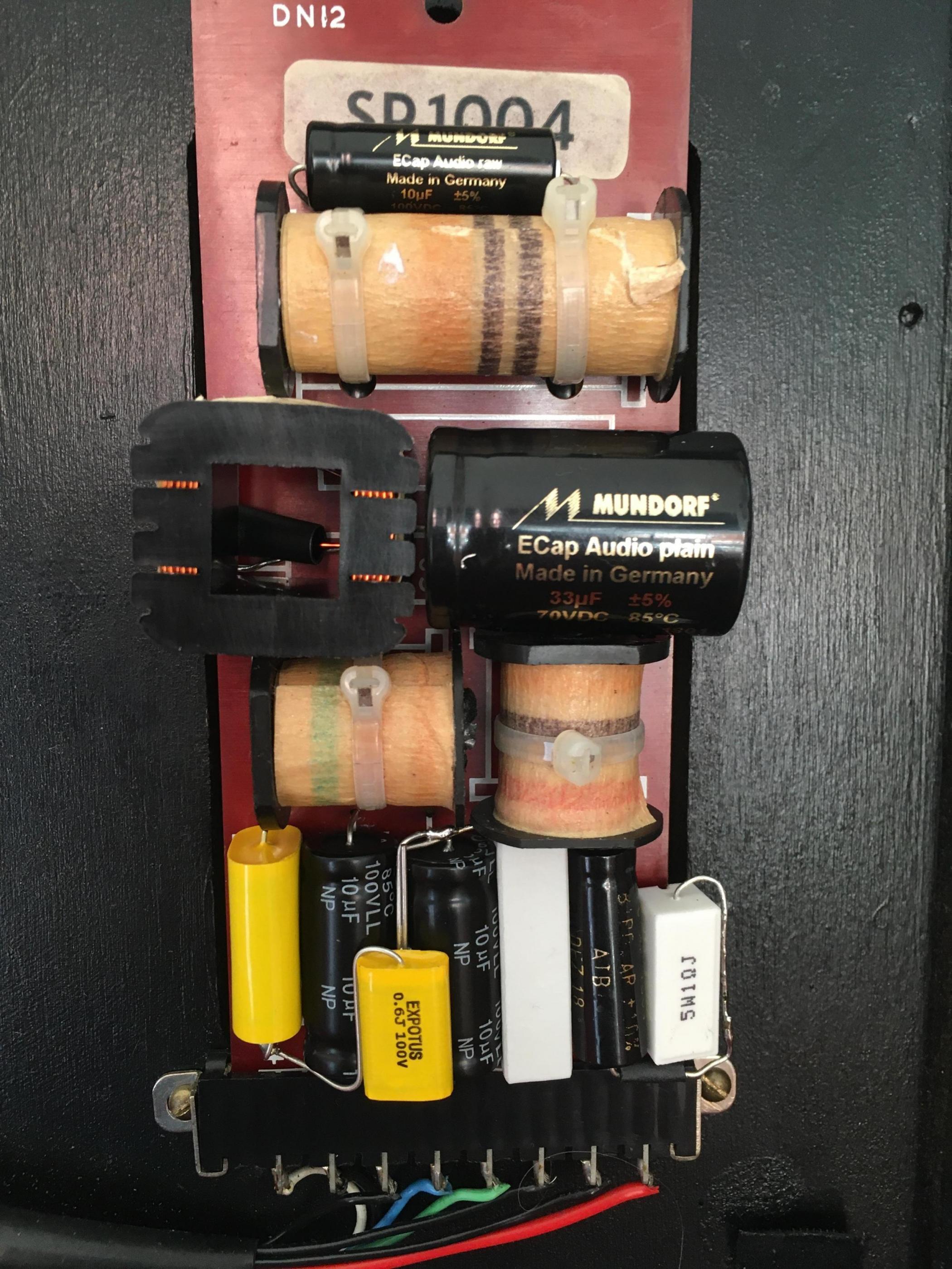

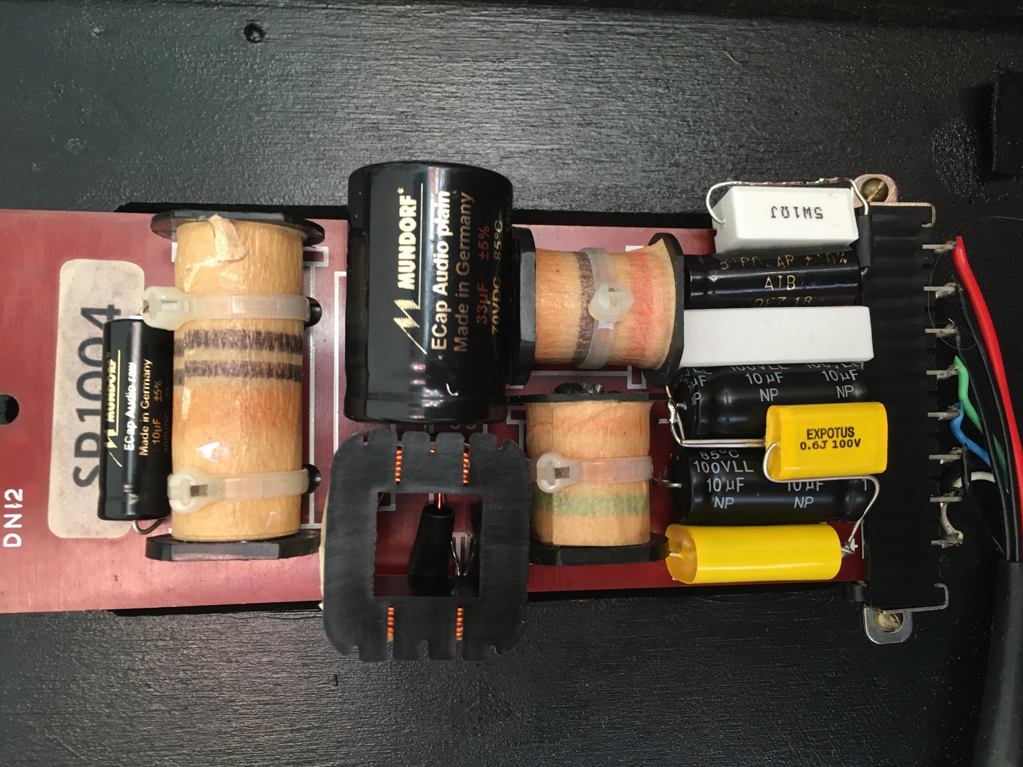

I did not want to spend much money on new crossovers and I wanted to keep the position of them on the front baffle – very handy for easy swapping of components. I did a lot of tests and finally settled for the circuit below. It incorporates the original aB circuit from the 104aB (not the “simplified” one which some of the Falcon crossovers use). The speakers sound fantastic now. I have a pair of KEF reference 105’s as a, well, reference. Strengths of the Concertos are a sweet, sweet midrange, a tuneful, deep and fast bass, and a treble that is never sharp. Imaging is very good (though not as spectacular as with the 105’s, but that would be hard to do).
I was even thinking of designing a circuit board to swap in the place of the old one, but I am short of time. I reused the original inductors apart from the one in the treble circuit, which needed a higher value. I turned the crossovers 180 degrees to accommodate the bigger components (there are also some elements on the solder side). I had to rotate the connector in order to do that. Now the Concertos are outstanding. They have this rare “rightness” about them. I tested them with my usual fleet of amps, among them a Kenwood KA-6000, Sansui TR-707, NAD 3140, Musical Fidelity B1, and Onix OA46 (all restored-recapped-upgraded).
See the circuit for the particular caps I used. The crossover is very sensitive of the type of cap. I tried various combinations (polyester, polypropylene, “raw” foil, “smooth” foil, aka LL, low loss). The caps in parallel to the drivers were – against some opinions I had found – MORE sensitive to the type and quality of the caps used there, particularly in the mid circuit. What is in the schematics now is what sounded most sensible after weeks of trials. I don’t have measurement equipment, but, as I said, the (serviced) served 105’s as a reference.
It was also VERY important to clean the connectors to the crossover, giving immediate audible results. I assume many reports of the Concertos performing sub-par have to do with dirty contacts here.

What you could try is insert a parallel resistor in the mids section of the 33Mc network. See my schematics. This parallel R did a lot of things in my Xover, and I loved it. (It would be fantastic, by the way, if at that occasion you could draw the schematics of the crossover and make it accessible to the community here :).
Adding the 1Ohm had effects less audible in the mids, but more in the bass. So maybe that's something to experiment with. Using a polypropylene (with low ESR) in parallel with the mid driver had the opposite effect – it really unbalanced the sound.

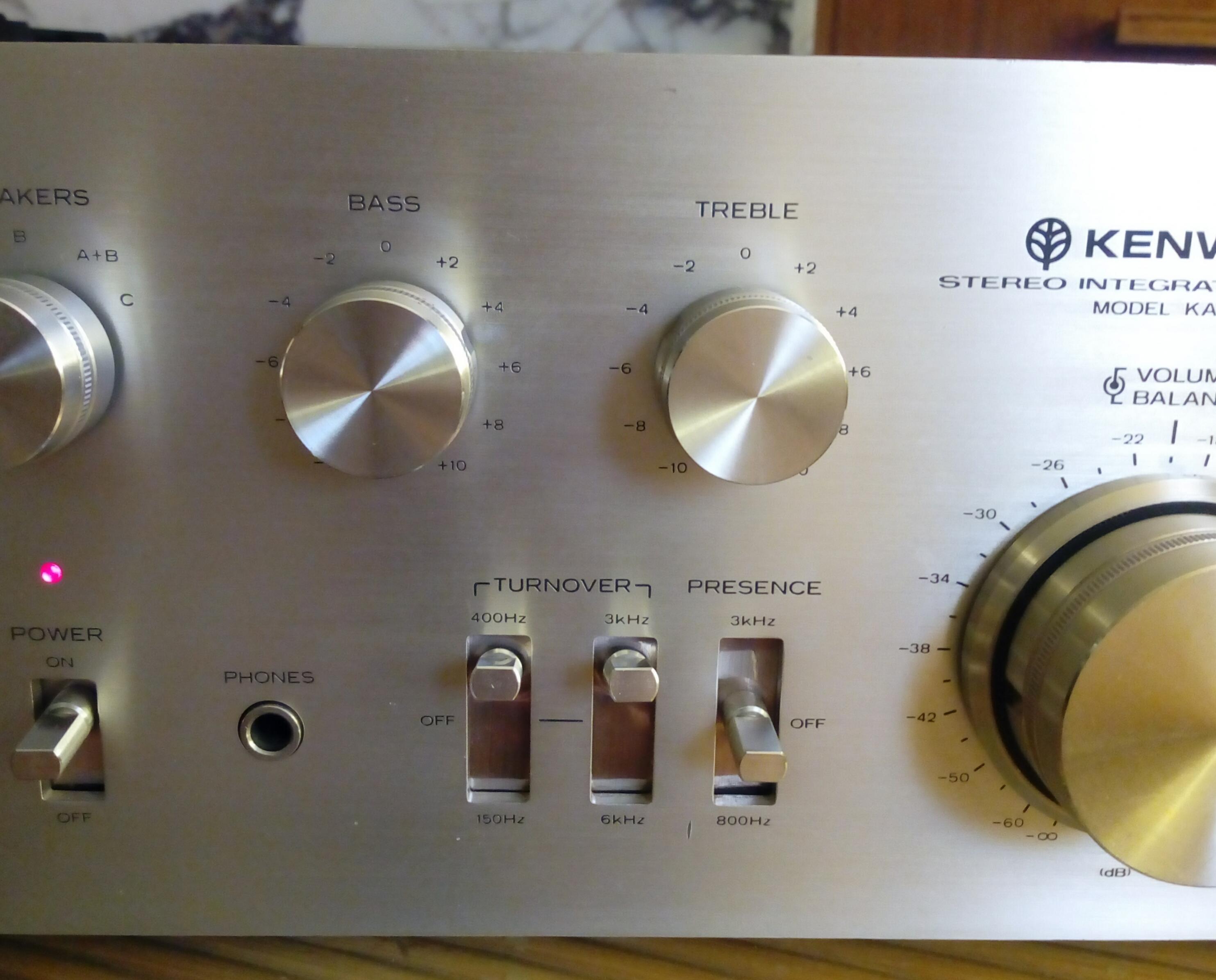

I'm listening them with a Kenwood KA7300 boosting bass two notches up at 400hz and cutting treble two notches at 3khz, this way it fills up the body/mids! Problem is they only sound right to me with an amp that allows that kind of tweaking so I thought about modifying crossovers, I posted here about it https://www.diyaudio.com/forums/analog-line-level/375737-modify-speakers-passive-crossovers-mimic-external-eq-curve-2.html
I looked at your equalizer setting with which you attempted to undo the supposed frequency bending of the Concertos. There it's more in the mids region and not in the upper bass, true. I wonder if the air core inductor indeed is part of the tweeter section, or if it is not in the mid section, in order to give a steeper separation between mids and bass or tweeter. see edit in the previous post. So i would be really helpful if you could trace the circuit... then someone here could even simulate it.
As the with the original Xovers the speakers sounded to "middly", in my version I attenuated the mids by a 2.2Ohms resistor, instead of making the separation of a different order, and thus stronger, by introducing another inductor. The "middy-ness" of the Concertos has been discussed in the KEF vintage forum (Home Page hifiloudspeakers.info).
If you want to try out my Xover version: all the components fit on the original plug-in boards, although you'd need to rotate the boards and the plugs (easy) so that the components face outward. Some later Concertos already had the Xovers fitted that way. You can re-use all inductors from the original board and need to add one extra for the aB circuit.

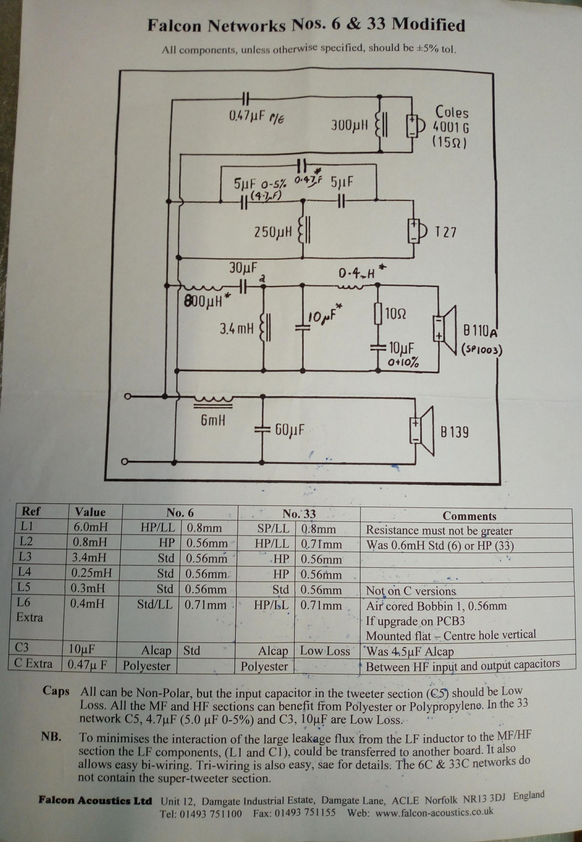

Some more thoughts. I tried to reconstruct the schematics.

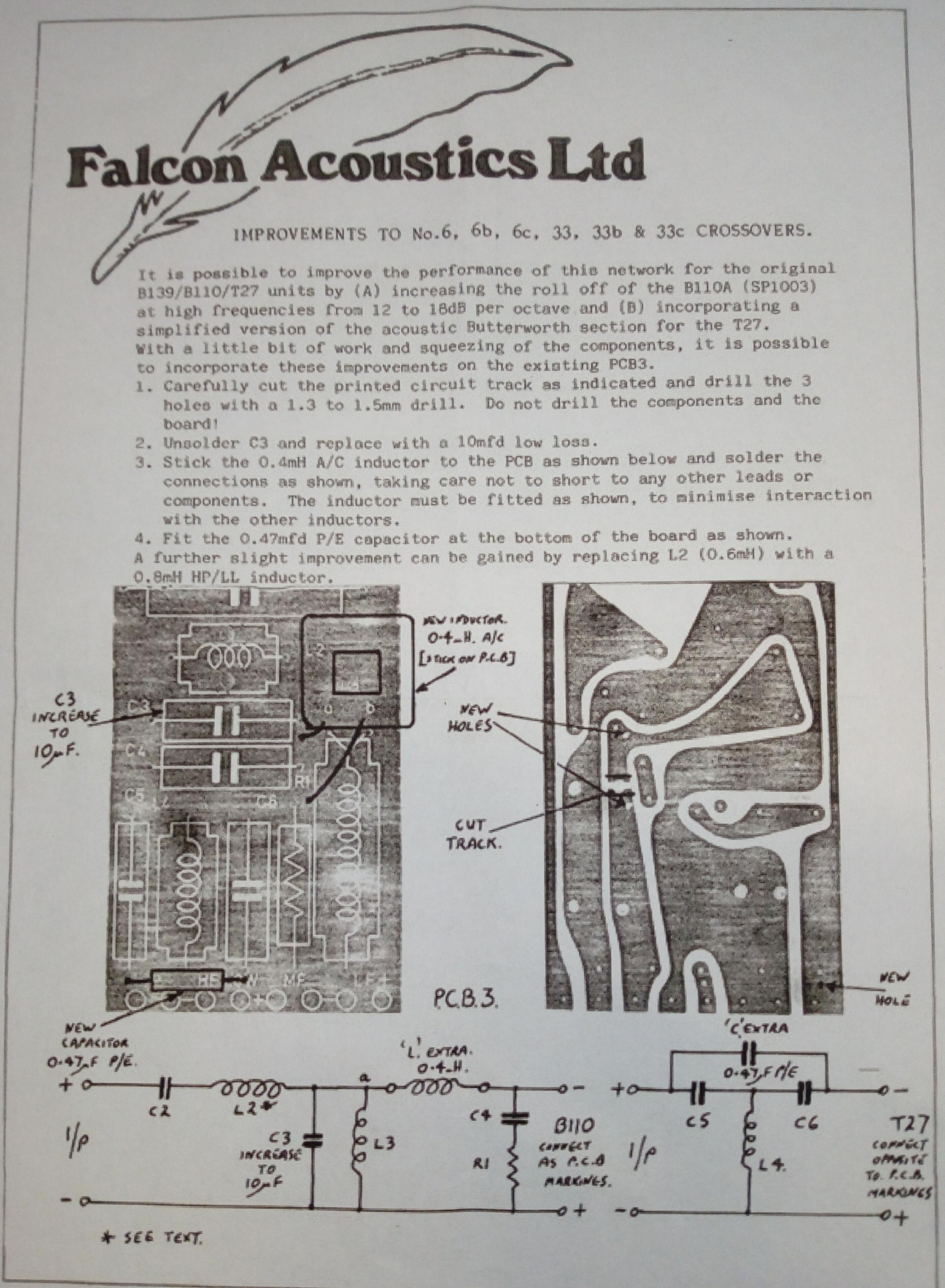

Falcon uses a 60uF in the bass section, which to my ears does not sound right, as it gives a mid bass hump. Then they added (if I'm right) a third inductor in the mid section, like KEF did with its last iteration with the B139-B110-three way design, the CS7 (which uses the B110B and the T33A tweeter, so it is not sure if one could directly "translate" the mid and treble section of the Xover to the B110A and T27 combination, probably not.)
See the CS7 network for reference. Falcon might have overdone the low-mid pulldown with their version. Falcon also uses their "simplified" aB network, which to my eyes is just that, (too) simplified. See again the CS7 with the complex aB network.
