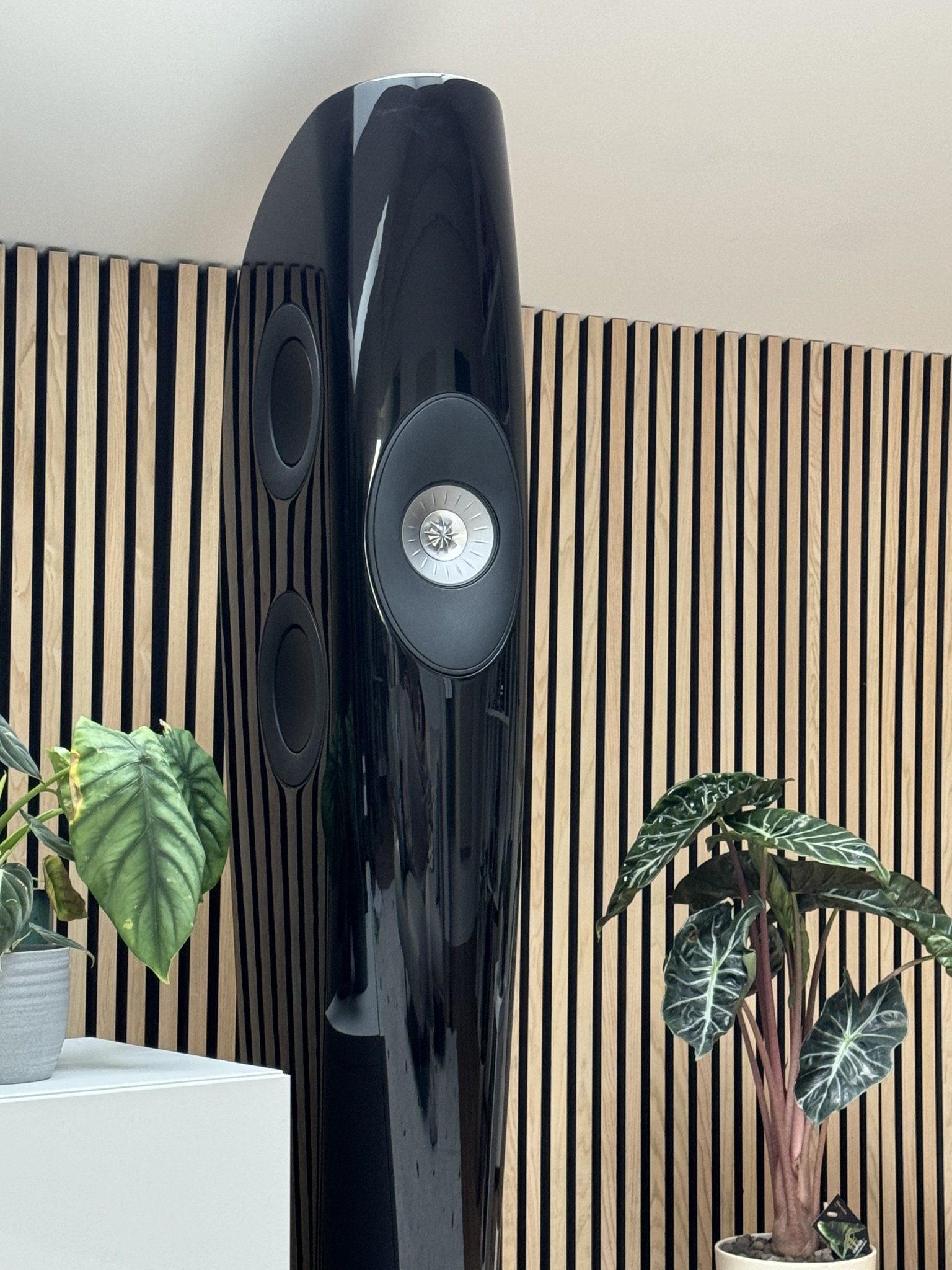

Love mine. Best speaker i have ever had. The cleanest coaxial i have ever heard
Both are different compromises IMHO.
The Reference 5 could do with large roundovers.
The Blade 2 Meta could do with a lower crossover point, but the cone area of that UniQ MF means that it can’t reach down low enough to do a 120-150Hz crossover.
No doubt that is an amazing cabinet beyond most DIYers. IMHO it looks like Alien technology that came to Jack in a dream (or BEM/FEM).
