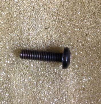

Fixation screws for Kef B139 woofer.
Hello. I know this probably isn't the correct thread to ask a(nother) question about the Kef B139 , sorry about this...
Problem is , I seem to be missing a pair of screws (2)to attach the B139.
So the B139 is now fixed with only 2 screws instead of 4..
How is this possible? Don't aks me please ... Ik don't know. I bought the Kef Concentro's back in 1973... Recently I replaced the T27's , and at that moment I saw 2 screws were missing from the B139...
The passed days I searched the internet to find this screws, but no luck.
The screws are about 2cm long. It seems to be the same screw , used to atach te crossover-filter. Ik have looked closely to the screw, and the only thing I know is the screw (or rather bolt) has withworth (but which exact type of withworth??) thread , and is about 5mm diameter...and 2cm's lenght.
Can anyone of you give me the exact specifications of this screw/bolt please ? (see example)
And perhaps also were I could buy two of this bolts.
Thank you very much.
Eric
