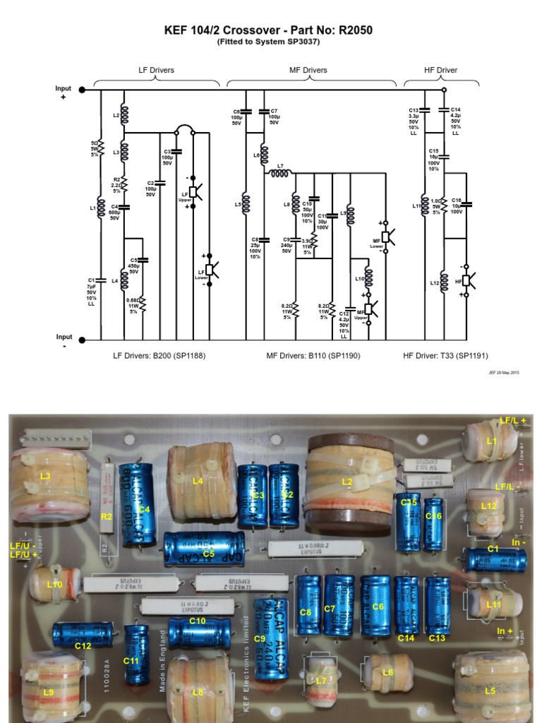

Hi - just wondering if there are any quick opinions on replacing caps on a pair of old Kef 104/2's.
options;
1; a dedicated cap set for 104/2 from falcon acoustics - all alcap electrolytic 'cept one of the tweeter parallel signal path caps (C.13) with polystyrene.
KEF 104/2 Replacement Capacitor Set
2; budget improvement(?) - replace mainly with alcaps though replace tweeter caps with budget MKP, and perhaps mundorf e-cap for signal path 100uf's (C6,7) on mid - or even Chinese 'Audiophiler' if space (will investigate) - these seem to have a reasonable write -up at humble home made hifi. Humble Homemade Hifi - Cap Test
The budget is low... just after a quick opinion if that is possible - please don't do to any trouble if this question is more complex than I think! - thoughts very much appreciated though.

The one issue I can think of is the ESR of those old caps. They tended to be relatively high, while MKP are lower. Look at that before doing any major overhaul.
Yes, deal with any mechanical issues first. I like to use the Mundorf MKP's, cheap, detailed, if dark. Break in for 48 hours at least.
Thanks - yes the donuts and ferro are a given, and thanks for mundorf mkp view.
With the ESR (good point thank you) I am thinking this will probably only have a noticeable impact on the higher values(?) - the 2x100u high pass caps on mid (other high values I will alcap). So only one point of attenuation needed if problematic. the flip side being that potential gains at this point are likely to be very worthwhile?

Thanks for everyone's input. In the spirit of sharing my findings;
Given my friend wants to keep these 'forever' I changed all the caps - some of which were showing signs of slight swelling..
Donuts and ferro done. grommets replaced. 13+14 Janzen crosscap 7.5uf. 15,16, 8, Janzen MKP, 6&7 mundorf plain ecap, all others alcap.
significant overall improvements reported, particularly detail and clarity in mid, extension and clarity in treble, all without detriment to character of the speaker. total cost inc. delivery charges just under £200. Given you can get a set of these for £3-400, surely this makes for a bargain proposition for budget high-end...?
I can confirm using larger values as direct replacements, MKP's elsewhere, mundorf Ecap electro for 100uf mid (should have by-passed) is a significant improvement particularly in midrange detail and clarity. whether the response curve is less accurate is secondary to the fact classical acoustic instruments have much more realism due to the textural detail (e.g. being able to clearly hear harmonics in church organ tone.)

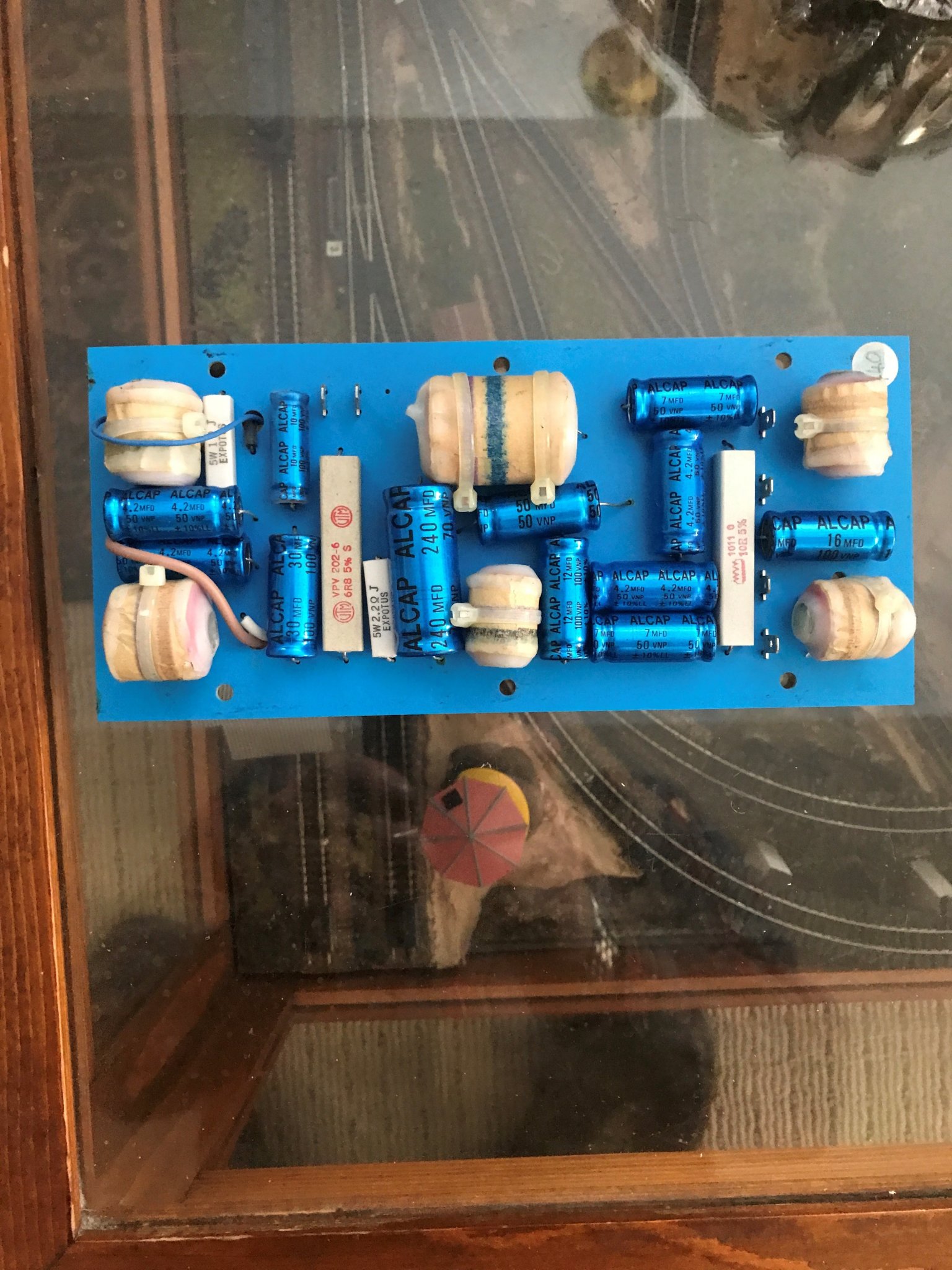

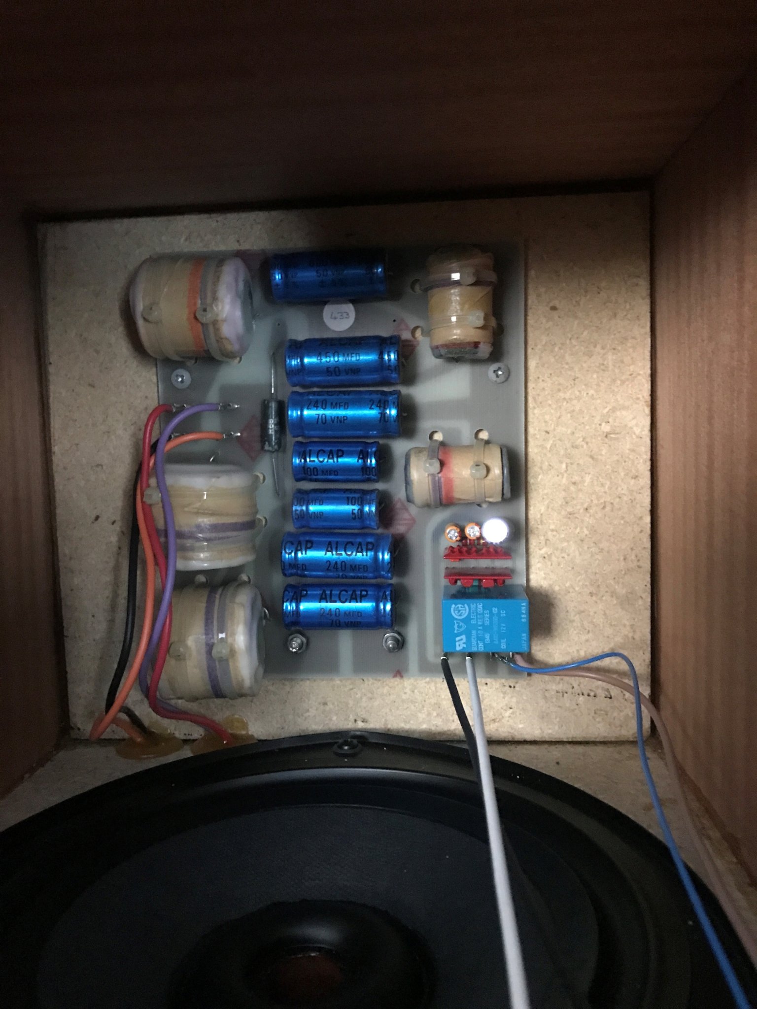

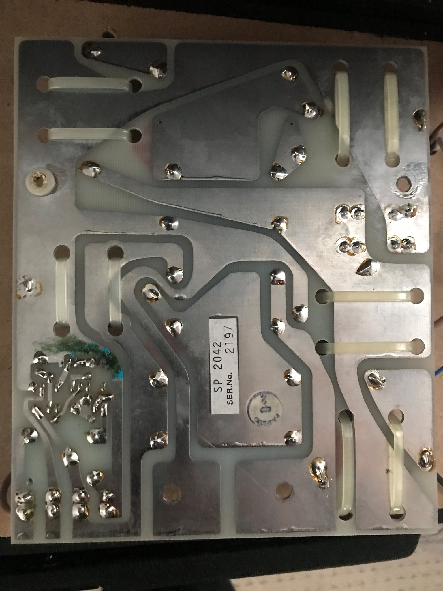

I have almost zero output from my one channel. These speakers were working fine up until that morning I went to play Handel's Messiah. I checked all of the speaker cones and they are good. I took out the crossover board from behind the mid range and tweeter and then found another board at the back of the speaker cabinet at the inputs. There was corrosion on a trace on the board. This was resulting in 2000 ohms resistance on a pcb trace! I cleaned the corrosion and soldered a 1/16 piece of solid copper wire over the bad area. Also had to grab the leg of one of the very small caps that work in conjunction with the mid/tweeter cutout relay that is for safety reasons. It senses with the tweeter has been over voltage and it cuts out the signal to the mid/tweeter crossover board. My problem is I can't get the input board to work with the woofers. I have hooked up the woofers to another stereo and they work fine. Hook them up to the incoming board without the mid/tweeter board or speakers attached and the woofers are severely muddled. Any ideans? Try to find the schematic for this incoming board is a joke. I finally drew out my own....

The pair I did had the one board - as all the utube and other guides suggest too? - Was your speaker modded? - or maybe a very early example??
