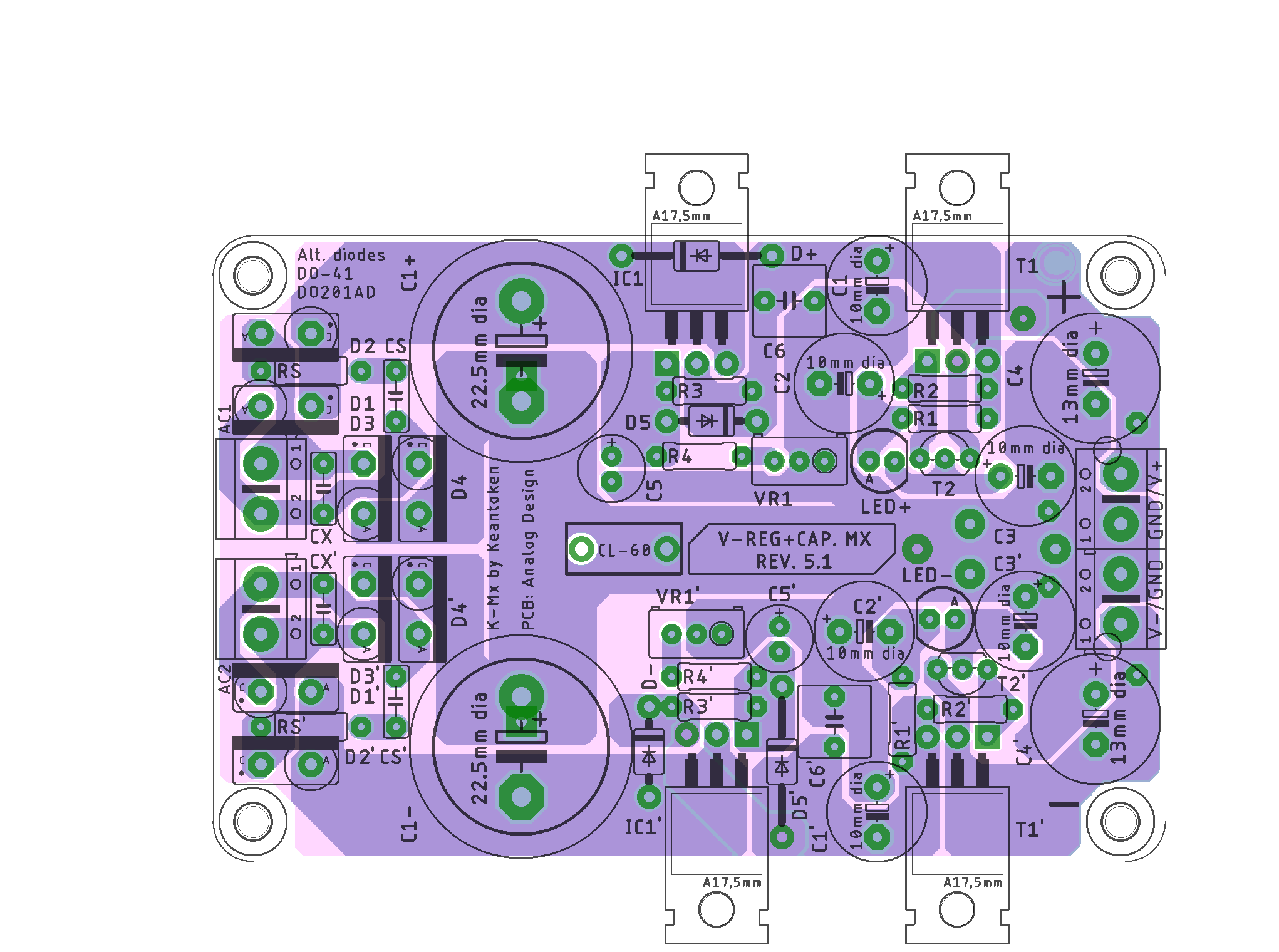

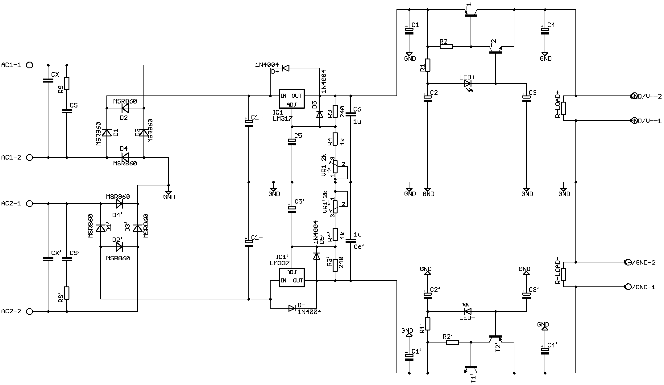

Hello keantoken,
I built up your k-mult according to attached circuit.
input AC is 15~16 VAC,, rectified to 22 VDC. follwed by lm317 , which is adjusted to 17 VDC output.
The k-mult further drops it down to 14.8VDC.
The led flashes and switches off at power-on. ( i could only see a faint single point glow of led, if i really see closely).
As soon as i connect a 1k load resistor ( about 16mA), the led switches on.
otherwise every component is ok ( resistors).
I have used bc327 / 337 and MJE15032/33 pair.

Try a higher load. IIRC I gave the output current range as 25mA minimum. For lower currents it doesn't always behave as expected.
Also, the capacitor ground connections should be in the same order as your schematic from left to right. Mixing them up can cause problems.
thanks keen,
tried with a 500 ohm load, still same thing. grounding arrangement can be seen in the below image.
clean ground (317/337 and CMX share a common ground point near the leds.
rectifier and bulk caps are far upstream.
I will try replacing the 337/327 and see..
my load demand is quite low, ESP HPA. In that case will mje15033/32 pair be ok?
That layout looks okay. I notice I didn't recommend the 15033/32 for the Kmultipliers. That is likely because I didn't have any to test, or if I did, they were not stable.
I would suggest finding a way to load the kmultipliers over 25mA, or switching to D44/45H11G. You can also try switching to BC5xxC for the TO92s, that has also worked before.
Just to make sure it is not another problem, please give me the voltage at each transistor pin.
