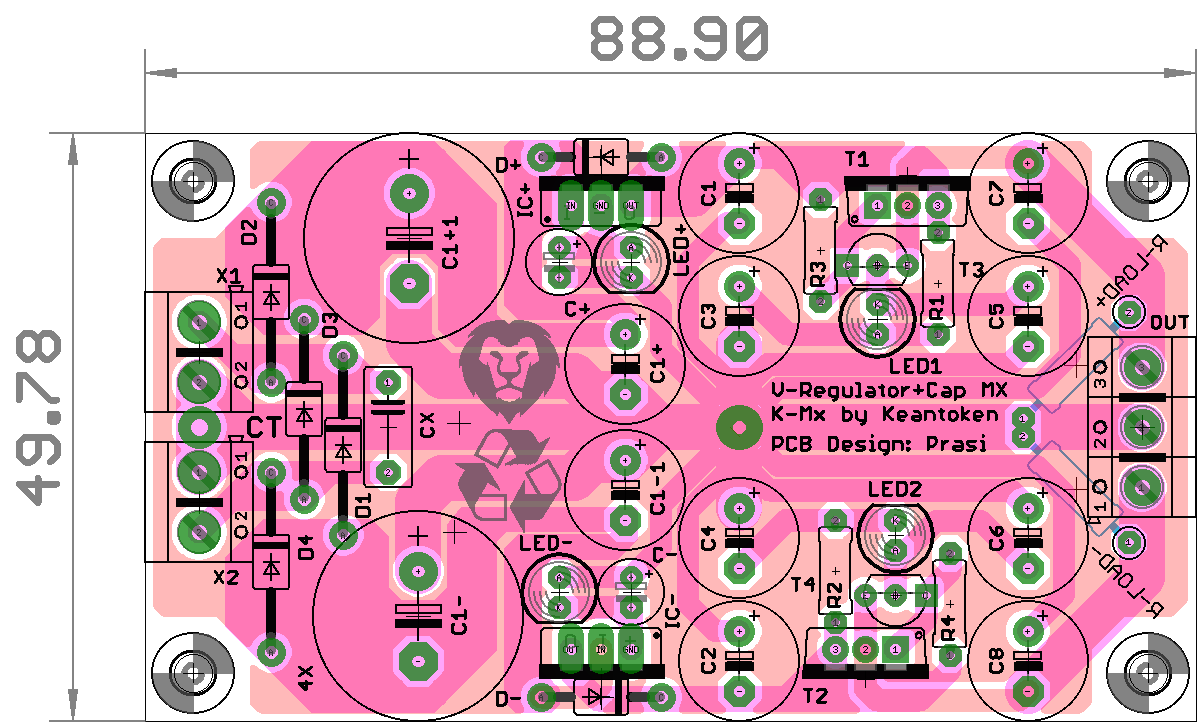

Good catch. The input C grounds form a big transmission loop for rectifier pulses. The ground plane would not help with audio frequency rectifier harmonics. Trafo CT should be joined at the terminal blocks and then go to star ground.
thanks Andrew /Keantoken,
Yes, it was the sch. that mislead. Its should be similar to the LM317/337 that I did a while ago.
I am getting some boards made for myself and for anyone who is interested, if I may have Keantoken's permission.

That layout is wrong.
The Centre tap (CT) goes to the junction between the first two smoothing capacitors.
I think I need my sleep. doing two layouts (this PSU on one side and a 500W subwoofer amp on the other ) simultaneously I seem to be making lot of errors.
forgot C1+ existed😱.
Oh, got it. The names c1+ and c1+1 although location is correct on sch , are exchanged on the layout on the positive rail.

Prasi,
your schematic is going to mislead you into making connections in the wrong places.
The centre tap of the transformer must connect to the junction between C1+ and C1-

both Prasi and KeanT acknowledged that the schematic is misleading. In that first post I described that the CT must go to the first smoothing capacitors (named C1+ & C1-). KeanT then goes on to describe the problems as aerial loops emitting EMI.

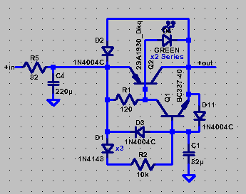

Try this.
Can't get 2SA1930 or TTA004B could you give an alternative?
TIA
Felipe
Try the 2SC4883A/A1859A if you can get them. If not see if you can find other 1A+ transistors to try, and verify performance by measuring input and output ripple.
In your version the voltage drop from emitter to collector of Q2 should be about the same, around 1.8V. Maybe a bit more. Voltage drop added by R5 is determined by load current. IE 10mA*82R=0.82V.
