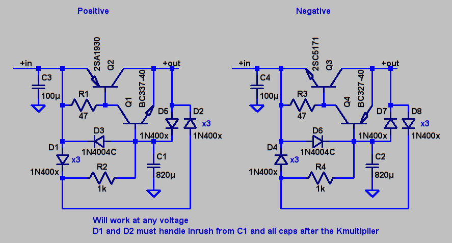

Im trying to use Kmult in Salas Riaa, but im having some troubles. Input is at 47.5volts, output is 43volts. I read in your guide that output voltage is limited by Q1 Vce. Both BC337 and BC550c have max Vceo 45volts. Does that mean that Q1 is damaged? If so, is there a higher Vceo alternative transistor to use ?
Usually the max input voltage is higher, but it depends on the charge time of the preceeding reservoirs. I don't think 47V should be a problem. The BC5x6C would be safe for higher voltages, but not as good for filtering.
Since your output voltage is far below your input, most likely your transistors are still functional. Usually when this happens something is causing Q1's Ib to be very large. In this case, 3.3mA.

I have a new design that works with voltages above 45V, but I haven't gotten around to updating the site. I'm sort of embarrassed I didn't do this earlier.
For tube amps you probably want a different version, but this one will work for 100V power amp rails as an example, if you are careful not to blow the 1N400x with inrush. This version would be great for a workbench. Are there better diodes than the 1N400x that don't have higher capacitance, and are not less available than the transistors in this circuit?
It also might not have as pleasant turn-on, since the diodes short it until the inrush is over. So it's not necessary for circuits under 45V.
