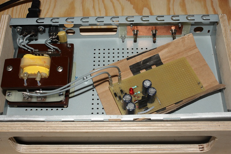

Keantoken's CFP cap multiplier
Cool build 🙂
thanks 🙂
got power on now
and I guess it works, since I have +15V from a 12V trafo
but no light from the LED 😱

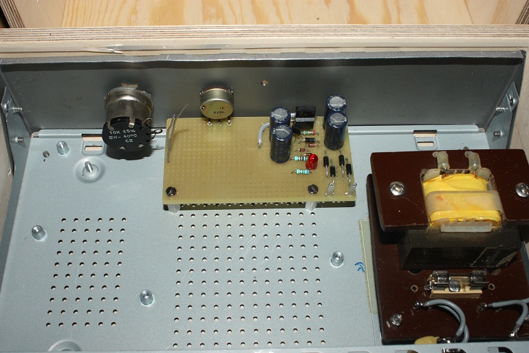

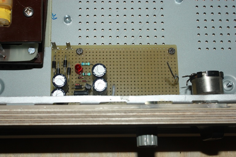

got it, thanks...it works
tricky, because those caps must be some kind of small wonders, since they seem to hold voltage almost indefinately
drained the caps with a reisistor....and he LED flashes nicely on power up 😎
thought I wouldn't need a LED/res supply drain/bleeder, because of the LED in curcuit, but seems I have to mount one
will use for powr on indicator on front panel

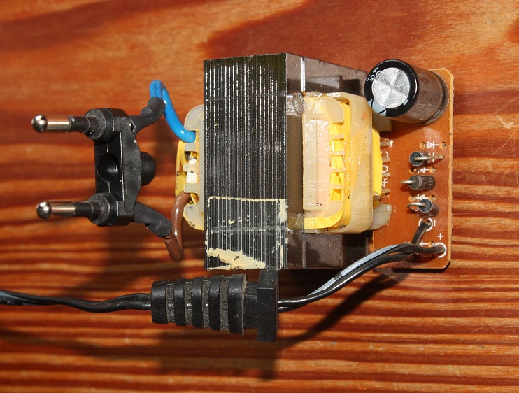

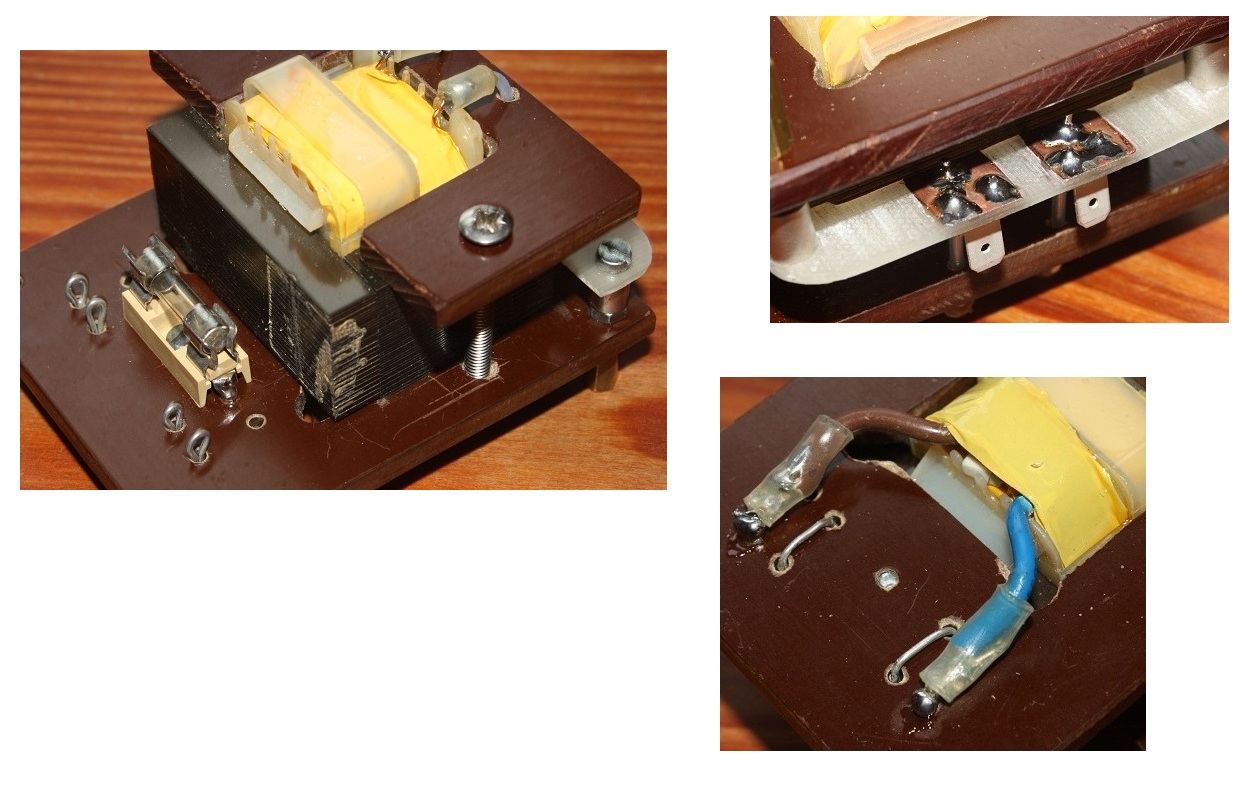

BTW, that's a super-stylish trafo there. 🙂
ripped from a wallmount supply 😀

Neat! You turn it into gold. Is that wood? At first I thought it may be something nifty and esoteric but now I realize it's just to hold the trafo in place? For the top part it looks like you drilled holes and cut it out with a band saw? I need to learn this sort of resourcefulness.

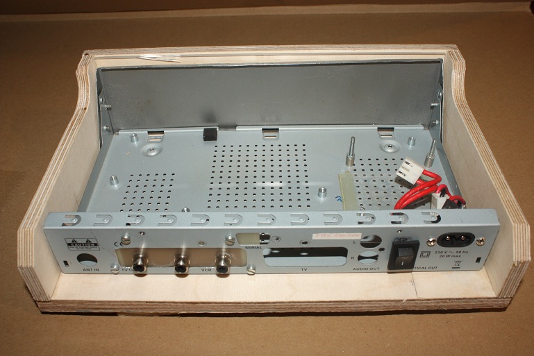

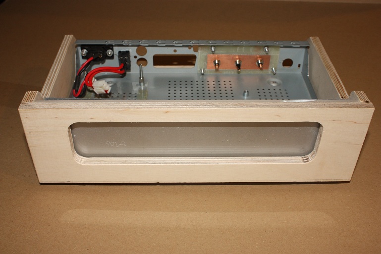

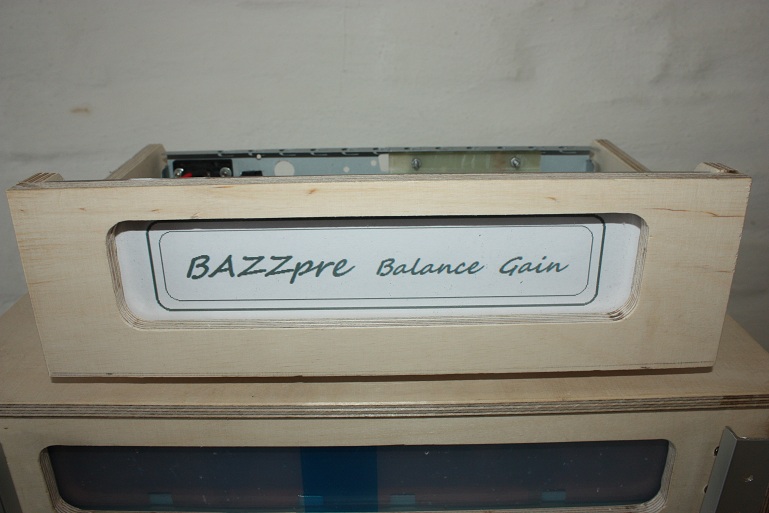

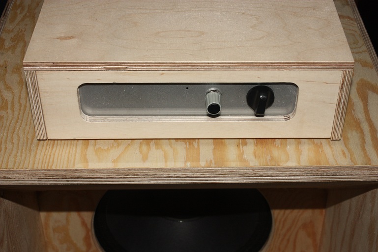

Is that wood?
hey, I suppose you mean the brown trafo 'chassis' ? ... I think it's Pertinax
its hard pressed paper/glue, and very strong
I just cut with an ordinary metal handsaw, and dress with a file
edges are difficult, and splinter easily...could be better
the rest of the box is scrapped digital 'something', modified a bit, and some plywood
it's really way too much work for what it is, but whatever, its great fun 😛
