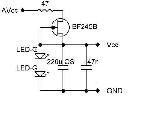

Bill, there's a very simple circuit which you'll be amazed by what a difference it can make. The resistor values will have to be changed to your liking. This is not a regulator.

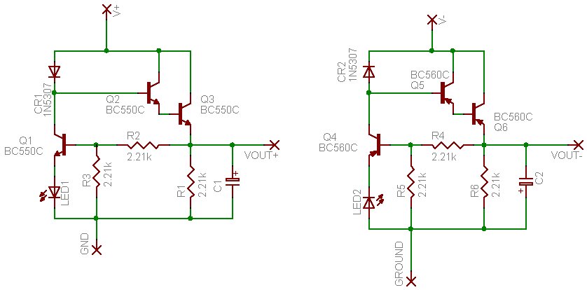

some more options
attachment.php
another one, Vout can be adjusted
attachment.php
or HERE , everything on left side from C12 can be omitted
or mini shunt (more LEDs=higher Vout)
attachment.php

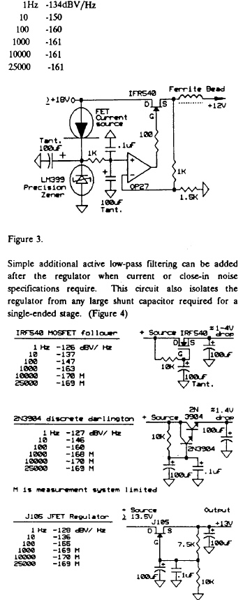

if you want shunt reg and don't want to dissipate heat, you can use clever idea from Wenzel Finesse Voltage regulator to build your own clean-up shunt reg: FINESSE REG.
Or Maxim's design idea: NOISE CANCELATION
all above regs are from different authors, pick up your poison 😀
But be aware, with high output Z regulators, big capacitance with low-ESR, ESR can dominate over regulator into audio band. Capacitor sound 😛

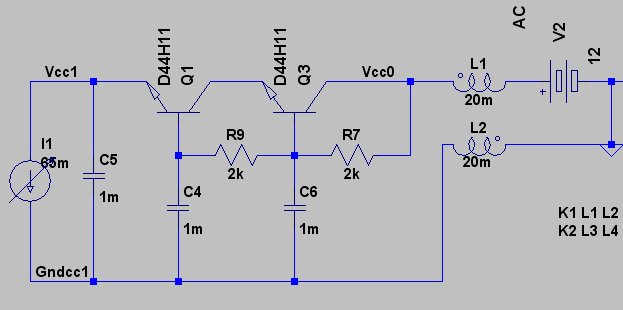

For now, it seems it is worthwhile to build a C-multiplier and put it in front of the Marantz reg and see how it sounds. I happen to have a pair of D44H and D45H in my part pin.

Anyway, given that the Marantz has such large capacitance in the load on board I guess higher impedance may be OK. I would add the Gyrator before the Marantz series regulator, in contrast to what TeddyPardon does to the output of the regulator.

Bill, it's a simple circuit which you can do without a pcb, to test. If not good enough, chuck it and go to the next level. Or if you have doubts, definitely try something else.
Filter before the regulator, and then measure at the load. But remember to measure with very short ground lead on the scope probe.

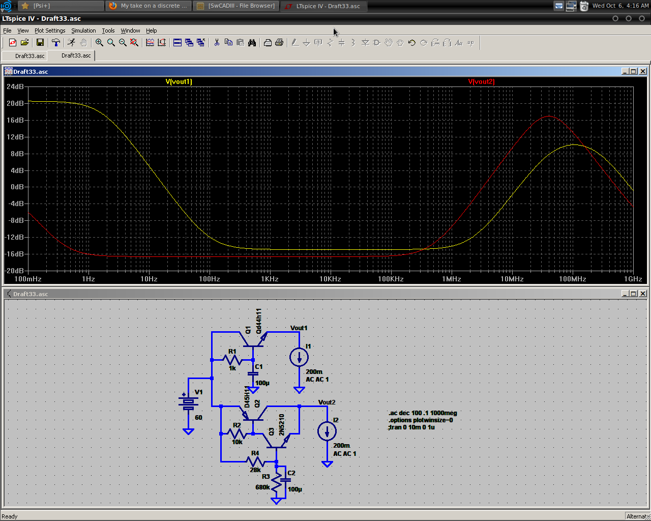

Even the C-multiplier can be improved upon with a few components. In this case the output impedance is decreased, and bass response increases by a very large margin. Using a complimentary Darlington/CFP arrangement, the drive needed at the input is very small, in which case we can increase the bias resistors, increasing the RC time constant.
Using the CFP improves output impedance. It may improve HF impedance as well but it depends on the slave transistor, and the PNP version of the D44H11 has worse HF specs I believe which is why HF impedance is worse in this case. In this case you could probably avoid clunky low-voltage amp type devices and use old CRT flyback BJT's (cut out of monitors/TV's) which are fast with low Cob even if they have lower gain, and should be bulky enough for your application.
There is stigma surrounding the CFP because of its reputation for oscillating in amplifiers. I don't expect a big ordeal, but I haven't seen many do this so I can't be sure. The first thing I would try would be a base stopper on the power transistor.
