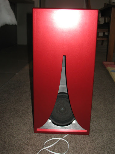

Barely hanging on (to life 😉 ) it is heartwarming to have one of my creations being refered to. The HAK 6.5 is my favourite "small Karlson" and the "Dutch" 12" Karlson is my favourite large Karlson. I turn these on when I want to play Uriah Heap, Led Zeppelin etc. I like the K12 mounted upside down against the ceiling with a small gap above them and the HAK 6.5 sitting on a small stand, about 8" off the floor.

Hi there,
Hope you're doing alright! Here is a picture of said HAK6.5, if that's OK with you. It deserves to be seen! 🙂
It's the only one I have and not sure what happened to the rest, since the K-forum went down.
