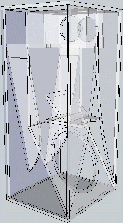

I was thinking of a couple of 6.5" el166's aligned vertically in a k15 since I have a few. Just mulling possibilities. Got no time right now except to make the occasional screwy post.
What driver parameters should you look for? Ever tried two small woofs in one box? Might be a fun box to try in a fast.
IIRC it was in the subwoofer forum that a guy built some rough K's and stuck 4 small woofer in it, 2x2 config, maybe a year ago.
IG
I don´t like the idea of use two speakers, like a drawing here. There may be some interference between the two signals, producing peaks and valleys very difficult to cure. Karlson itself told not to add none modification to his design, and I agree such way of thinking.
I prefer the idea of sticking to one bass driver as well. Seems like Karlson must have been happy with the K15 design, as it stayed pretty much the same, maybe except for a port board modification at some point (?). K12 went through many iterations and he might not have been "done" with that one. In between, X15 also saw some changes AFAIK.

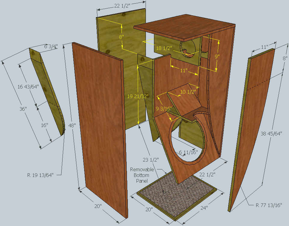

fwiw I liked 18" "ok" in Karlson - my first driver was an Eminence with lower mass (103g mms) and lower qts than the Sigma. 18's in the 130 gram region were more mellow and lost some midrange. One thing I remember is the improved subjective quality in the mids when moving a 130 gram 18" Eminence from a bass reflex to a Karlson. For whatever reasons the indirect radiator sounded much better than the cardboardy tone of the same driver in a 6 cubic foot quasi RJ vented reflex (there was no substantial blocking of the driver but the box had RJ dual vents. An EVM18B with only 80 grams moving mass works well in a taller K18.
22"x16"x~42"
22"x16"x~42"
here's a driver I have to revisit - although not fullrange, Beyma's 12cx was more extended than Eminence's older 10&12cx - its sat in this K12 for 6 years but not been run yet - qts is higher than spec but its extension is an important element not seen in simple T-S data. That is a factory Karlson 12.

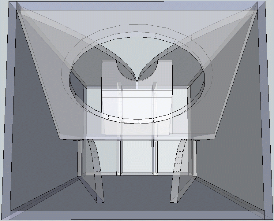

This would likely be my next K18 (if I ever get around to it...)
All about loading for bass, strengthening the back and wings.
Little attempt to optimize upper chamber's high order modes.
I got a much different design for that sort of thing...

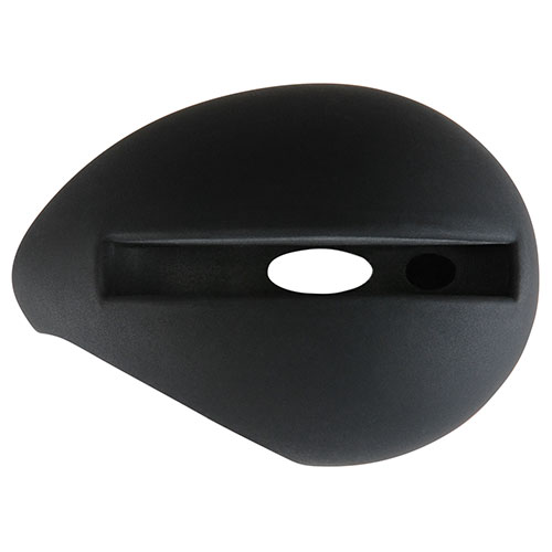

nice collection. here's mine
Sound EGG Audio Booster and Stand for iPhone 5 Black Color 520-204
Figure 6 Koupler for iphone?
OK, the hole (on the flat side) is round, shoot me...
This appears to be a top view.
