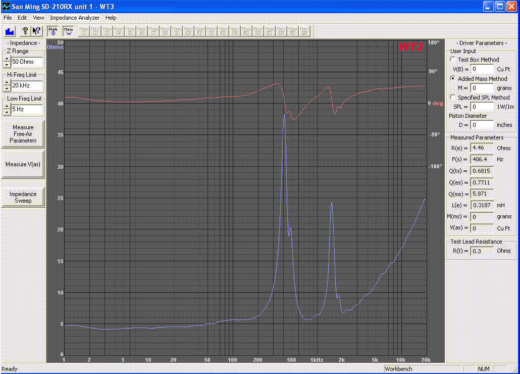

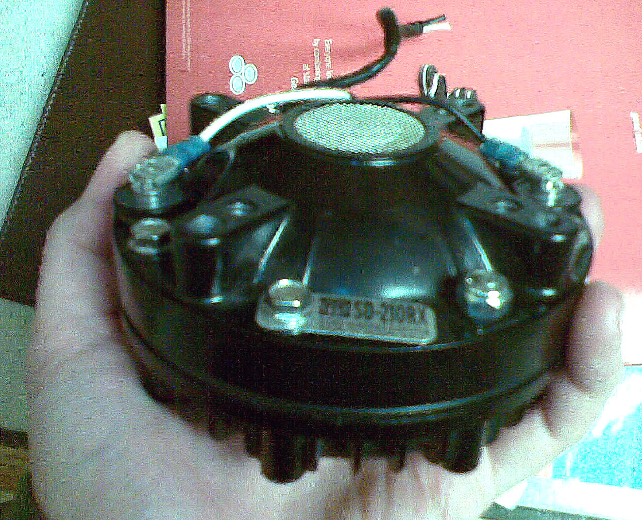

I just took delivery of an interesting pair of midrange compression drivers that I'll add to the mix for testing on K-tubes. They are San Ming SD-210RX drivers (X indicates throatless), intended for use in sirens and paging horns. Their magnets are good-size slugs of neodymium, and they have phenolic diaphragms. I can't find a spec for voice coil diameter, but it's likely somewhere between 2.6" and 2.75".
WT3 shows a free-air Fs of ~400Hz. A plane-wave tube measurement of this model appears in promotional material for the Plus-One Engineering SD4370 (another driver I'd like to test). It is the blue curve.
Judging by appearances, these siren drivers and others like them (including old Klipsch midranges) are direct decedents of the venerable Western Electric 555, sharing the same magnet-behind-diaphragm architecture and single-slit phase plugs.
I'm interested to see how these perform. I hope to commence testing within a month, after a big push at work followed by a vacation cruise. 🙂

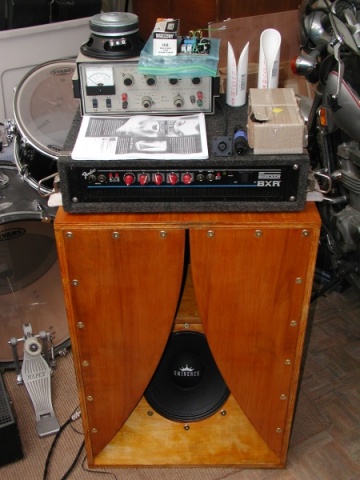

if you look carefully under the picture above you'll see a link - that's not my toy. I have rear loaded smaller pipes and also front loaded - like Silvercore featured with a Lowther -K-coupler on top of a La Scala clone.
here's a de-whizzered FE164 in a rear load - there was no damping material in the tube.
its probably good to investigate Karlson's asymmetric projector- when using a coax, an extended K-tube (like Farber Acoustics) can be used to remove the HF from the chamber's influence.
re: Karlson's asymmetric projector (aka "klam") here's some notes posted to Job Ulfman's Karlson Speaker Forum from Lars Moseholm who took plots of spl out to 25 meters on an 8" klam which was manufactured by Alan Weiss
Alan's "Patio" speaker loaded with B20/BOFU which would typically mount on a tripod (also sold for house of worship)
