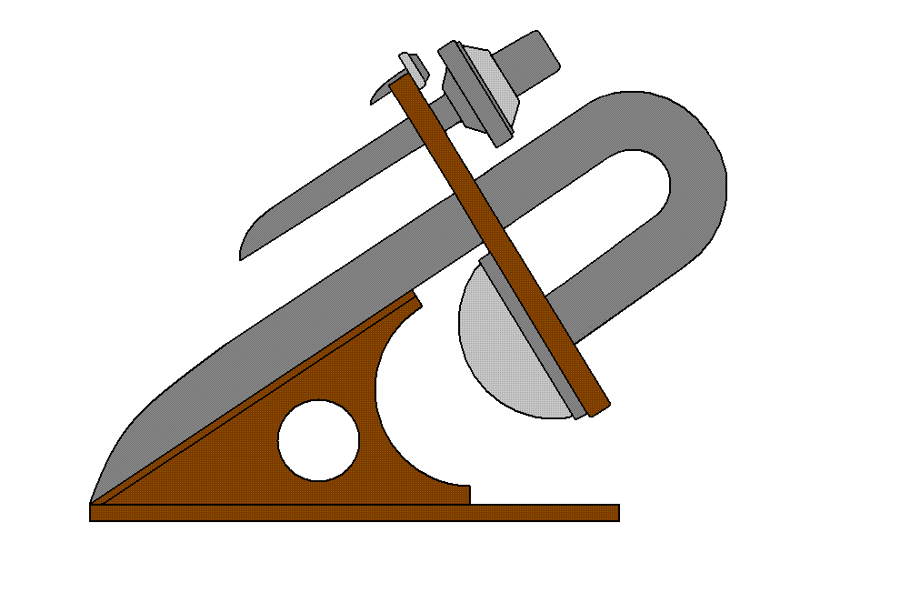

I am have alot of trouble finding out how to figure out the dimensions of these k-tube wave guides. Does anyone know exactly what the length and width should be for the given cutoff frequencies? I plan on using the k-tube above 900 hertz as I heard someone says that distortion increases below this threshold.

I make mine the exact same id as the driver exit and length is 1/4 wave of the comp driver Fs or first impedance peak which will be the same thing. I prefer a double cutaway tube Vs a single cutaway. So mine look kind of like a bishops cap. Best regards Moray James.

Make sure your driver's recommended Xo frequency is not higher than the crossover frequency you want to use. The tube should be at least long enough to be half-wave long at that frequency. 343m-s / 900Hz / 2 = 0.19m in your case. It's probably safer to de-rate the spec sheet power handling by a factor of 4 if not 8, but that should still be plenty of SPL for home use. Ultimately, measuring distortion and output and choosing the best usable point is ideal.
I can see how larger diameter tubes could run into problems up high in frequency, but 1" is a good spot IMO and avoids possibly awkward transitions. Opinion and data is not definitive on that, but a ~1"-2" un-slotted section at the base may slightly increase power handling and lower distortion, but can introduce a dip above 1kHz.
I mostly used the Transylvania Tube, 1" I.D. and 5.3" long, no un-slotted "stub" base section, pictured above on an angled module. Distortion rising at ~900Hz corresponds to sqrt(2)*¼-wavelength of 5.3", maybe only a coincidence. ½-wavelength is ~1275Hz and I mostly used it around 1500Hz myself. The BMS 4550 did have usable output down to ~800Hz IIRC, with rising distortion though.
I'm now used to CD-waveguides mostly, but also listened to a DIY petal 700Hz tractrix I made a while ago. I have not done A/B comparison very much, but all of these have something going for them IMO. A PVC K-tube is probably one of the easiest and fastest WG anyone can kludge at home.
