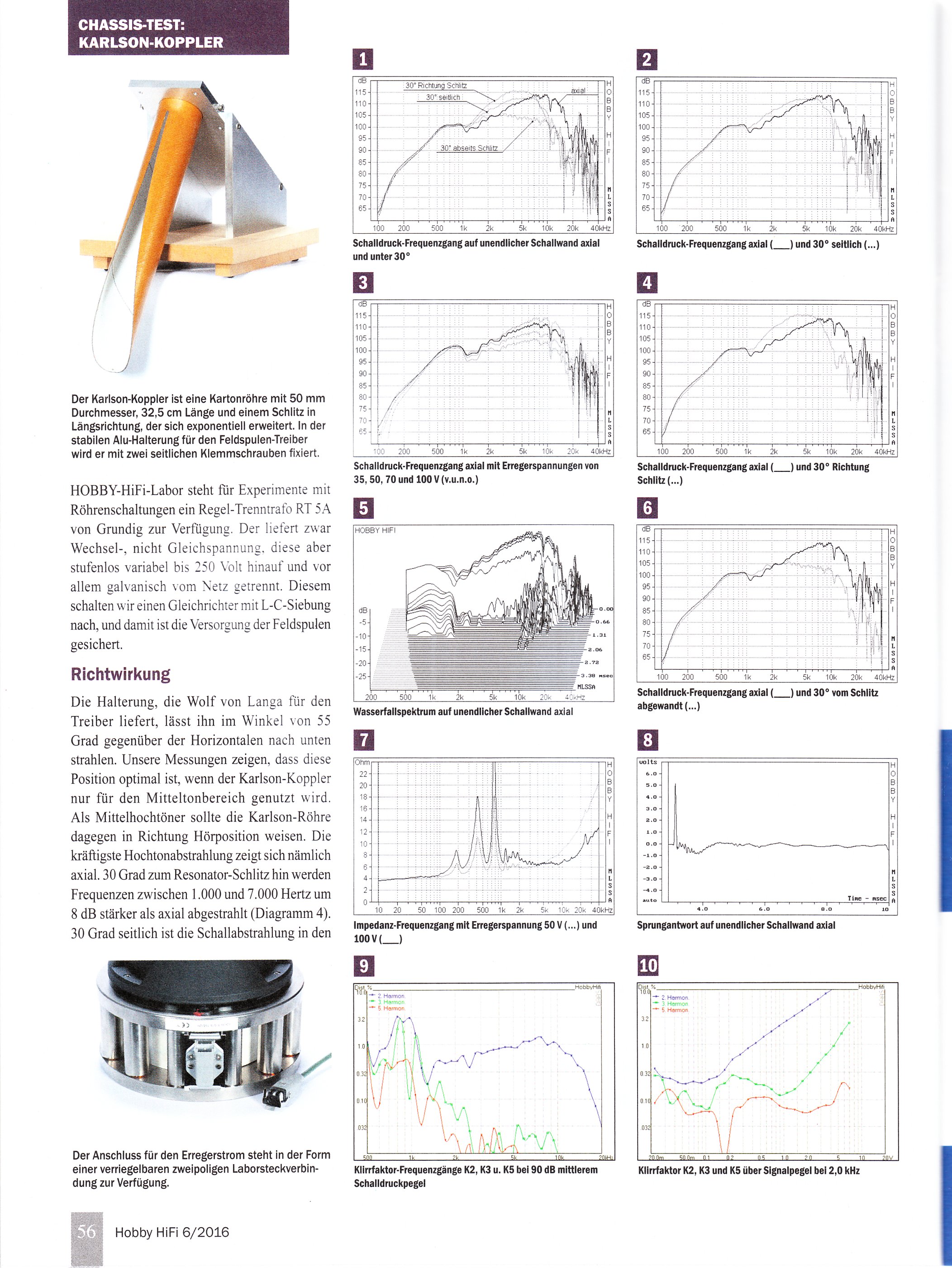

I would like to see a scan hear of that articel from Hobby Hifi, if someone with the magazine have the time for that.
A scan of the article.
Aczern,
Wow! Thanks for the scanned article. Truly fascinating. The performance looks quite good. At Freddi's recommendation (and he got me a CD to use) I have tried the K tube tweeter and it is absolutely smooth sounding and has a very wide and uniform polar pattern. The sound is beyond any intuitive sense that one might think it should sound like. It has the wide dispersion of a good dome tweeter (even better) and the high sensitivity of a compression driver by without the harsh spitting sound of a CD.
I can't read German but am guessing this is a field coil driver and that box is the could voltage source?
2nd order harmonics are high at around 1% throughout but higher orders are low(ish).
Probably because the coupler appears to be relying on diffraction which is something other horns try very much to avoid.
And yes it is a field coil driver and the box on page 3 is the transformer supplying it.
Thank you aczern for the article. Not exactly a straight response, but It can be worked with. Not much Hf extension. What concerns me the most is the waterfall plot around 8-10KHz, unfortunately it is problematic on all compressiondrivers I know. but we dont know what is caused by the driver and what is caused by the tube. Interesting....
