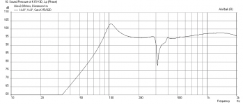

I will run a sim of the A12p in a Karlson scaled to a smaller size for you as soon as I get a chance. However, I can say that the Karlson scales poorly for anything below a K12 - there is no bass really below 100 Hz. What you might be interested in to experience the Karlson with smaller drivers is the Karlsonator which can be scaled as small as 0.4x with good results in the bass department. Are you interested in achieving bass extension down to 60 Hz or 40 Hz? Also, the Karlson is really designed for a low Qts driver with high efficiency - like many pro audio drivers.
A12P in scaled Karlson and Karlsontor

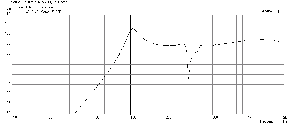

The K15 scaled to 8/15x (0.53x) seemed to optimize the response to reduce the peak bass as a result has a bass roll-off that starts at 100 hz. Unless you plan to use with a sub, this is not good. For the Karlsonator, I scaled the original plans by GregB to 12/15x (0.8x) in height and depth and 10/15x (0.67x) in width - this seemed to give the best extension and flatness. It is still a pretty big cabinet at 24 in tall and 10 in wide.
K15 scaled to 0.5x:

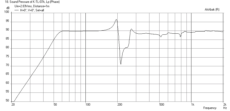

Karlsonator scaled to 0.8x in height and depth, 0.67x in width:
408169d1395748007-karlson-expert-help-required-karlsonator-12o15-10o15-a12p-freq-1m.png

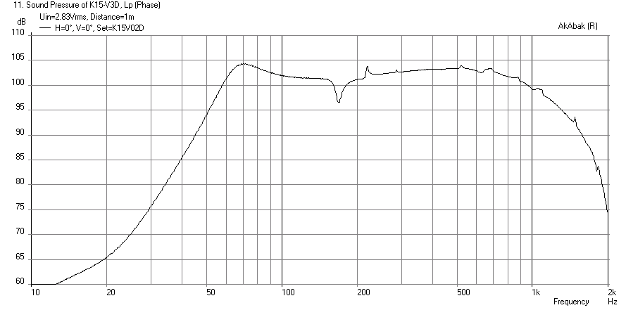

I would go with the Karlosonaotr, and if you really want to experience what a K15 is all about, get at 15 in pro audio driver like an Eminence Kappa 15A to experience the visceral gut punch and body slam of kick drums and the like of this:

The K-slot helps smooth the response and improve polar directivity. On the Karlsonator, it extends bass. I have not used it in a sealed alignment which might be like the "Klam" which Freddi says works really well. Look in the Speaker that Kicks Butt thread, or the Karlson thread. If you are going with a sub, certainly the sealed route may work - you only need the Karlson multi chamber reflex or the Karlsonator TL to get deeper bass.
