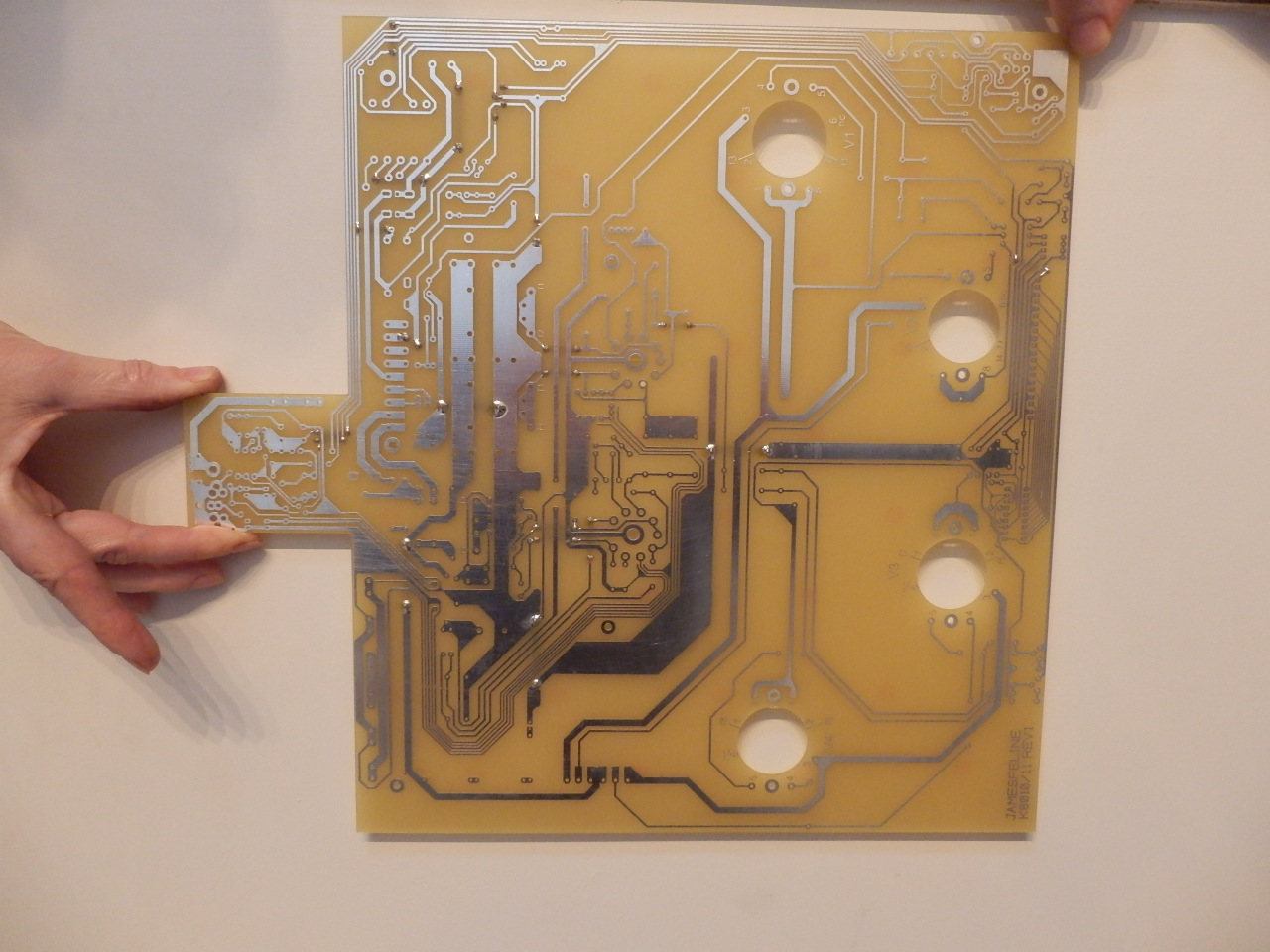

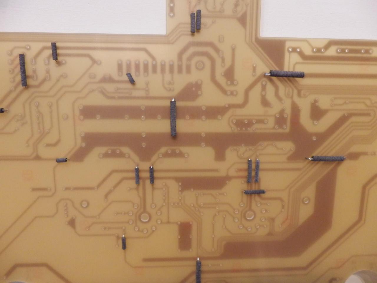

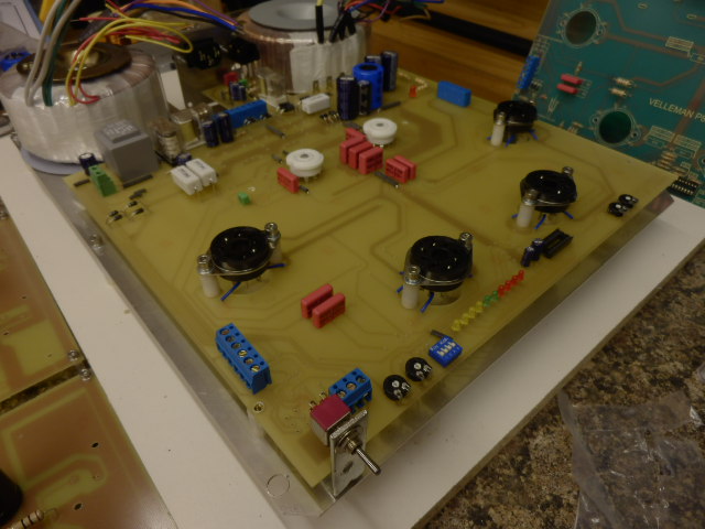

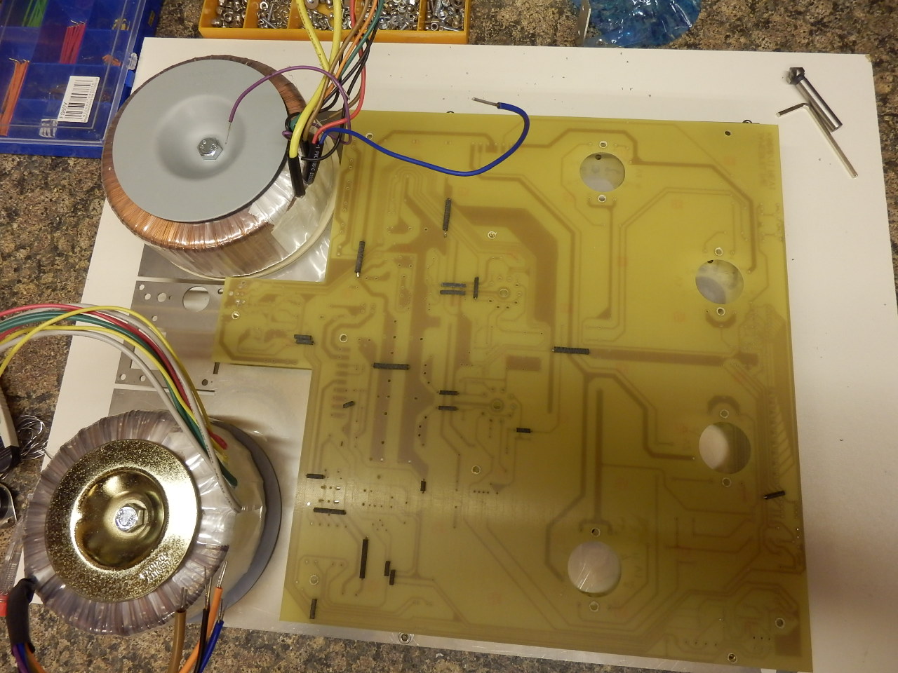

Hi
I have always been a fan of these mono block amplifiers via velleman .. both the el34 and kt88 version.

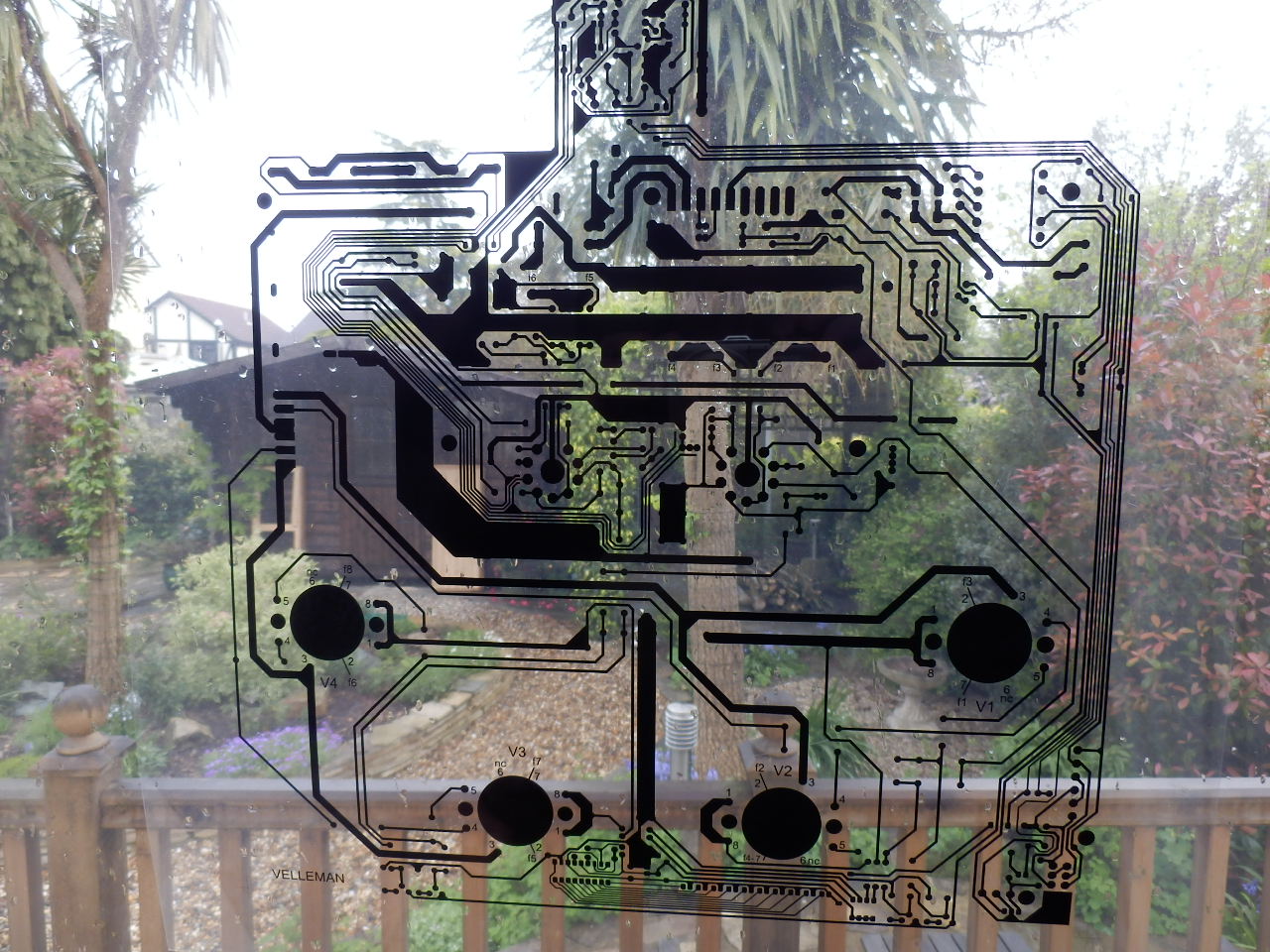

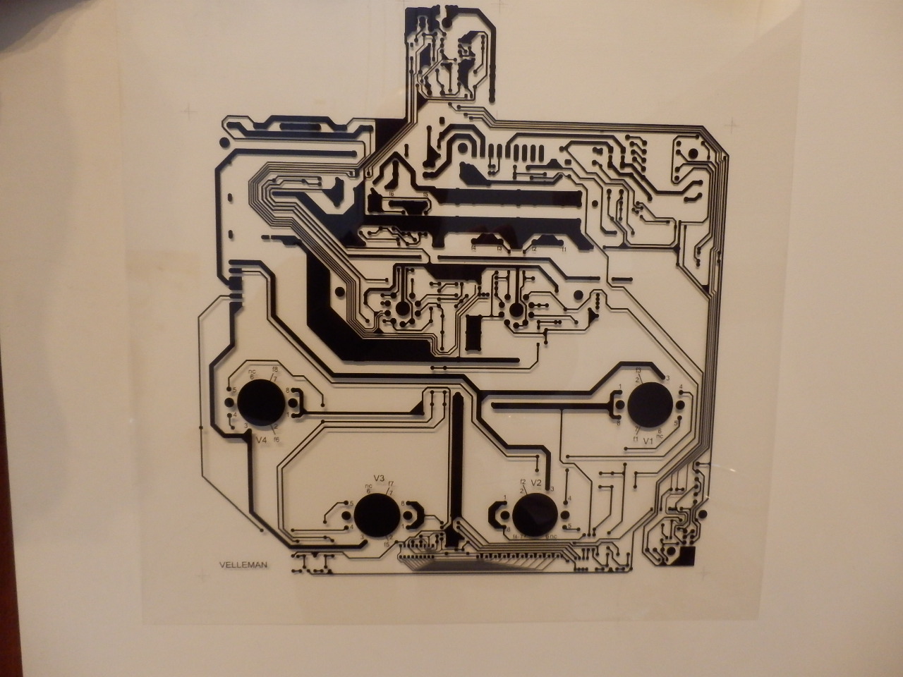

Velleman have long since stopped production of these years ago .. I purchased their last 27 boards they had in stock. I have now since decided to make my own new production boards (Velleman where ok) but the issue was that these boards where made before Gerber files.
So after some hard work I produced the artwork the old fashion way then painstakingly converted to a full Gerber file so I can get them made again.

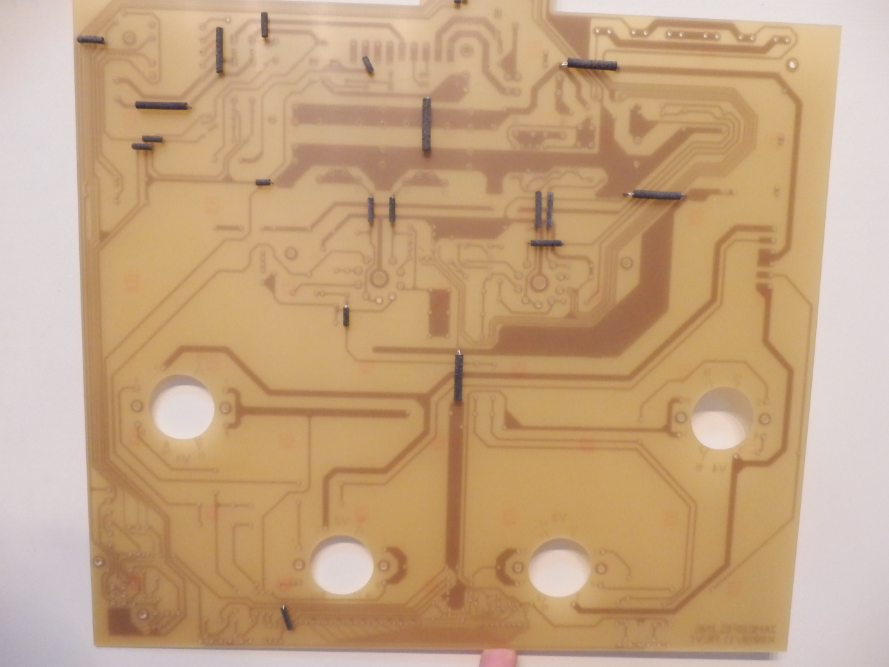

My new boards are fully drilled with 2oz copper tracks. This is the 1st production board being populated, with the wire links 1st .. I will update more on the progress of the first board. This will be A 90w EL34 version. The new PCB boards are thicker as well so no flex ..

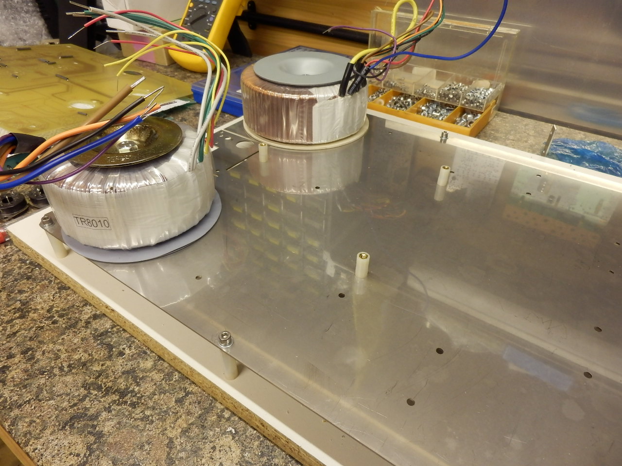

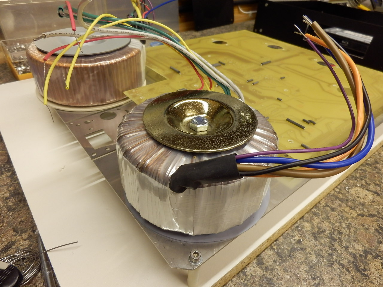

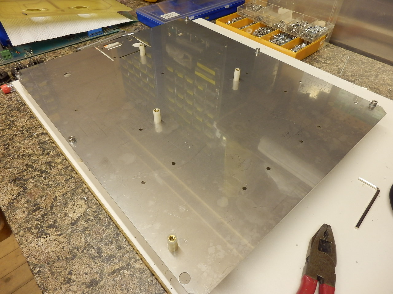

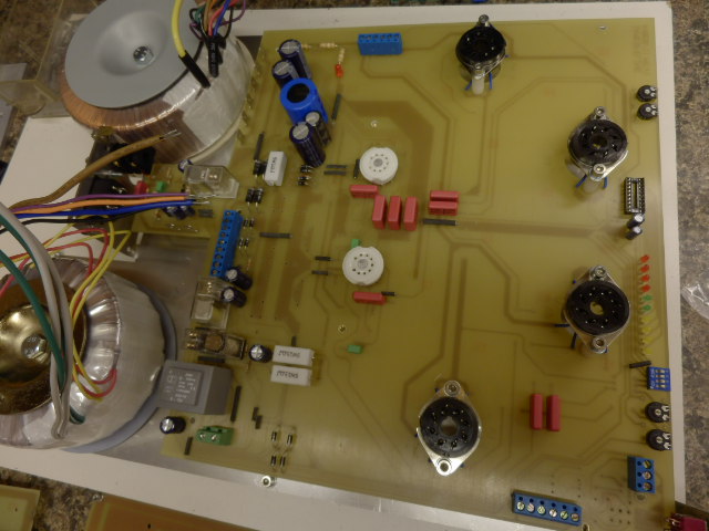

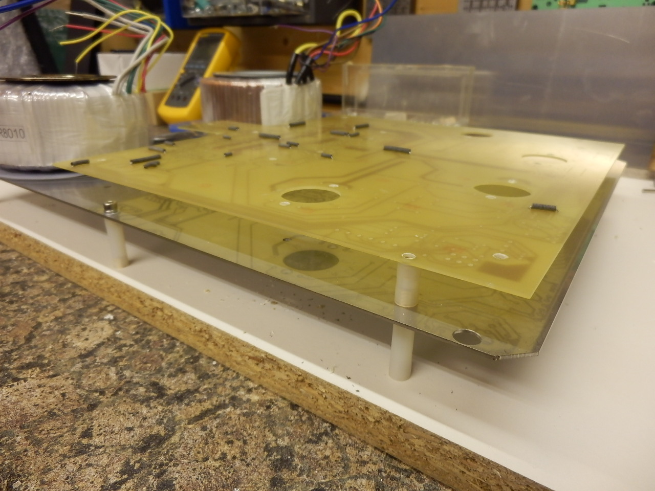

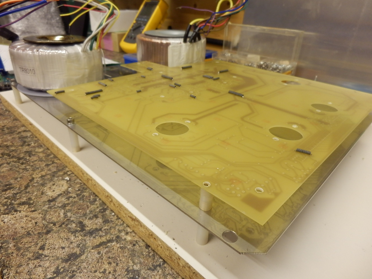

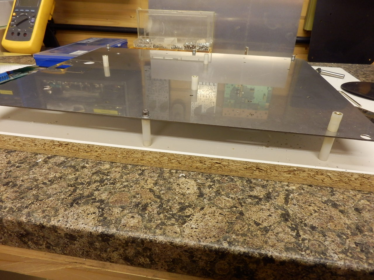

Hi
Some more pics
These show the chassis in preparation and the power / output transformers being bolted to the chassis
Then the PCB being offered up for alignment purposes ... This will be the first prototype replica of the K8011/k8010 mono block valve amplifier based on EL34 valves

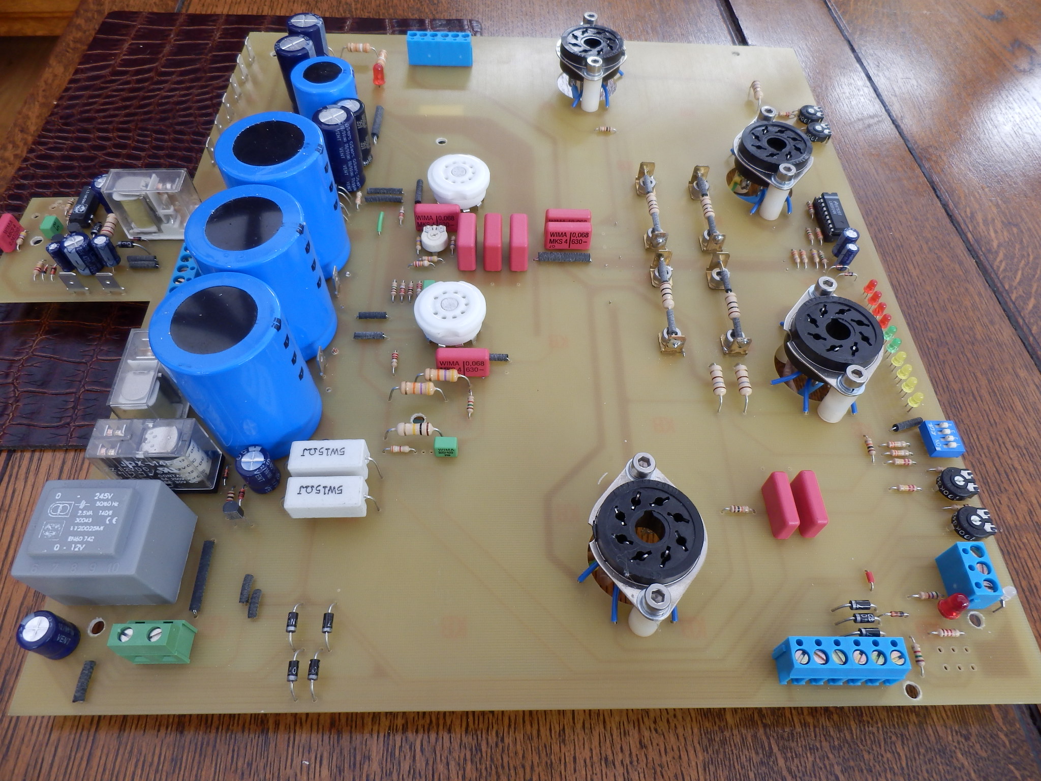

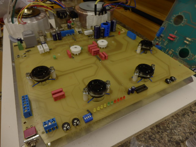

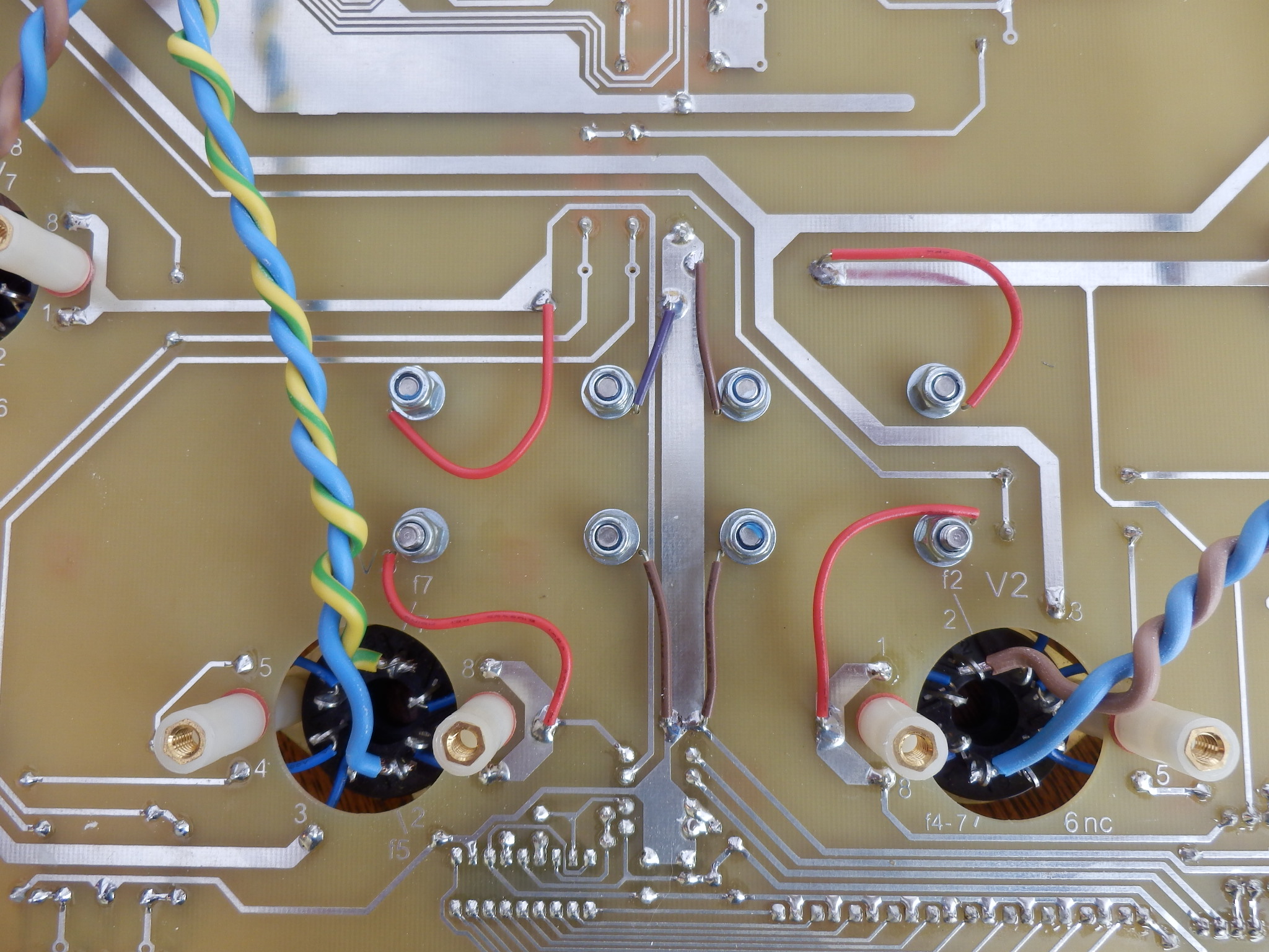

Hi
Some more progress on the k8011 PCB (90w RMS Mono block)
This is a new PCB with my own Gerber files with 2 oz copper tracks ..

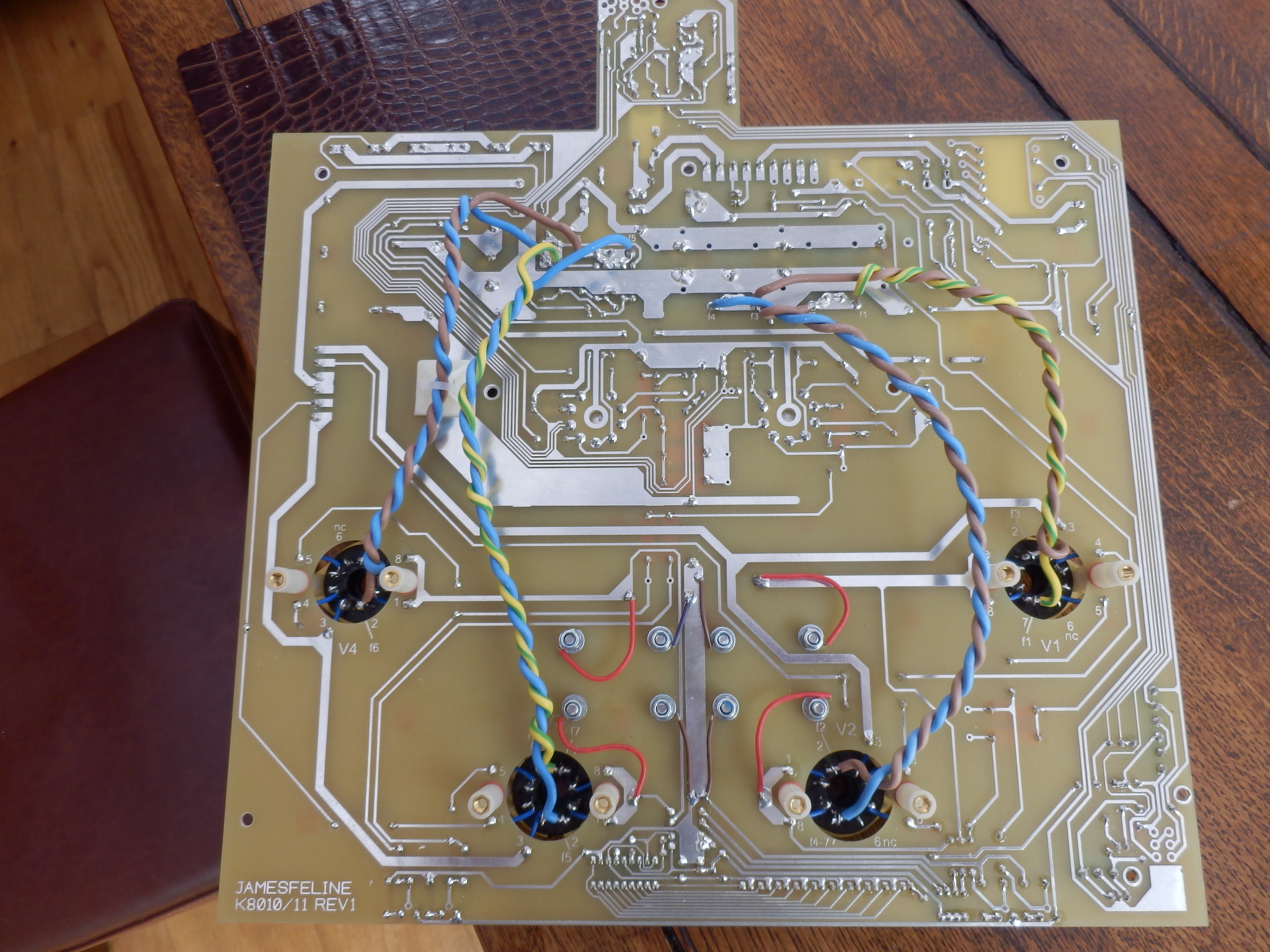

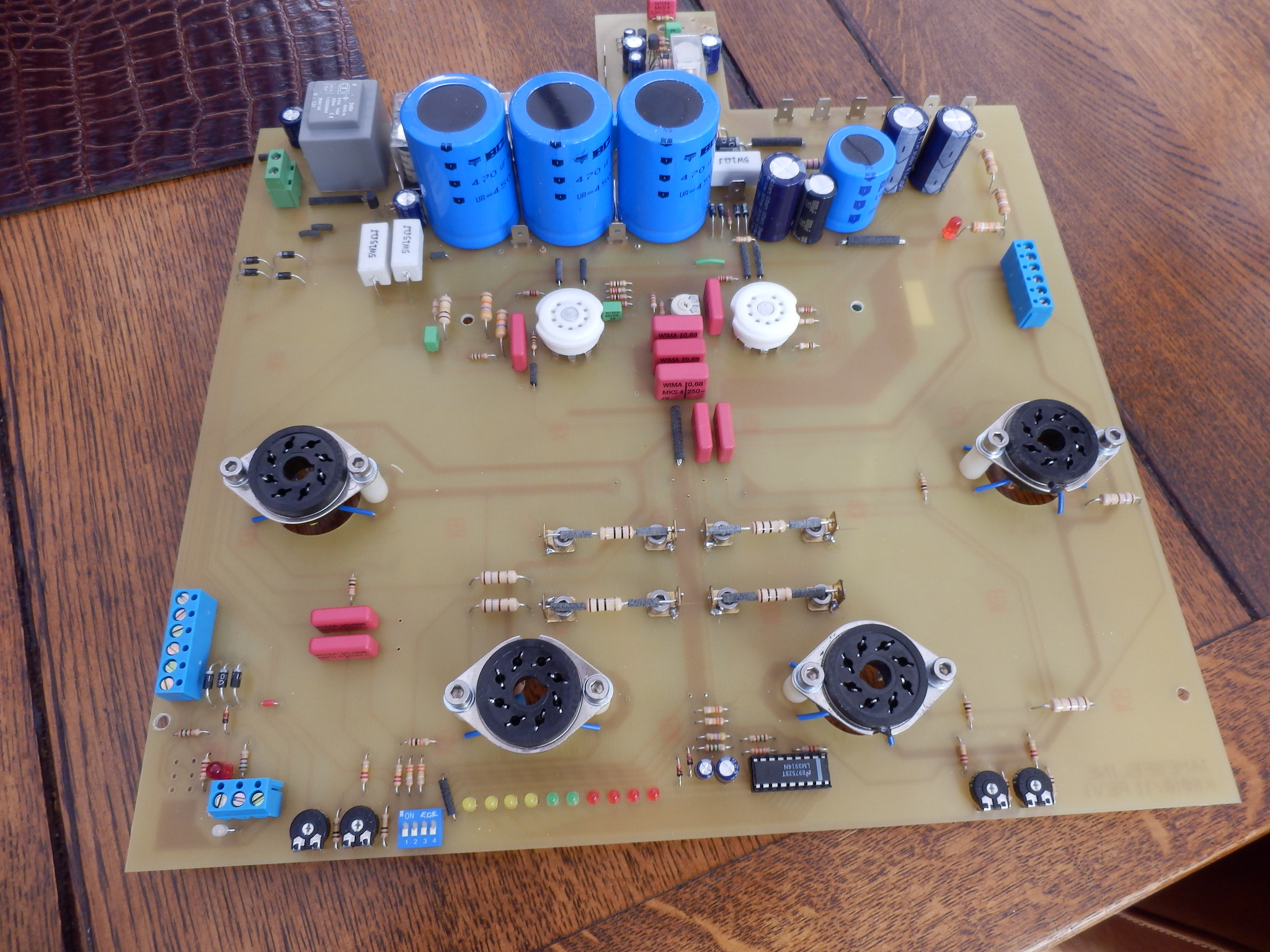

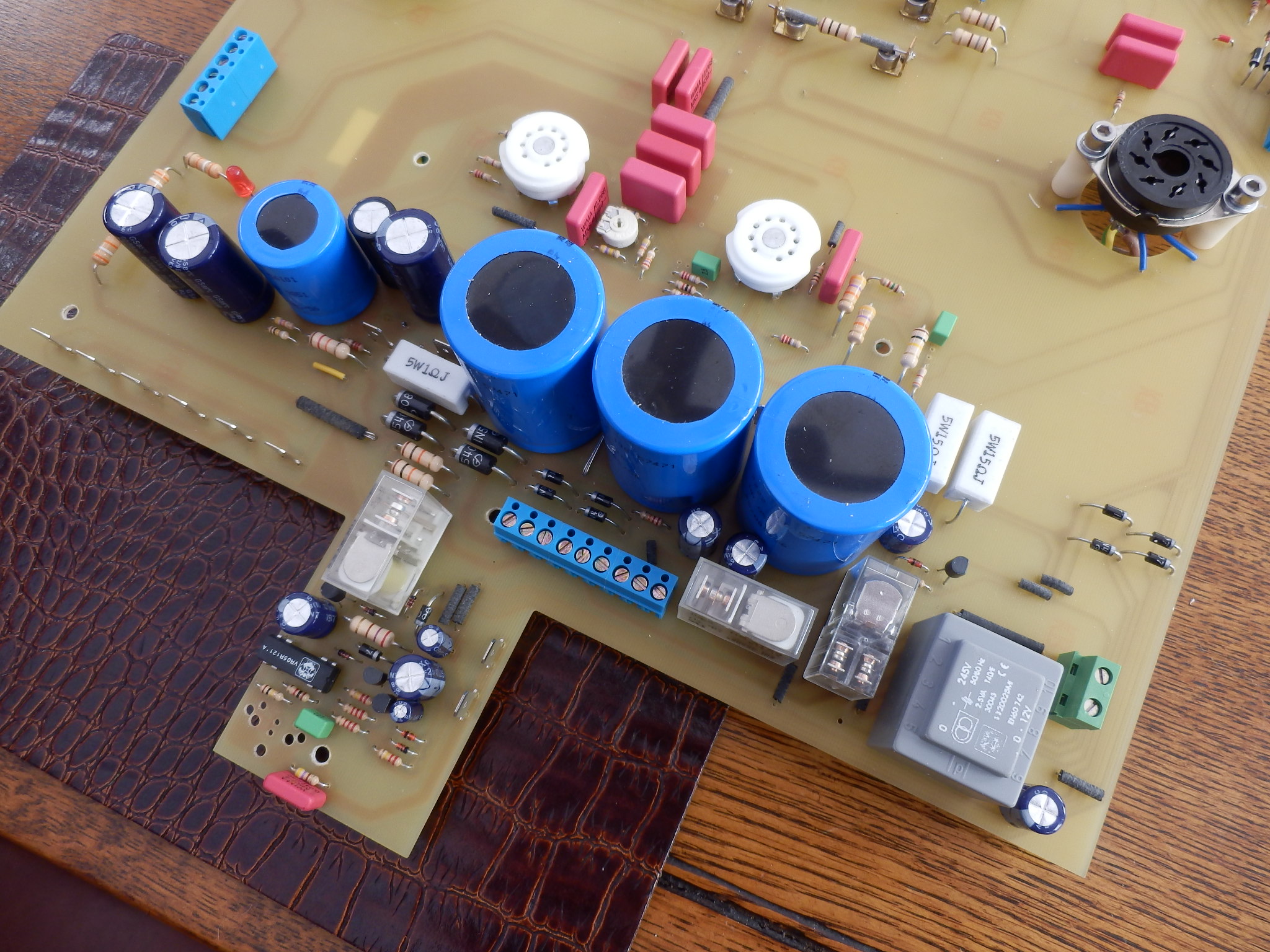

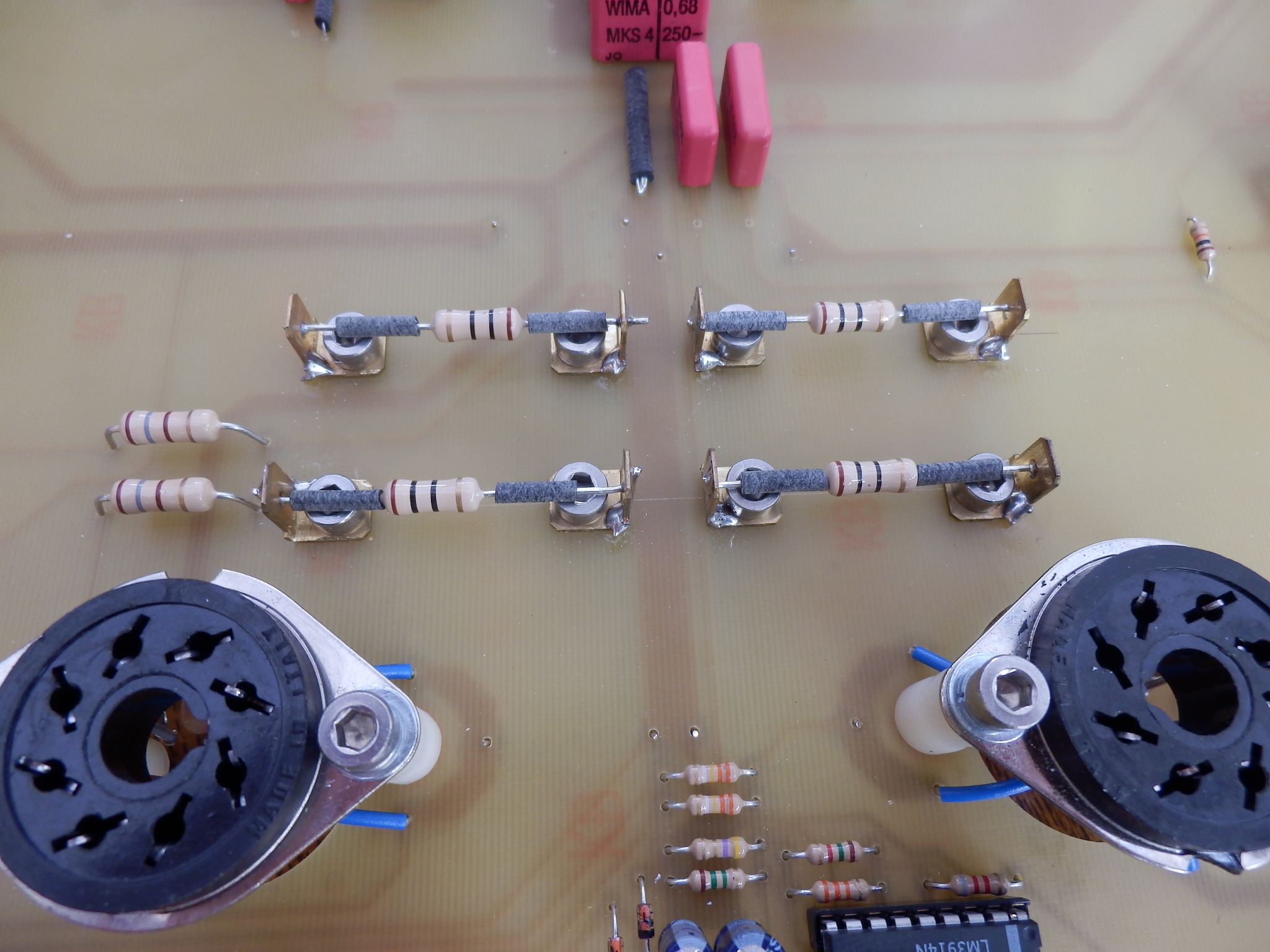

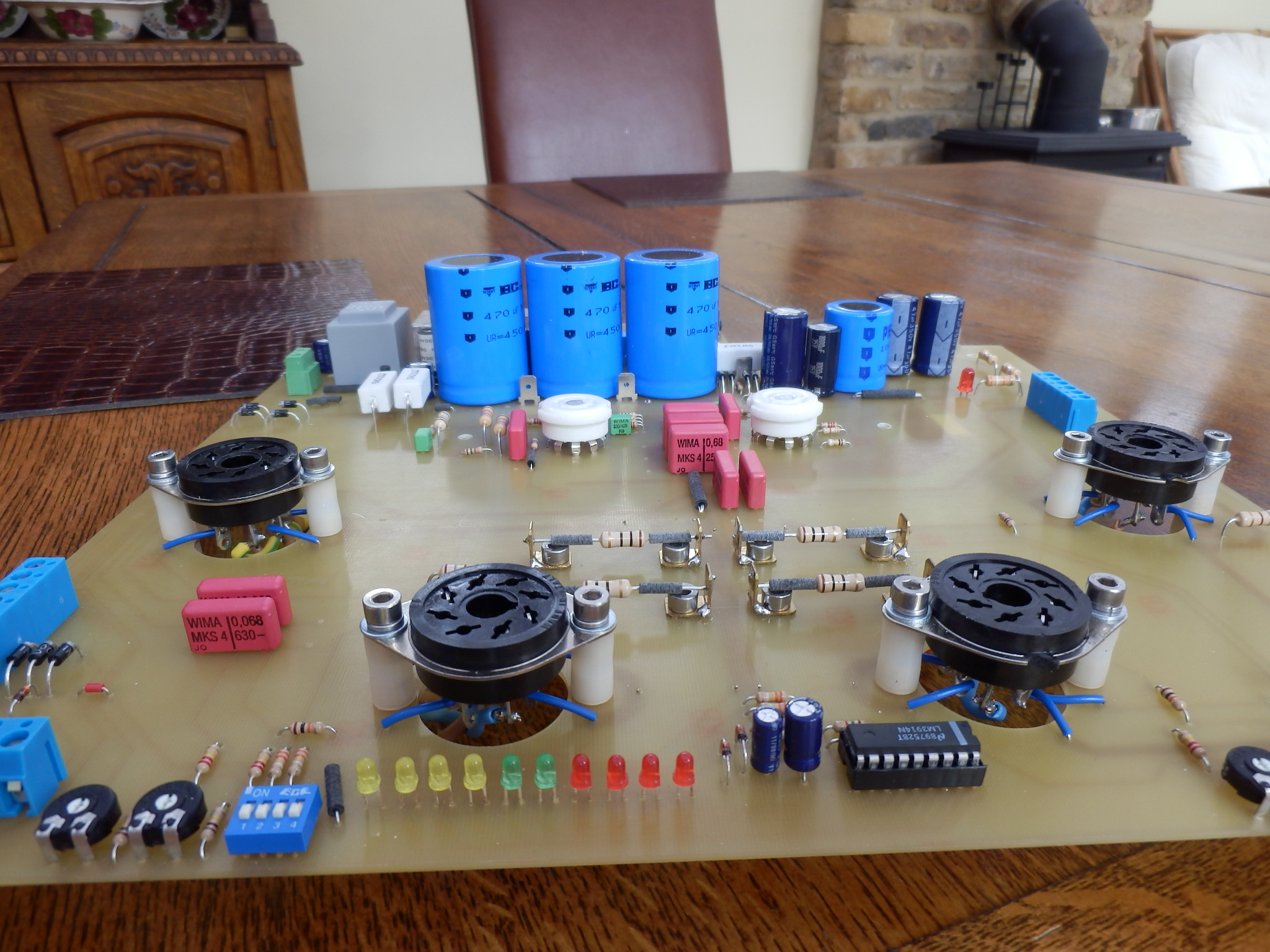

Hi
Some more pics as the 1st PCB has now been fully populated, next stage is to add to the main chassis plate and connect all the switches and transformers. Also note I have mounted the 10 ohm cathode resistors off board for easy change out in case a valve pops .. which normally takes out the resistor. These are sized for 1w only as a safety feature, so they go open circuit as not to cause any more pcb track damage.
regards
Nick

nick
wonderfull work
the PCB is populated as an art work
I notice that you have increased the value of HT capacitors.
But to be very efficient we should introduce a couple of resistors between
the capacitors an as the PSB is done it is impossible.
How long have you been involved in DIY to do things so neat?
Congratulations
