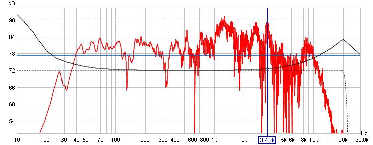

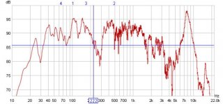

You really need for them to be 1.2 meters or more away from anything to get good data. I guess you are getting results from multiple reflections from close by surfaces.
Yes, I am listening to them at about 0.8m distant with a desk between me & the speaker, as well as a LCD monitor in between.

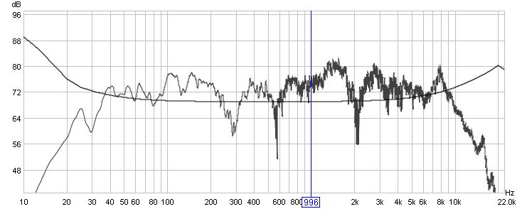

Here is the response by toeing in the speakers so that they cross in front of me. Looks a little better and better highs, allowing me to be less agressive for the highs with the EQ, giving clearer highs.

The higher probably do suffer from reflections - the one time I've seena MLSSA measurement system in use the mic is quite close to the driver and the driver is kept well clear of surrounding hard objects.
The equalisation settings look quite interesting in the mid to LF, though. The setting adds a mild rise around 300Hz, which is about where I found the system balanced out using two drivers instead of one. As soon as I get another pair of drivers, I'll try a cabinet with two drivers per side and add a low pass filter to one of them around 300-500Hz.
More frequency measurements
As the room EQ software has been so easy to use to quickly produce full frequency sweep graphs after tuning, I thought I'd try a few things and measure.

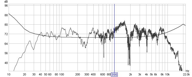

Here is the frequency response by reversing the polarity of the subwoofer. This gets rid of the hole around the crossover region.

Here is placing towels between the speaker and the seat (on the desk). Similar improvement in the combing, proving that the ratty higher frequency response is due to the direct reflections and refraction from the immediate surroundings.

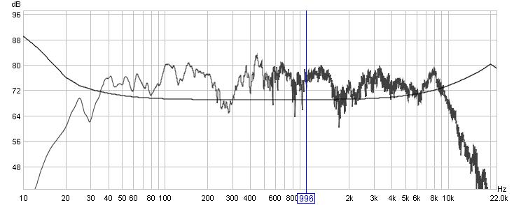

Placing a towel around the drivers to prevent any side propogation. This is a much cleaner response and probably what should be expected from this setup.
Looks like I'll have to arrange felt surrounds or similar for long term use for the Jordan's in this setup. So how does it sound now? Best way to describe it is cleaner & lower distortion, the soundstage is less than previous (perhaps because of the lack of reflections) but the instrument placement is much more distinct (as I reported when I tried the towel surrounding drivers trick with the tangbands).

The dip at 1.8k and 6k is similar to my measurements of the jxr6 and seem to be a driver character. However, mine extend beyond 20khz. I guess your rapid falloff above 10k is a measurement-setup/soundcard limitation.

Excellent stuff on the different responses with and without towels, giving a good measured insight to the effect of reflections. The software looks very impressive and, glory be, at first glance it looks like it might run on a Mac. Thanks for that link.
I noticed the effect on soundstaging some years ago when I had a desk on a line midway between two horn speakers. Once it was in place, the imagery collapsed back into the speakers. Covered in rugs, the soundstage was restored. The desk wasn't anywhere near being in the line of sight between me and the speakers. I now get very fussy about the environment around the speakers. (It's a good excuse for more books.)

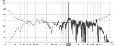

RE: high frequency rolloff, I think you are correct, as the speakers sound too bright if I try to compensate. The meter is a RS sound level meter set at C weighting and the measurement software takes into account the C weighting.
Here are more results with c weighting compensation turned off. A couple of ugly spikes at the high end now occur (and the measurement environment is the same as previously).

Updated frequency response charts

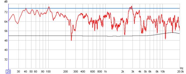

Finally I have set myself up with a decent measurement microphone, the RadioShack SPL meter is no good for speaker frequency response measurements.
I purchased the "mad about sound" mic & preamp kit which uses the panasonic WM61 electret, brass rod and a decent preamp. After loading up the MW61 generic calibration file into Room EQ wizard, I get a much flatter graph than those posted earlier in this thread. The graph has the subwoofer wired with inverse polarity (the 100 - 500Hz frequency range is flatter that way) as well as the speakers toed in about 20 degrees which provides a flatter treble response. If you have noticed that 100Hz and below looks boosted - its because I like it sounding that way!
To perfect this setup I will add electronic equalisation for the dip at 300Hz and the peak at 2Khz, as well as room impulse response correction and this project should be done. Fiddling around with the equaliser based on the results from Room EQ wizard using a digital convolver removes some of the mid range forwardness and does make it sound more neutral.
