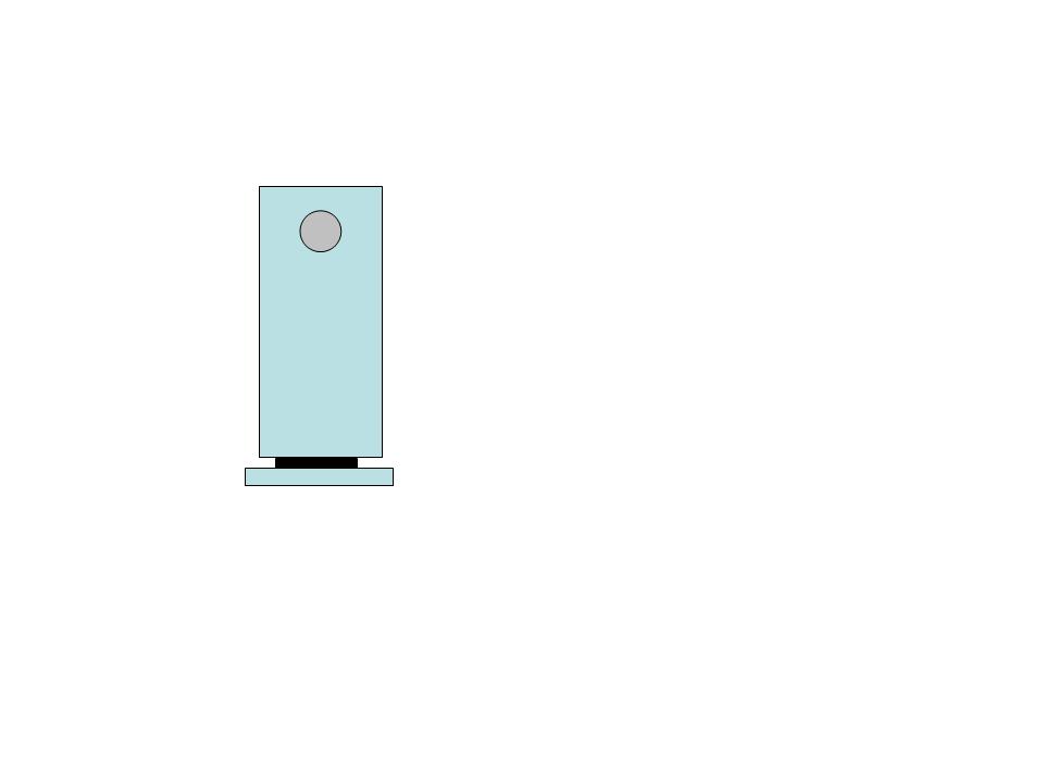

Regarding the cabinet design, I'll be making a mini version of the popular jordan wide baffle design, as attached, 400mm high, 200mm wide, 75mm deep size 2.6l, sitting on a plinth. The drivers will be rebated into the front baffle and I wont be using any felt surrounds, but the edges will have a 45 degree rebate.
I'm a little concerned with such a small enclosure and a wide back panel but not very deep that back panel reflections will be a problem with this design, especially as the reflected wave will pass through the thin Jordan cone, adding an out of phase component and possible cone distortion. As the 75mm distance to the back panel is not that large, any reflection that passes out the front will not be too much out of phase, although as its only the lower frequencies that will pass through through this should not matter much.
Is this really a problem with such a small driver, thin cone and this cabinet design? Is there a cabinet stuffing or lining that would work well with such a small depth?
Dean
Hi - I'm also cautious about reflections from the back panel. What works for the JX92 may not be as effective for the JXR6.
I attempted a TL design for my JX53s which had a cross-section of 4" wide by 3" deep. The line was tuned to 120Hz. It always sounded very thin, so I abandoned it. I tried the JXR6 in it and whereas I was now getting output to 120-ish, it still sounded thin. Putting the 6 in my 2.4 litre ceramic cube has confirmed that it was the line which was the problem, not the driver. I can only conclude that the depth of the enclosure wasn't enough. (The width may have something to do with it - 4" vs 6" in the sealed enclosure.)
I'd go for something more balanced in CSA and if a wide baffle is required, integrate some kind of frame around the enclosure. Alternatively, a wide baffle with curved back to give it some depth (it would be possible to do this using the bendy MDF which turns up in DIY stores). A triangular cross-section would also work well.
Hope this helps.
Hi Colin,
That sounds like a good plan. As the driver will be mounted high in the front baffle, it would be easy to make a curve to point the back radiation down into the box, where there is a lot more room and the sound wave will be dissipated by the stuffing. Also as the JXR6 does not radiate that much due to its small size this should be less of a problem. I found a couple of interesting points on the Jordan web site about this.
Q: Will the shallow VTL enclosure cause audible reflections behind the JX92S?
A: On the contrary, it will raise their frequency and make them easier to absorb through use of acoustic damping material placed behind the JX92.
One suggested design for a stand-alone system is shown below, made from 12mm ply or MDF. Two panels are cut for front and back - the sizes shown below are external. Then a matching frame (A) is cut to the same external dimensions. The hole inside the frame should be 15cm (h) x 19cm (w). Five frames, clamped between the front and back panels, will give approximately 2 litres. The number of frames can be altered to match the volume required. The hole inside the frames could be cut in an irregular shape, to help break up internal reflections.
The JXR6 HD should be inset to be flush with the front panel and the outer edges of the cabinet rounded. Place four small pieces of dowel at irregular points between the front and back panels to brace the enclosure and the inside should be lined with felt, BAF wadding or similar absorbant material.

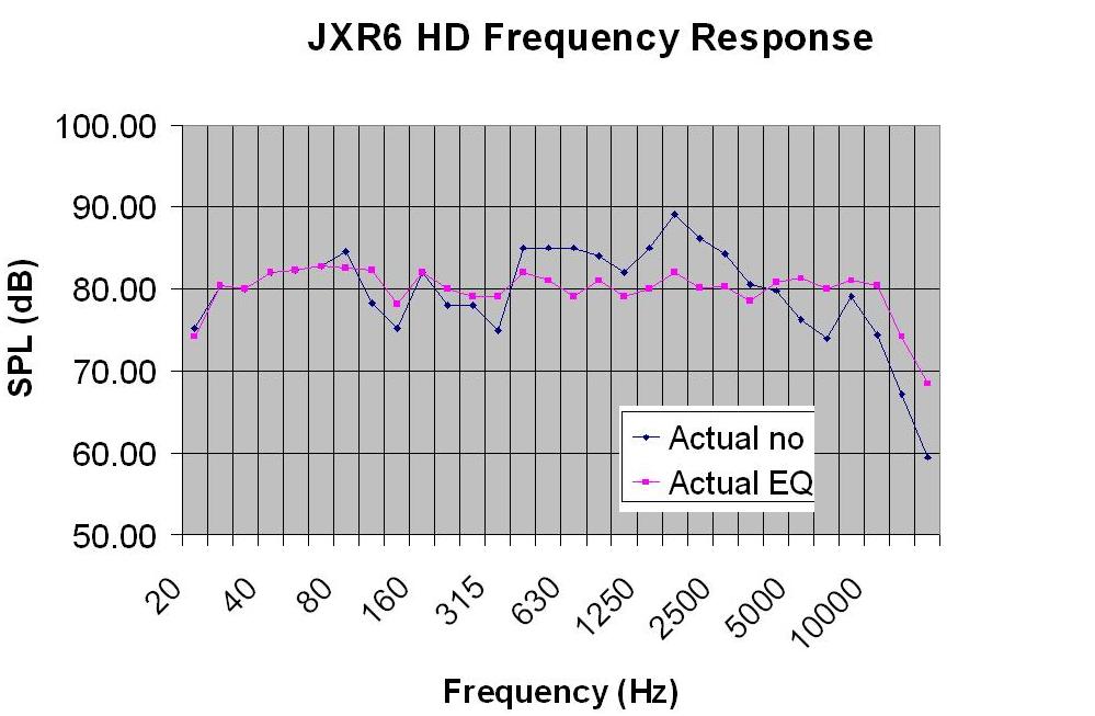

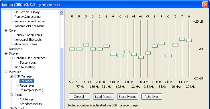

Frequency compensation
After working out that I had to use 1/3 octave pink noise to tune the frequency response of the speakers (instead of sine waves) I have used a digital equaliser in Foobar 2000 to try to get the response as flat as I can. It's hard to get it +-2 db but I can get it to +-3db by adjusting various analogue and digital filters I have with this setup, and trying to keep the low frequencies away from the JXR6 HD (as I have a subwoofer).
After a couple of hours tuning the hollow sound is now gone, the speakers are richer & have more air. Switching the digital equaliser in and out really shows how hollow and flat the sound was without the EQ. Although its a bit painful to get the EQ right, it makes a huge difference to the sound quality, as large as replacing the TangBand with the JXR6HD, in fact the EQ allows the JXR6HD to shine, improving the imaging and clarity of high frequencies.
I think I have reached the end of the tweaking for this setup and any further work will have minimal gain. And I'm pretty happy with the sound 😀
I have attached the digital EQ settings and response for those who are interested. Note that with this method I get to tune the entire system including the room & box, so the settings seem a bit more extreme than if you were just trying to equalise the driver alone.
Dean
soongsc,
Note that the measured response is the in room response measured where I sit, so includes the box & room effects.
Its possible that I have made measurement errors, however I did double check them and I used a radio shack sound level meter with calibration adjustments I got off the 'net.
Dean

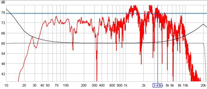

More frequency measurements
I found a useful software frequency analyser "Room EQ" and to double check my frequency testing & EQ, I ran this software. Its amazing to see it run thru automatic sweep & measurement. I have attached the frequency response, pretty similar to my manual method although it does show what looks like comb nulls which is very strange, possibly due to my LCD monitor between the speakers.
This plot has allowed me to adjust the EQ settings to flatten the curves out even more, which sounds a little better than the previous settings.
Dean
