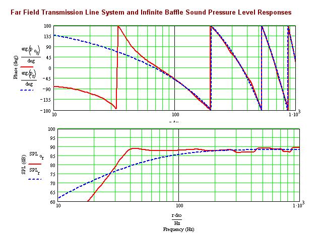

Just a few thoughts. I deliverately haven't looked at the plans available on the Jordan site, but this is the best practical response I can get from the JX92S in MathCad after playing adround for 5 minutes or so. It's a straight, mass-loaded quarter-wave tube:
Length: 45".
So & SM = 4.5Sd
Port: 3"x4" (WxD) 4" from the base on the front panel.
Driver centre at 33.75" from the base (11.25" from the top).
0.5lbs ft^3 of stuffing. You can reduce this to 0.25lbs ft^3 at the price of fractionally increasing the ripple.
You won't need any series resistance here, though a BSC circuit will be needed. Approximate values would be a 3mH inductor and 3-4ohm resistor. I wouldn't bother with a zobel in this case.
Best
Scott

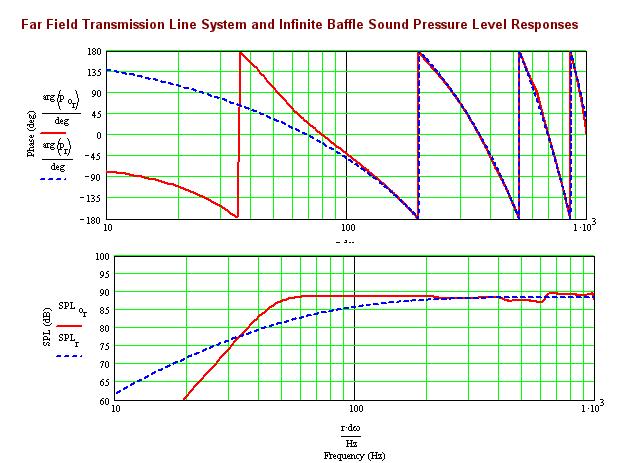

Hi Scottmoose
I haven't seen GM's graphs for his MLTL designs but the 48 inch long version gives good output to the low 30s. The specs are here.
GM sets the drivers a little farther down the pipe than in your example - the 31" version has it about 11" down. I presume this all to do with damping the harmonics. I'd lbe very intersted to see graphs of his two designs.
...and here's the anechoic plot for Greg's MLTL48, also in Martin's MathCad worksheets.
Both provide similar results to the one I made earlier, which I find comforting. We've taken a different approach however -Greg has gone for a narrower, shallower cabinet that's a whisker taller, with a fraction more stuffing, and a narrower, shorter port. I have gone for a slightly shorter cabinet, with much more internal volume, and a wider, longer port, following my usual approach as I'm always a little uneasy about narrow vents. Paranoia for the most part, but I always take the larger option as I don't pretend to have anything like Greg's practical and technical knowledge or experience -few people do, other than, say, Martin King, Terry Cain, and Bob Brines.
My cabinet appears to go very fractionally deeper, with a hint of a peak at cut-off, which was what I was aiming for, but there's little in it, so Greg's is by far the more economical design in terms of space taken up.
The MLTL31 looks to be the flattest of the lot. It gives little or nothing away to the others in extension either, though the stand it requires means there's little in it in terms of outright space taken up I suppose. Two superb designs then, but what would you expect, coming from the source?
Best
Scott
