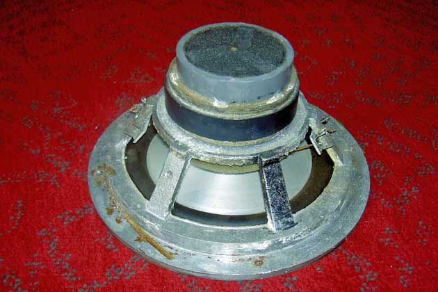

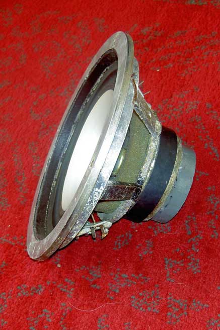

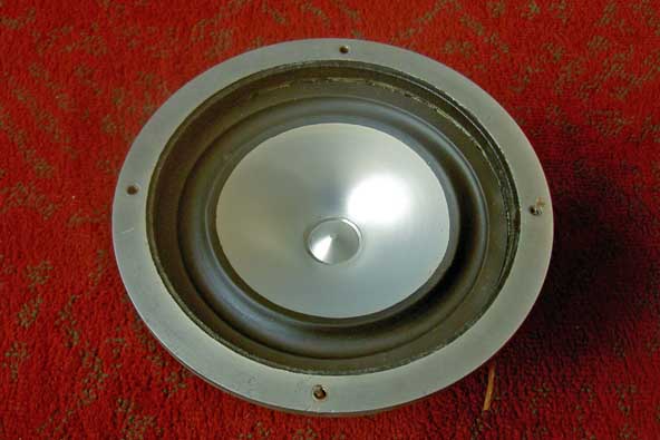

ok now a mystery for any detectives out there, i thought the bass drivers i had where jx150,but dimensions dont tally with what collin posted,also doesnt tally up with jx125 yet these must be a ted design....has he been experimenting on the quite,ive had these afew years now,was brought off a guy who told me they was the jx150s....gutted really as it could mean all the parameters are unknown(not that that means much to me anyway)
any clues...will try to post pics on here for viewing!

Hi Smithie
What do the drivers look like? There was an earlier bass driver, J125, which had similar cone but a cast aluminium chassis, an inch or two wider diameter than the JX125 (poss deeper as well). It was used in the old Townsend Glastonbury speaker. Still very good and might match your 92 better. As far as I can remember, I think it had a silver surround rather than black, but this may have changed during production.

width of outter frame is..211mm
cone is 123 minus rubber surround.
depth is.. roughly 105mm.
thats all i have......
thanks
smithie

I think they are the Glastonbury drivers, possibly reconed. Ted's original drivers had a sort of glue spot int he centre where the centre suspension attached. He had these on early JX125s too, then modified them to have the centre 'dome' covering the glue spot. These look like the newer cones in the original chassis.
Both types of 125 work fine in a sealed enclosure, between 25 and 50 litre size. If the parameters are in question, this is probably the safest way to go. I use my JX125s in a 35-ish litre sealed enclosure, which gets to 45Hz in my room.

thanks for that,was getting worried there as i was thinking that they wouldnt be up to the job,the real deal.
so ill do as you say,aim for a 30-35 ltr sealed enclosure,45hz is respectable enough for me.

Glad I was able to help. The 35L boxed gives a Q of about 0.7, which should match well with an 8L JX92 enclosure. Let us know how you get on.
