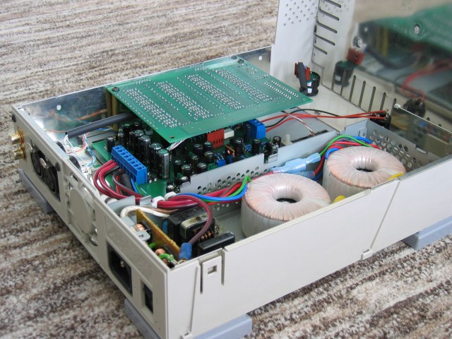

I'm not too happy to report that a substantial amount of the audible noise on the output of this amp is contributed by the relay attenuator. I haven't really figured out why yet. The micro was putting some nasty noise on the power rail of the relays, but placing a small cap between the power pins (there's just enough room for an 0805) on each relay cleaned up the scope trace without reducing the audible noise. Neither does removing the microcontroller altogether help.
With the attenuator disconnected and the inputs shorted, there's still some barely audible noise. My only idea for getting rid of it was to place a cap across the LED stack reference in the diff input's current source, but that point is extremely quiet already. I added the cap to test but of course it didn't help.
First of all, I'll guess that you have diodes across each relay coil? Then, you will have 0.7 volts transients on the power line. One method to avoid this is to make the relay switch off slower (less dV/dt).

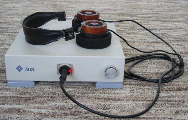

Looking very good, makes me want to get mine done too.
Are those the new grado? I recall seeing somethink like that in some magazine recently.
They are the RS-2, which I think have been around since at least 1997. I prefer the sound to the more expensive RS-1.
PCB ?
Would it be possible to get the layout files for building the PCB ? Or to buy it to somebody ?
Thx
Akira
Thx
Akira
I sold the last PCB already. I can post the Gerber files, but you should understand the following:
1: The mounting and cooling are designed for the Sun 411 SCSI disk case
2: Some devices are mounted under the board. It is difficult to build
If you still want, I will post the Gerber files.
