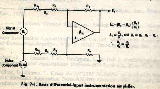

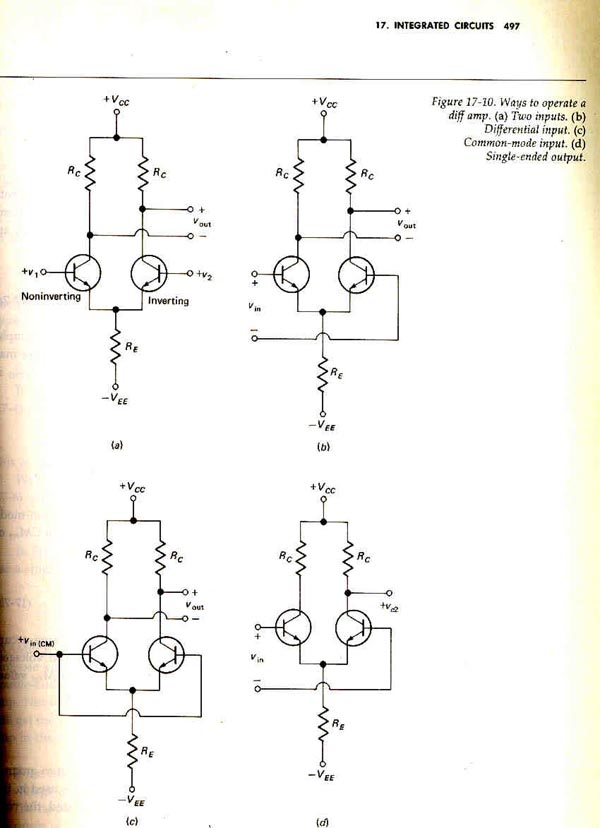

According to your schematics, you have a non-inverting input and only one input. The output is single ended and not balanced. A balanced amp always has two inputs that are non inverting and a inverting. That’s the only way you can get right of a common mode signal like 60Hz on at the outputs.
Audio amp don't have balanced input they have diff amps but that in it's self does not make it balanced. The Aleph is a diff amp with balanced input but not in the purest form.
Having said that, I think you done a nice job with the circuit and construction.
