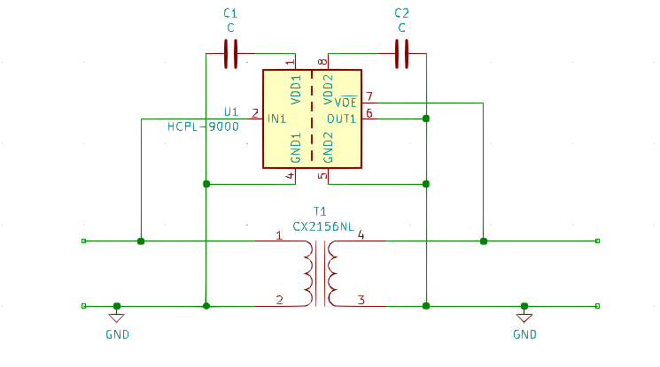

Please look at my just for giggles schematic🙂
That not work, because the two halves of the circuit would interfere with each other.
Be aware that a connection which worked from DC to 1GHz would not normally be described as isolation; it would be the exact opposite of isolation.

No, I did not say that the solution is transformers or that a simple parallel combination of transformers will work.
One possible DC-to-HF solution is a high speed optical link sending numerical information about the situation in one end of the fiber to the other end of the fiber where the information is decoded. It is technically not simple but can transfer information in quite a wide frequency range.
If you just put transformers in parallel, the transformer that is not suited for the actual frequency is likely short circuit the transformer that could transfer such a frequency.
If your principle with parallel transformers would work, why do you see a solution with wideband combined transformers advantageous over a single transformer we know will work at a frequency we know up-front?
If your principle with parallel transformers would work, why do you see a solution with wideband combined transformers advantageous to a single transformer we know will work at a frequency we know up-front?

Sorry did formulate my question wrong, what I meant was not if my circuit works, because that have already been answered but what I meant was if a solution with a digital isolator in some sort of combination with a transformer that was made for the purpose, could work🙂
But am I right in thinking that if you could find a single chip or a single transformer that went from below your min requerement and to a bit above, it could be done fairly simple?

So you do what Amplifier Research do in their Wideband power amps and stick em in series instead!
Wideband is pretty much defined by fractional bandwidth not just frequency,
100M-1Gig is only one decade, easily doable with a TLT style transformer even without any core, a 1MHz - 100MHz stage is actually much harder then a 100MHz - 1GHz stage, and the 3 decades of the audio band is actually really quite a big ask in transformer design terms.
As you drop towards DC the magnetising inductance that you want rises rapidly if you wish to keep primary current reasonable, so core sizes get LARGE fast, and of course NO transformer will ever pass DC.

I believe dmills hints a way to extend the working range of transformers. I do not know that company.
One thing you need to come up with for a good solution is a problem that the solution you have solves well.
We could perhaps imagine a more wide-band arrangement with more transformers and other elements combined. But, if we for any application where our solution could be used know simpler and technically better solutions, our solution has no purpose. This is the problem with purely imaginary exercises, that we do not know if the outcome serves any purpose.
Study the reference to a company dmills gave you and it may provide some reply to your question. When you have a specific problem to solve, perhaps we can help you.

I will now be the devils advocate: A logical use as a signal isolator, but have you thought about the input impedance of such a transformer combination? Transformers will obviously not transfer DC, but AC OK. Have you thought about the size if one transformer can do sub-Hz transfer? Why do you need GHz transfer speed for your oscilloscope? A normal isolation amplifier ranging until 50-100MHz should do and would be more precise?
Yep, you wont get high impedance inputs from such a lash up, and it will likely not be very flat in either frequency or phase response, doesn't matter much in ARs typical applications.
I would note that nobody who cares about the action above a few tens of MHz should be using high Z probes (Unless they are active ones), 50R with a source terminating resistor is so much better behaved in basically all ways.
Scopes do not have a particularly extreme linearity requirement, so I might be thinking linear opto coupler (The type with a feedback diode) or such. Transformer is probably wrong for this.
