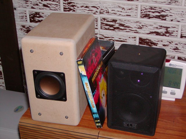

I just finished building a pair of Zaph's design, and they're way better than the cheap little KLH three ways I used before (see photo). Better stereo separation and less distortion. The sound is much 'clearer'.

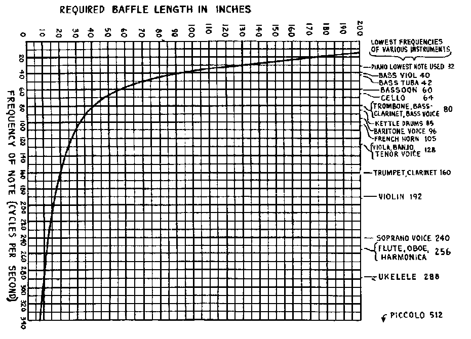

I guess the answer is "it depends". If you are planning to crossover at 150 Hz the minimum required baffle size may be around 22" (see http://i3.photobucket.com/albums/y75/Barfind/open-baffle-size-vs-freq.gif). Note however -- JohninCR discussed problems with this chart over at Decware's forum (http://www.decware.com/cgi-bin/yabb/YaBB.cgi?board=diy;action=display;num=1143087829;start=420).
I modelled two Hi-Vi B3S' (ussing Martin King's MathCad worksheets for OBs) in two different baffles; one that was 9 x 32" and one that was 12 x 42" (the Orion dims are 13" x 46"). The B3S' were 4 and 8" down from the top of the baffle in both cases. In both baffles the B3S' dropped off very rapidly from 300 Hz down.
