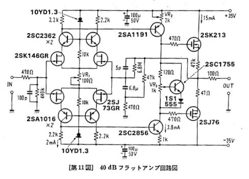

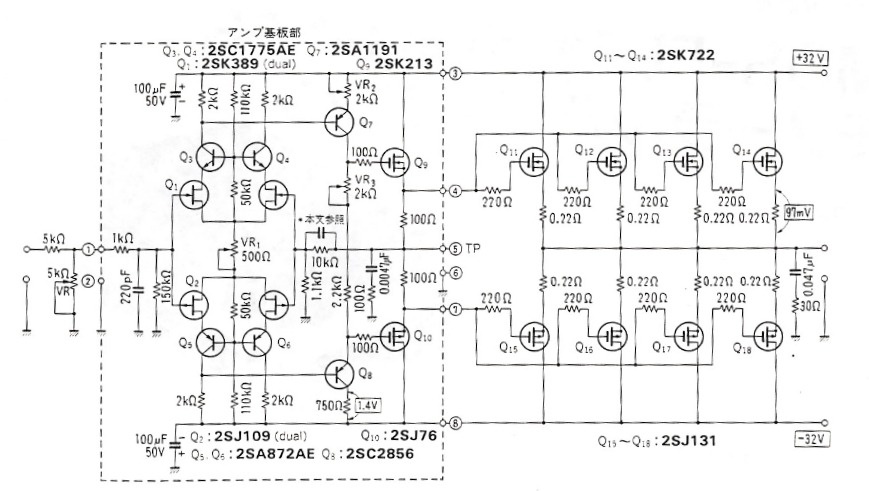

I ran across the articles (japanese), and found these striking circuit diagrams.
What is the use of connection '5' ("TP") in MosFet_NFB_1.jpg?

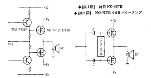

How much 'NO-NFB' is valid in MosFet_NFB_2_no-nfb.jpg?
How much 'NO-NFB' is valid in MosFet_NFB_2_no-no-nfb.jpg?

I didn't build the circuit in MosFet_NFB_1.jpg.
Typically "TP" means Test Point.
If the front end( voltage gain) section of the amp was used by itself TP would be the output.When I looked at the PWB and the wiring diagrams in the article, it seems that TP is not connected.

Sorry, I don't understand your other questions:
There is no NFB in the output stage. Only uses NFB in the voltage gain stage. The output stage is a huge buffer so any weird speaker and speaker cable impedance swings won't affect the NFB in the voltage gain stage.

he front stage (within the dotted line) is a regular NFB circuit. The output stage with the mosfet's are not linear.
"How much 'NO-NFB' is valid in MosFet_NFB_2_no-nfb.jpg?"
As said in #7, only the output stage is without NFB. It's a firm claim to name it a NFB-less amplifier.
"How much 'NO-NFB' is valid in MosFet_NFB_2_no-no-nfb.jpg?"
It is a regular amplifier with overal NFB.
"...so any weird speaker and speaker cable impedance swings won't affect the NFB in the voltage gain stage."
That's what zillion amps suffer from?
In general, a " "MJ" for a No negative feedback Class A power amp ( both BJT and MOSFET)." is quite a big claim in my opinion.

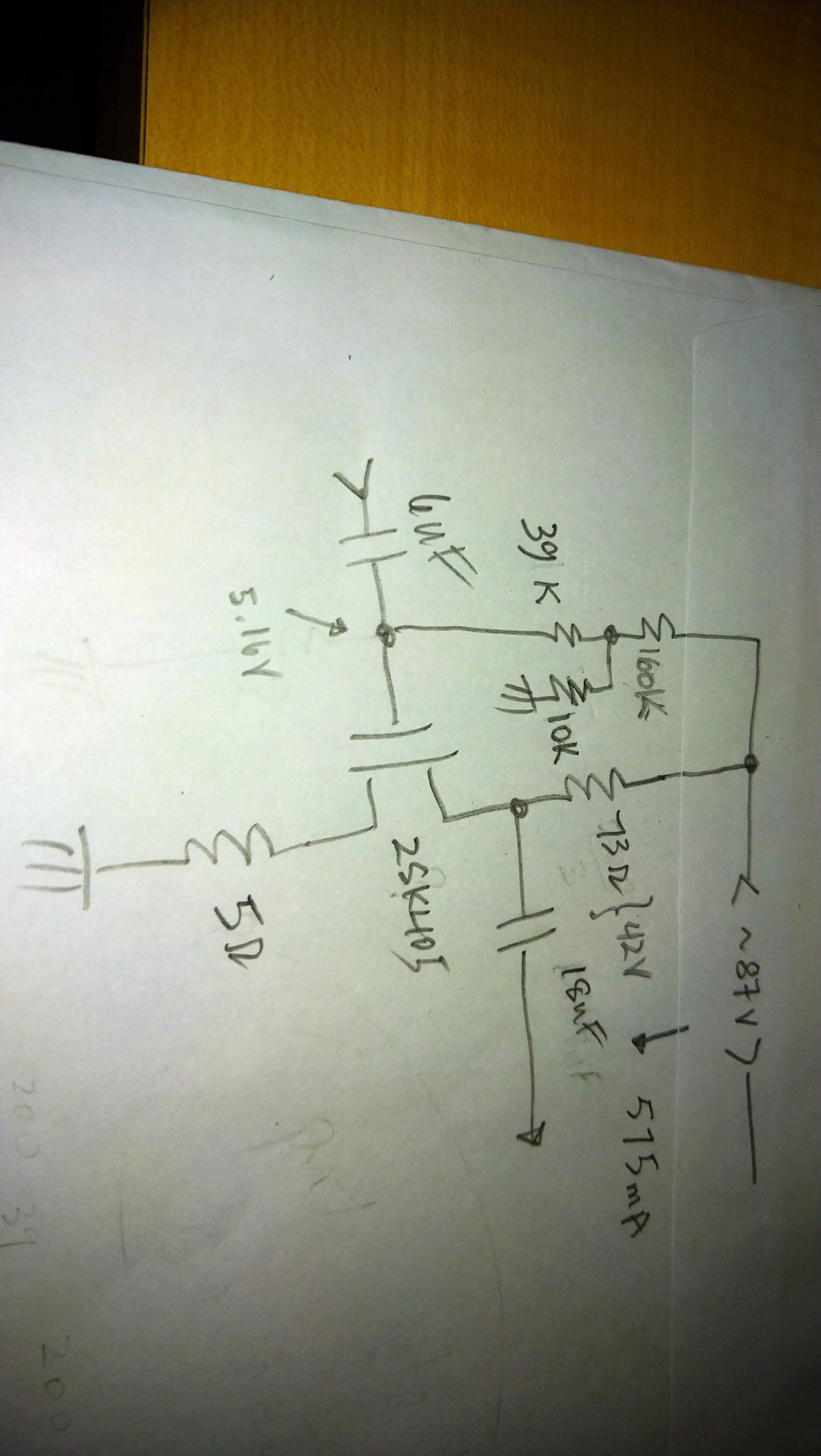

I built a single power JFET(? may be it was mosfet) class A pre-amp. I will keep looking as I know I have the schematic somewhere. I think it ran about 70W of dissipation.
Sorry, still haven't found the construction article for the class A MOSFET No-NFB pre-amp. I did dig my amp out of storage and I checked some specs.
0.1dB down at 100kHz, +60W of dissipation, 575mA idle current, Vcc= 87V 2SK405
Ah, now I get it: you used the circuit of #10 as a non-feedback amplifier and a non-feedback BJT buffer as a current amplifier.
That's ok. (Safe the local source degeneration feedback in the mosfet amplifier).
Do you have a comparable sketch of this BJT buffer available?
