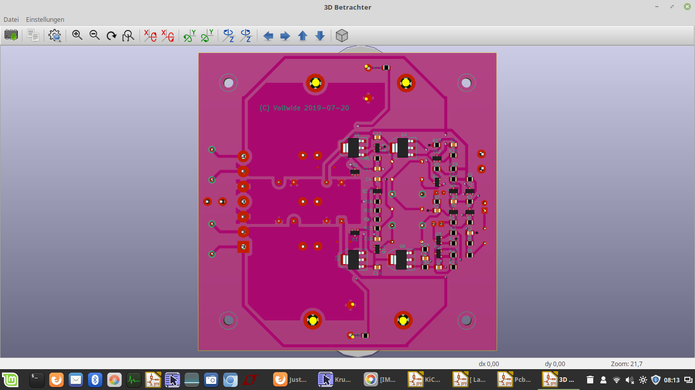

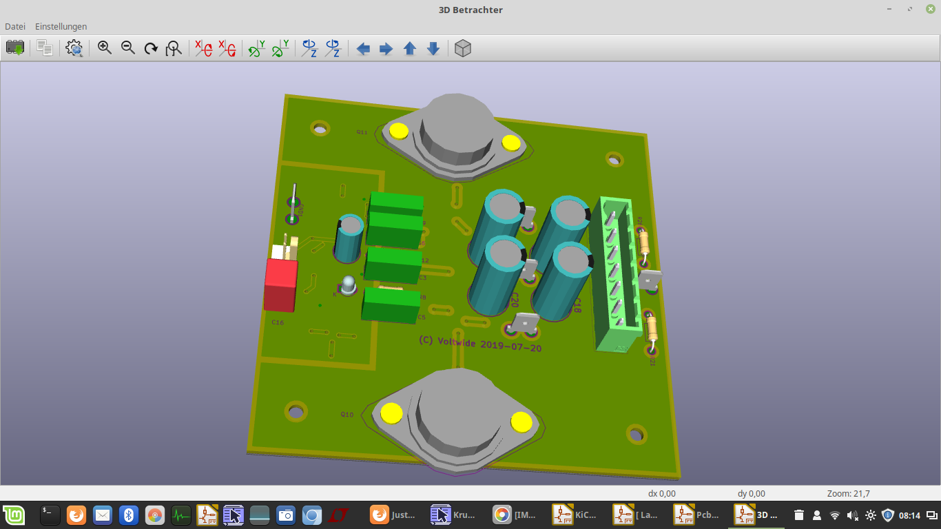

This is not so evident, but nonetheless easy to explain. The pcb will be mounted parallell to a heatsink (200*300*20mm) in a short distance of approx 10mm. Each TO-3 will be mounted onto an alu profile 50*100mm, 3~4mm thick. This will be mounted on a massive alu rod (10*10 upto 20*20mm, 100mm long). The resulting heat conductor will be screwed to the aforementioned big heatsink (I have just a pile of them, stored since the eighties)

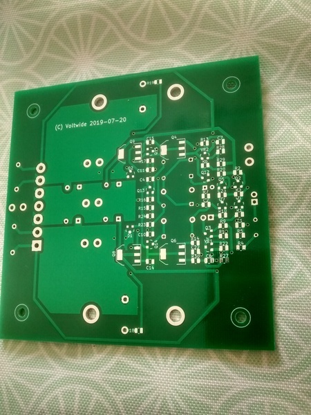

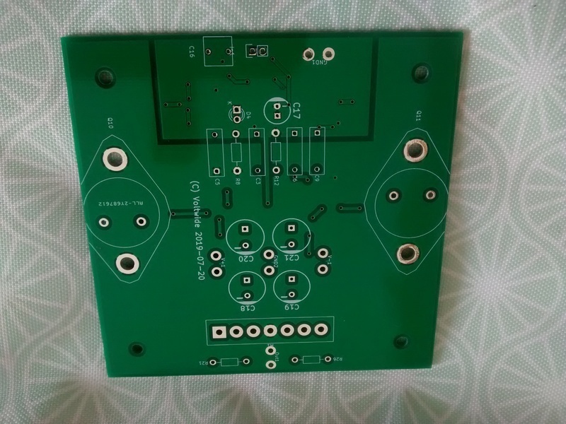

After a lot of hassle with AllPCB, DHL express and the customs I finally received the PCBs. As a result AllPCB now is on my personal "ignore list".
