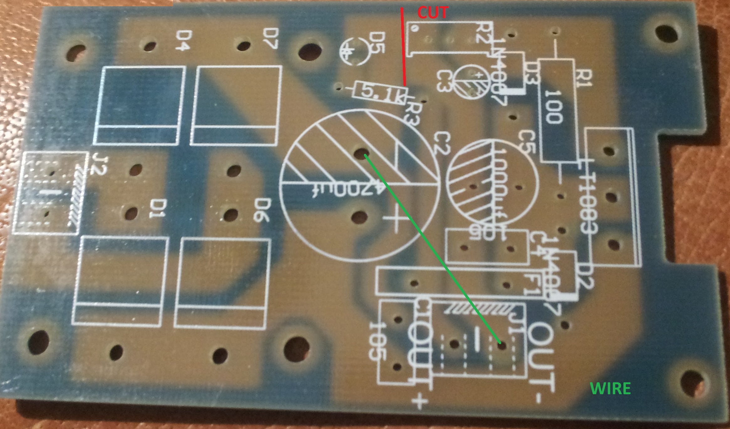

I got the LT1083 regs today, don't have time to put them together now, but I checked them compared to the datasheet for LT1083 and this page:
http://www.tnt-audio.com/gif/schem_lm317_layout.gif .
Seems the ebay kit is like the circuit on the left, which is a bad layout, on the right is the better layout:
So, thinking of cutting the pcb track and wiring it differently, see pic, use a bigger Cadj, maybe 47uF, 25uF is recommended in the datasheet for ripple at 120Hz, and maybe not use the ceramic cap on the output pin.
Anything look/sound wrong?

It all looks terribly wrong to me. Shown is an LM117, not a LT1083. Where is the diode bridge to rectify the AC? What purpose are the 1 ohm resistors?

Why 'fix' something that's not broken? The pictured circuit is solely with creating an intended regulator output impedance (according from the page it's on). From what I understand, that's not an issue with the LT1083
Sorry, link was wrong, this is right:
Simple Voltage Regulators Part 2: Output Impedance
It explains the circuit. The 1 ohms just simulate ground wire. So probably not such a big difference, but I'd like to get it done right. If you check the datasheet:
http://cds.linear.com/docs/en/datasheet/108345fh.pdf
You'll see the same recommended layout on page 12, Figure 2, its not just for lm317.
And I agree, if it aint broke, why fix it, but I cant help myself, when I know just a few small changes should make it better.
