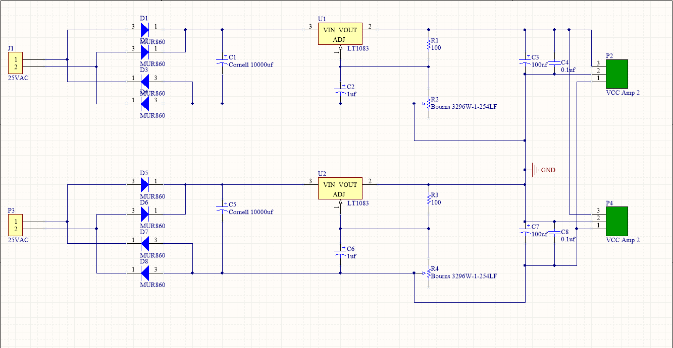

For this I've gone with a LM3875 Gainclone copy (two mono boards each amp), with a regulated power supply fed by a high-quality toroid. Budget per amp is ~$350 each, which off a rough estimation I will be able to come in under (especially given I already have a heap of high quality caps, metal film resistors and most generic components - RCA/IEC jacks, speaker binding posts, etc).
First design step is the regulated power supply. Trawling through the internet I've come across a few different examples and decided on a circuit using two LT1083's, fed by a MUR860 bridge. It's probably not the cheapest or easiest way to do it, but all the parts are available locally. I'm using a 2x25v toroid, either 300 or 500VAC (thinking I will go with 300 as 500 is probably overkill).
Can anybody see any issues with this circuit?

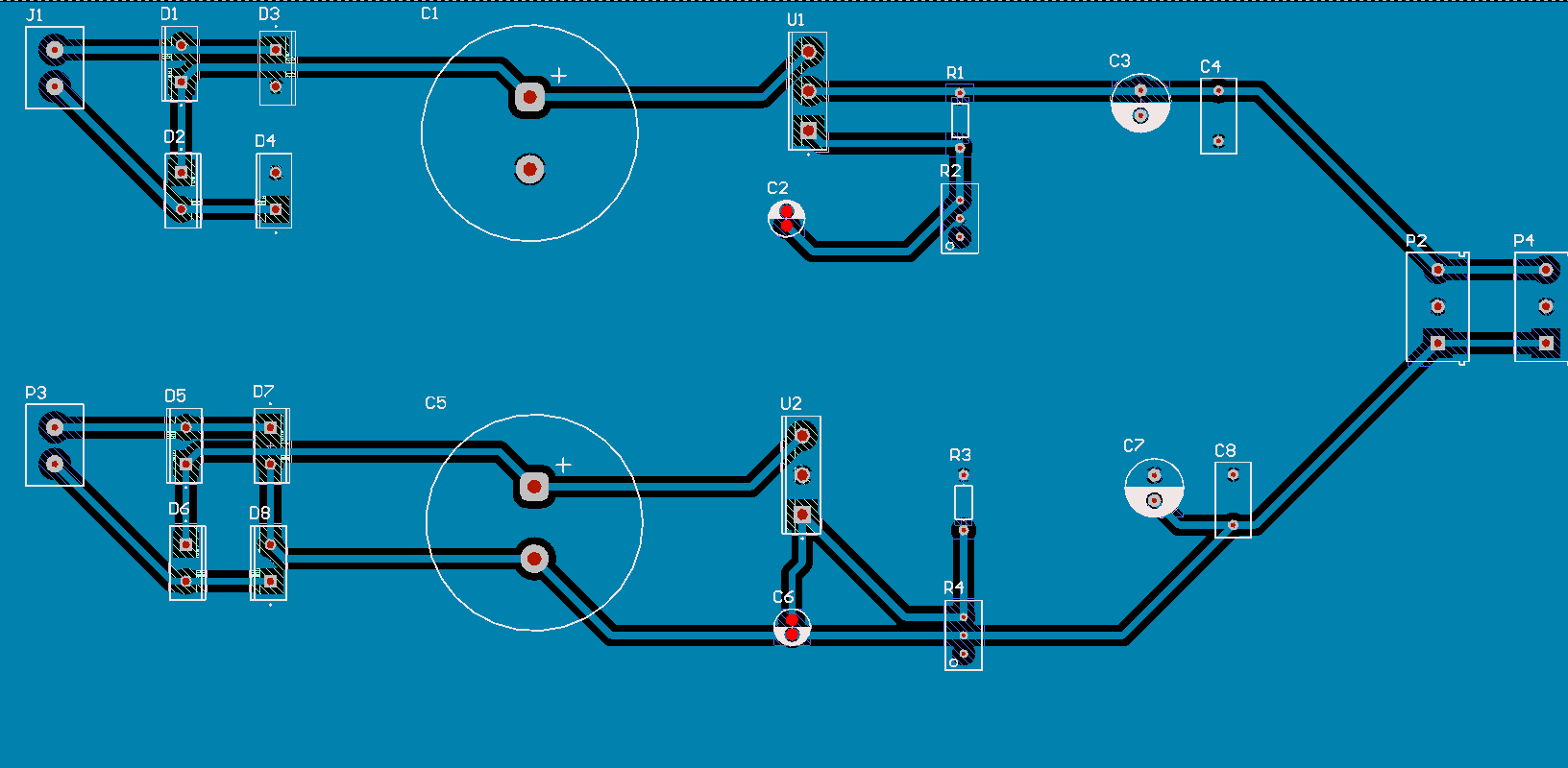

Now for the PCB, I've got access to a desktop CNC so I am going to attempt to cut it with that. Tracks are super wide (1mm), as they will lose width with a v-bit. The board has been ground filled for ease of cutting.
Any feedback or suggestions so far?

I was just reviewing the LT1083 datasheet from Linear Technologies. I had not noticed before, but it CLEARLY states that the MAXIMUM input voltage is 30v, which will limit the output voltage to ~ 29 volts. That's not enough to take full advantage of the LM3875 chip---it needs +/- 35 volts. I wonder if there is another regulator that will do this??
That is the maximum voltage differential from input to output. The input voltage can be higher.[/QUOTE
The data sheet says " the devices are guaranteed
to withstand transient input voltages up to 30V. For input voltages
greater than the maximum operating input voltage some degradation of
specifications will occur."
This seems to be regardless of the input-output difference, doesn't it?
I do not see that in my datasheet.
http://cds.linear.com/docs/en/datasheet/108345fh.pdf
This one only quotes the I/O differential.
Since the reference terminal is lifted above ground by R2, the device does not have the full input voltage across it. You can change R1 and R2 to have the input to reference terminals no higher than 30V and still get higher output voltage since the dropout is under 2VDC. You can also use a zener diode to lift the adjustment pin as long as the Iadj will be enough current to get the zener to turn on. You can bypass the zener with an electrolytic cap to keep the noise down.
On the fixed output LT1083's you ground the adjustment terminal and have a fixed output. The variable version you lift the adjustment pin via a resistor or Zener as part of the voltage reference for the voltage you choose. That is why you can go above 30VDC on the input. The adjustable units need two resistors or a resistor and zener for setting the output voltage.

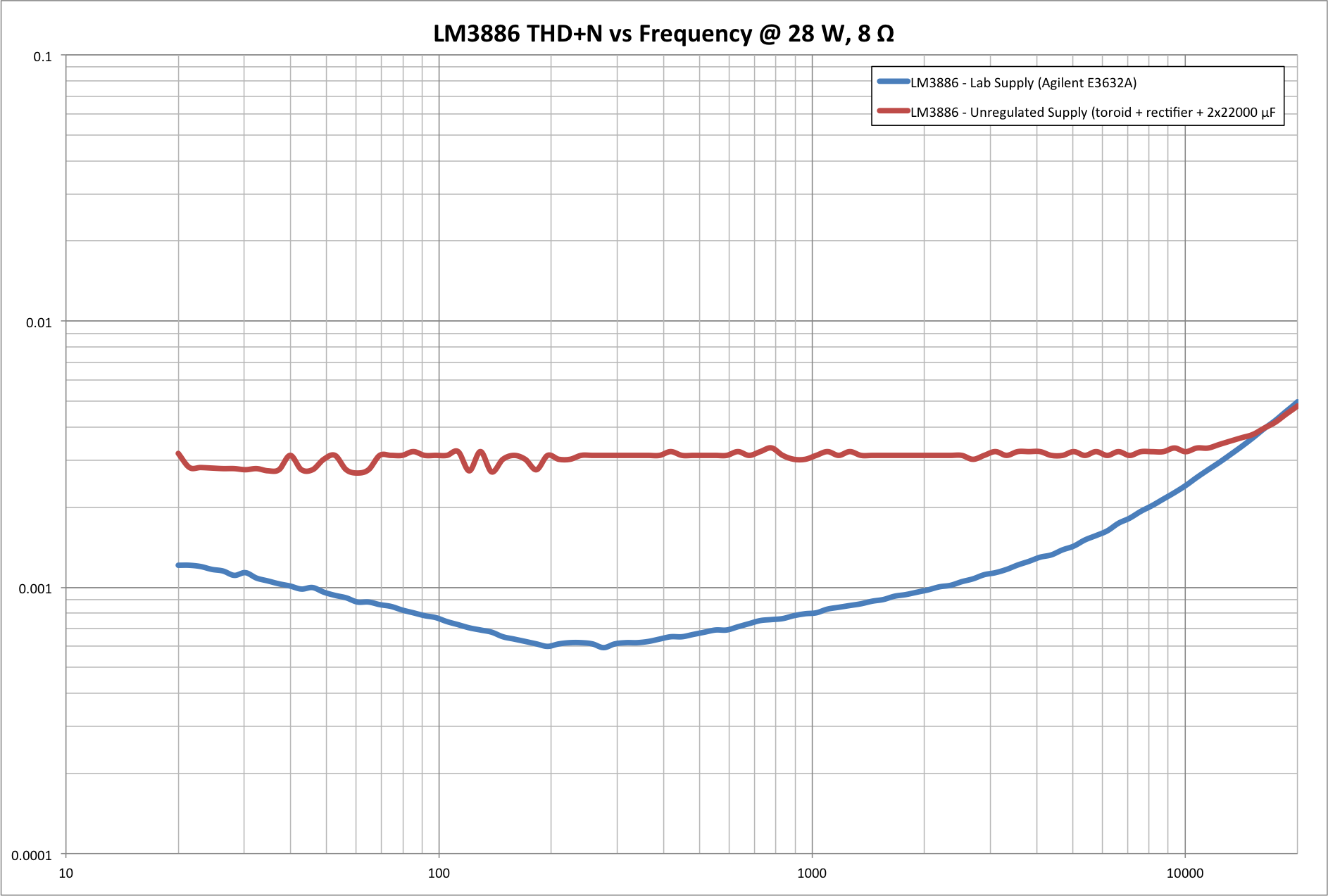

I also was wondering exactly WHAT improvement would be gained by having a regulated power supply for a gainclone amplifier? I don't recall seeing this in any of the other designs I've seen...???
You won't hit the data sheet performance of the LM3886 without a regulated supply. That's due to the power supply rejection ratio of the LM3886.
There are two ways around this:
1) Use a regulated supply
2) Use a composite amplifier architecture
I chose Option 2 for the Modulus-86, but either approach is valid.
You can see the THD for the LM3886 in an optimized layout with a regulated and unregulated supply in the attached plot. The THD was measured with an Audio Precision SYS-2700.
Tom
