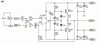

I'll refer back to the discussion on Rod's headphone amp again- There is frustratingly little ability to dial in the bias current in Rod's design (attached below just for quick reference), he just depends upon the 1N4148 bias diodes D1 and D2 to have a slightly higher forward drop than the transistors, and has some adjustability with R5/R6 to set the diode current, keeping it above about 2mA. I am unsure how the 1N34A forward drop compares to that of the output transistors- that will be important to breadboard and check very early. With respect to the emitter resistors R8 and R9, in Rod's design he indicates that the 10 ohm values can be increased as high as 22 ohms, it will reduce the available output power but won't affect output impedance, but will reduce the amount of current that can be drawn by the load. I can attest that with the 1N4148 devices for bias on these BD139/140, and 10 Ohm emitter resistors there is LOTS of power, and zero (audibly) detected crossover distortion. Again, your mileage may vary- I'm interested to know how the 1N34's do. At least you have the option of increasing the emitter resistors if needed to reduce bias current. I also assert that the output devices only really need to be slightly on to eliminate crossover distortion, because the op-amp has such high open loop gain and fast slew rate it can cross a small dead gap without it being audible. I prefer the devices be on a little further, maybe at least 10mA? bias current, but any more than that seems just a waste and can cause thermal problems. I like the battery powered idea, so less is more when it comes to this quiescent current.

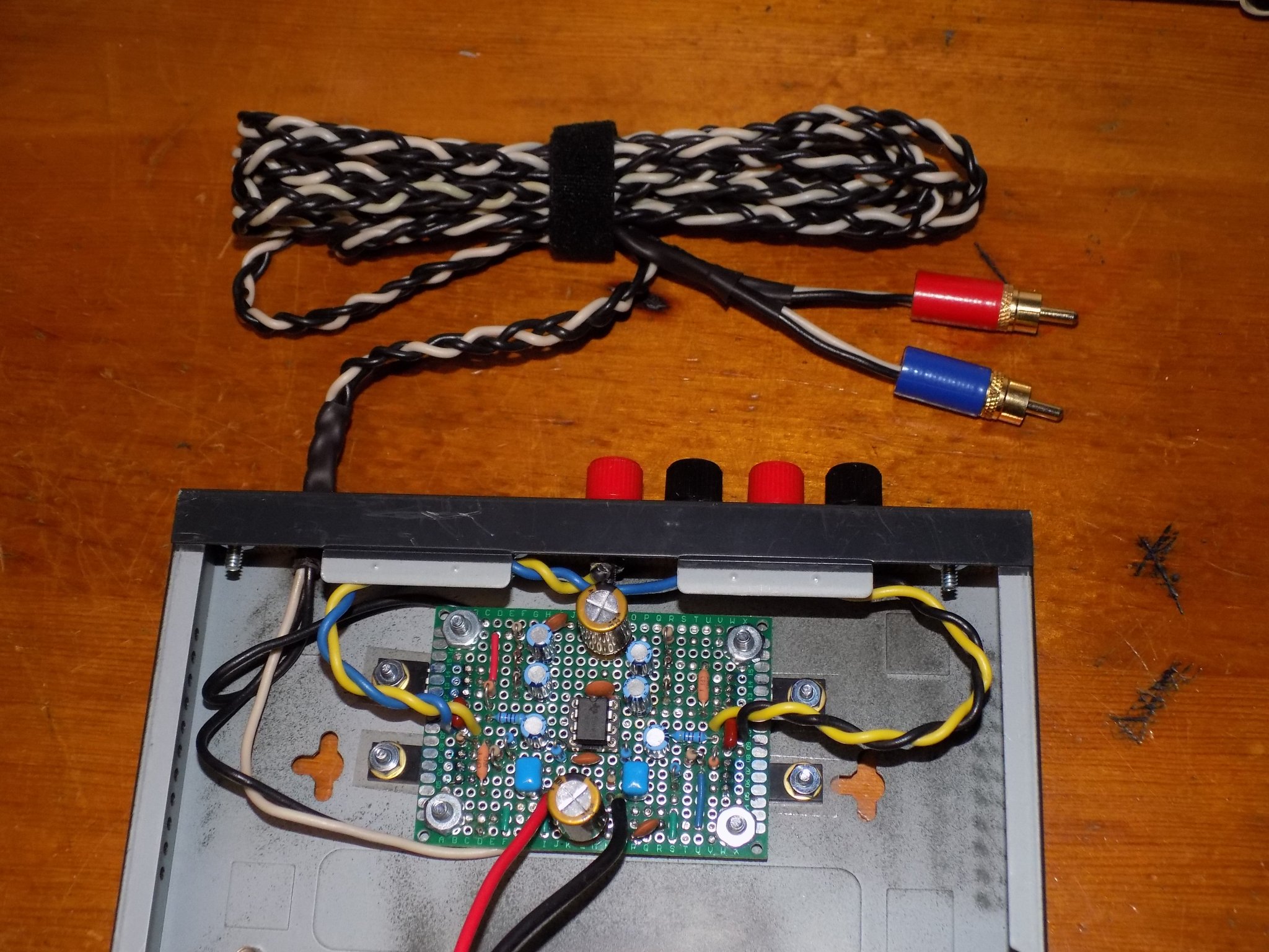

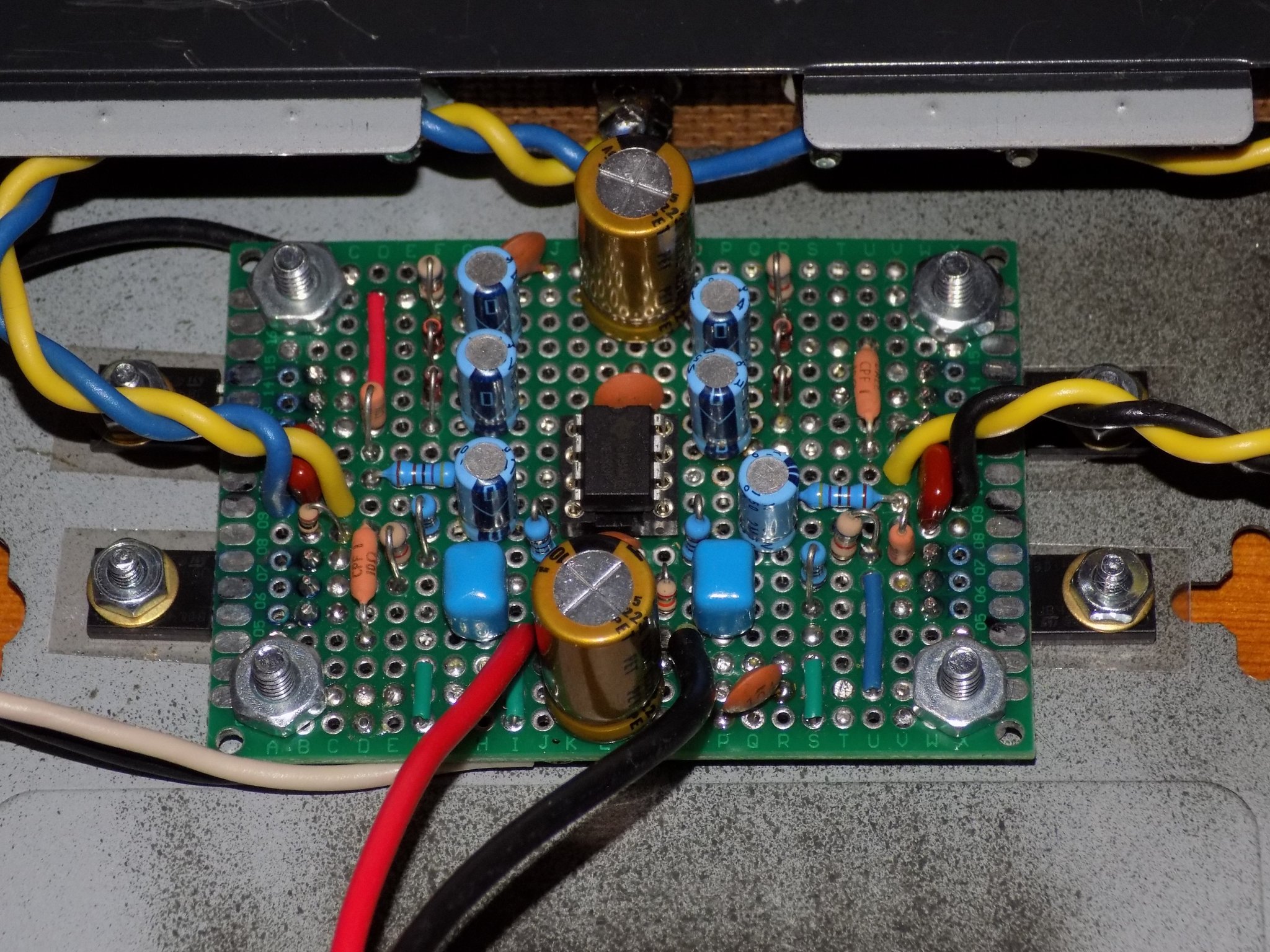

When I built my copy of Rod's design I went straight to proto/vero board. I was a little spooked about oscillation, and the design was so mature only minor revisions if any would be needed in the future (likely just the feeback gain resistor). I have included a bunch of photos below.
First, my build of the 113 headphone amp in an old metal router box. It was a prototype (of my layout), and wanted to be able to drive small speakers with it hence the binding posts. Shown also is my braided vacuum cleaner wire power lead with color coded RCA plugs. I did not like the requirement for a vertical heatsink so I attached the transistors to the underside using the box as the heatsink. BTW the little brown resistors are the 10 Ohm ceramic 1W if you can believe that, no bigger than 1/4W carbon. I used them for the Zobel as well. I did not have room for big resistors in this layout.

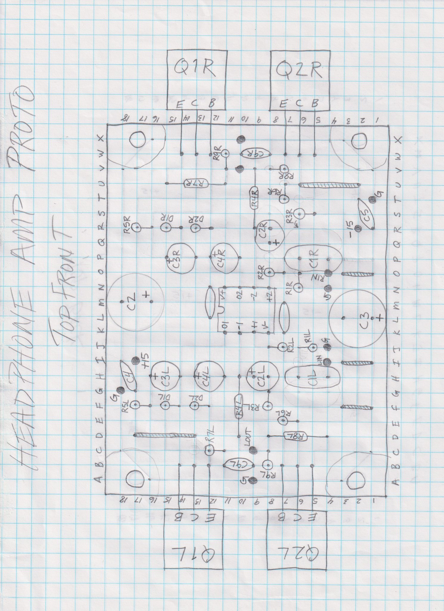

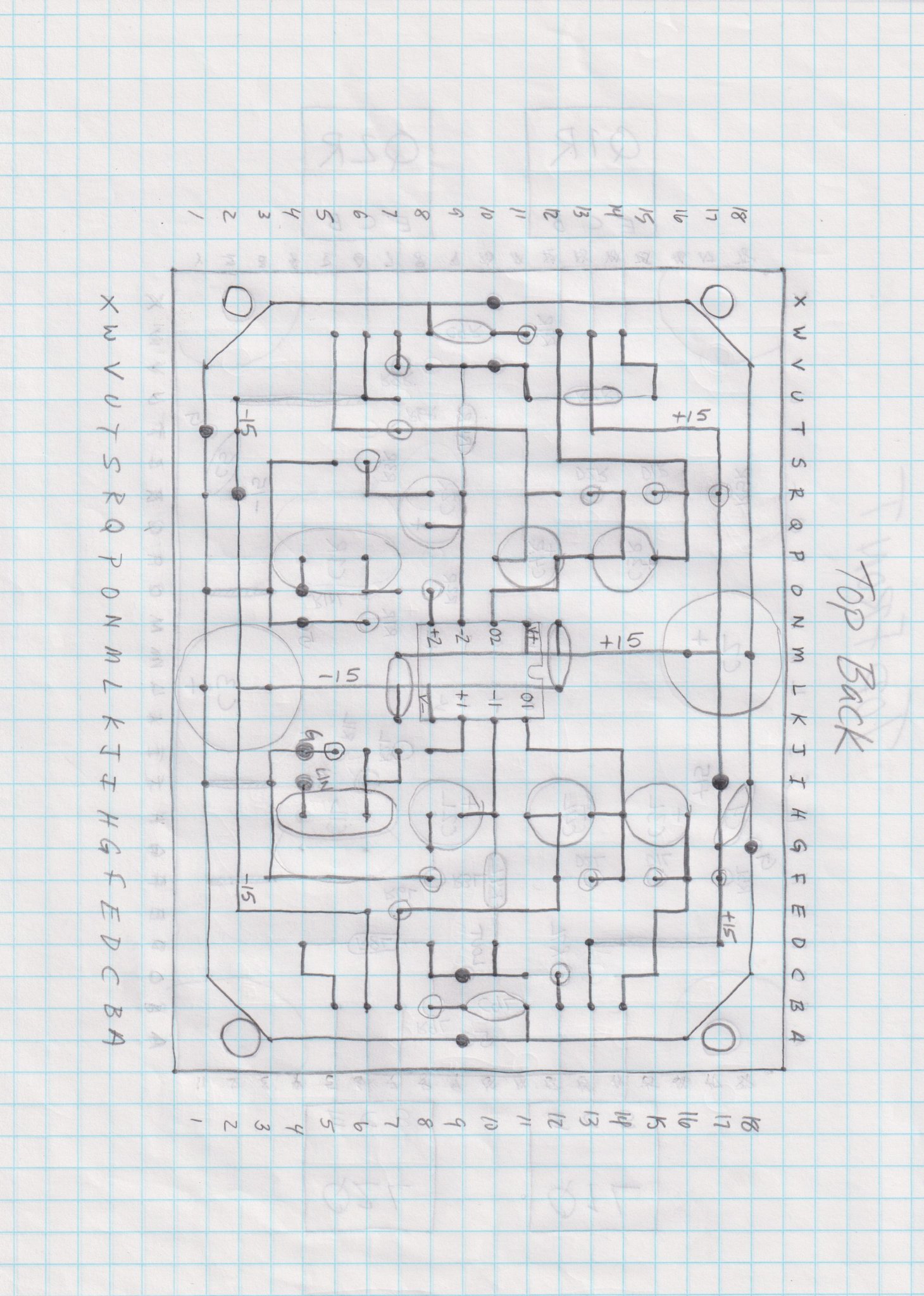

Here are the layout sketches I did on grid paper if you are interested. I was trying to be extra careful about out to in coupling yet I made it pretty dense. Ground ring around the outside, +/-15V in the center, opposing outputs with fairly good mirror symmetry. It works great, no oscillation, extremely clean, tons of power for a headphone or small test amp.

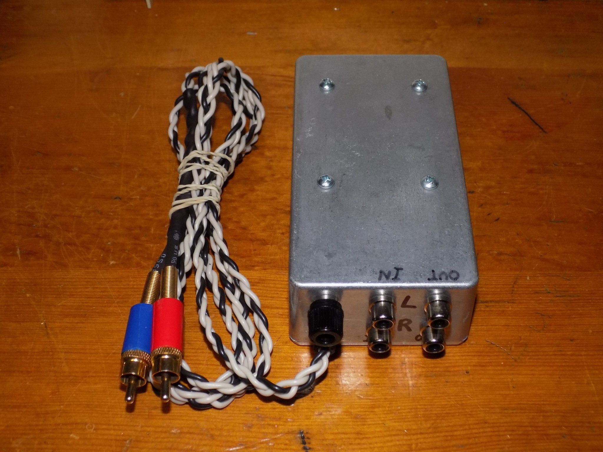

This is my ESP project #06 RIAA Phono Pre-amp using the same braided power lead. It's an exceptionally good phono preamp design he has there- Far superior to any of the typical one-op-amp designs. An interesting and informative read for sure.

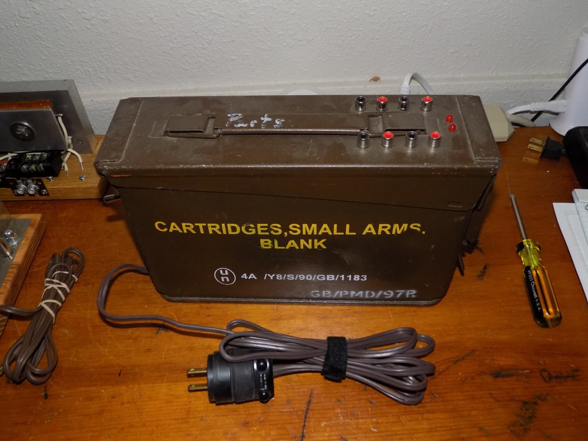

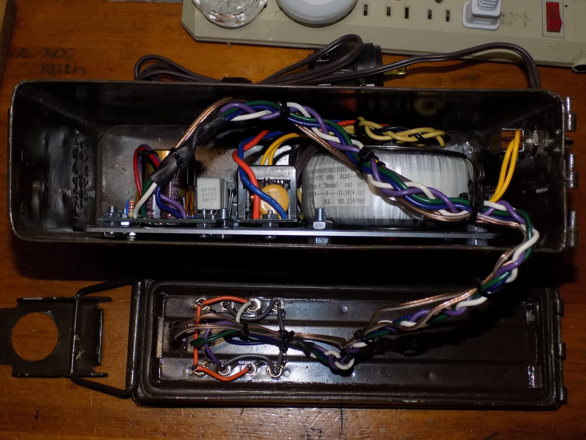

Here is my ammo can +/-15V @ 1A power supply. I was lucky enough to have a medium size 14V-0-14V toroidal transformer from a computer subwoofer and most of the other parts in my junk box. The entire supply is built on a thick aluminum plate that was slid down into the box and bolted through the side of the box. Loosely based upon ESP project #05 as far as the LM338/LM337 setup with protection diodes, with the regulators heatsinked to the big aluminum plate. I broke the bulk bypass capacitors into a smaller first bank, and larger second bank with spare ceramic emitter resistors adding up to 1 Ohm between the two banks to help reduce RMS current from the transformer (hum and heating), inrush current, and greatly reduces ripple going into the regulators. It's super clean and quiet. It has two power LED's so I can verify both supplies are up, and can run 4 op-amp based accessories at a time with no worries about shorting outputs. (Just need to make sure everything is off, and plug red into red etc . . .)

Your 113headphone amp build looks really clean, I really like the quality of your hand drawing and the protyping board looks like a very well executed build. The ground ring around the parameter of the board likely lends to a very clean sound quality. I see no reason to develop a PCB, based on the stability of your build. 👍

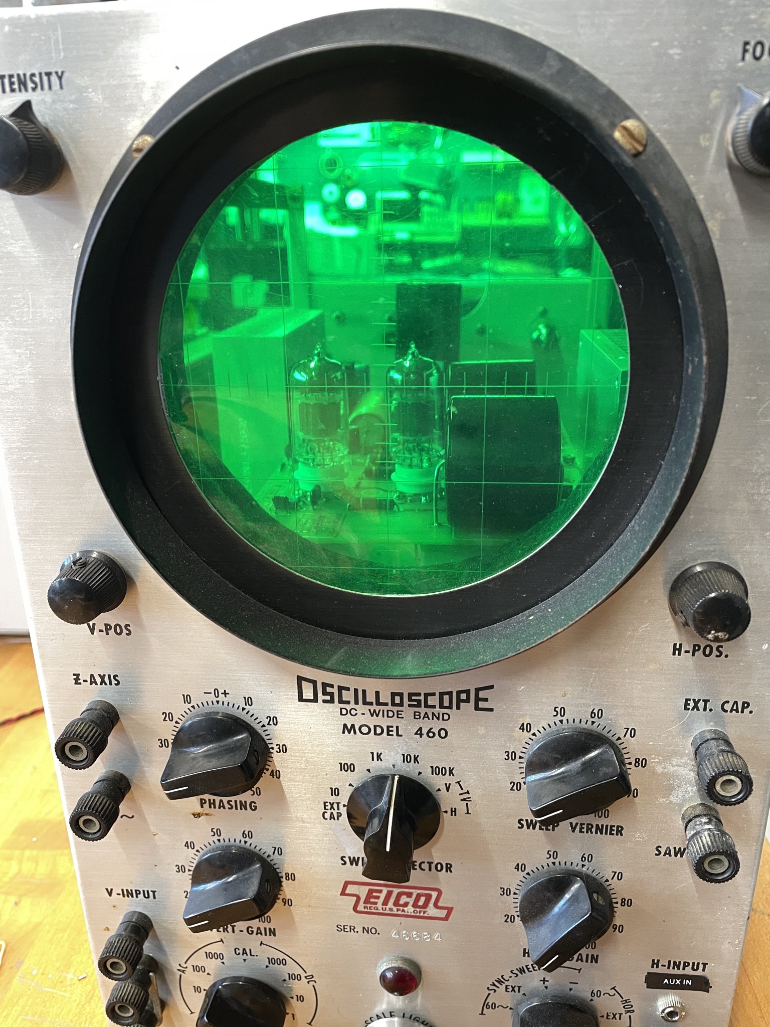

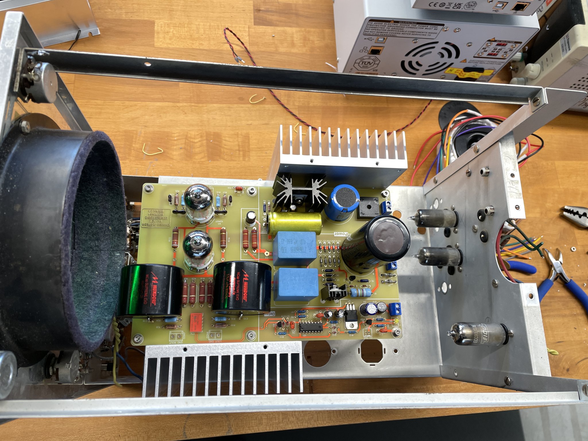

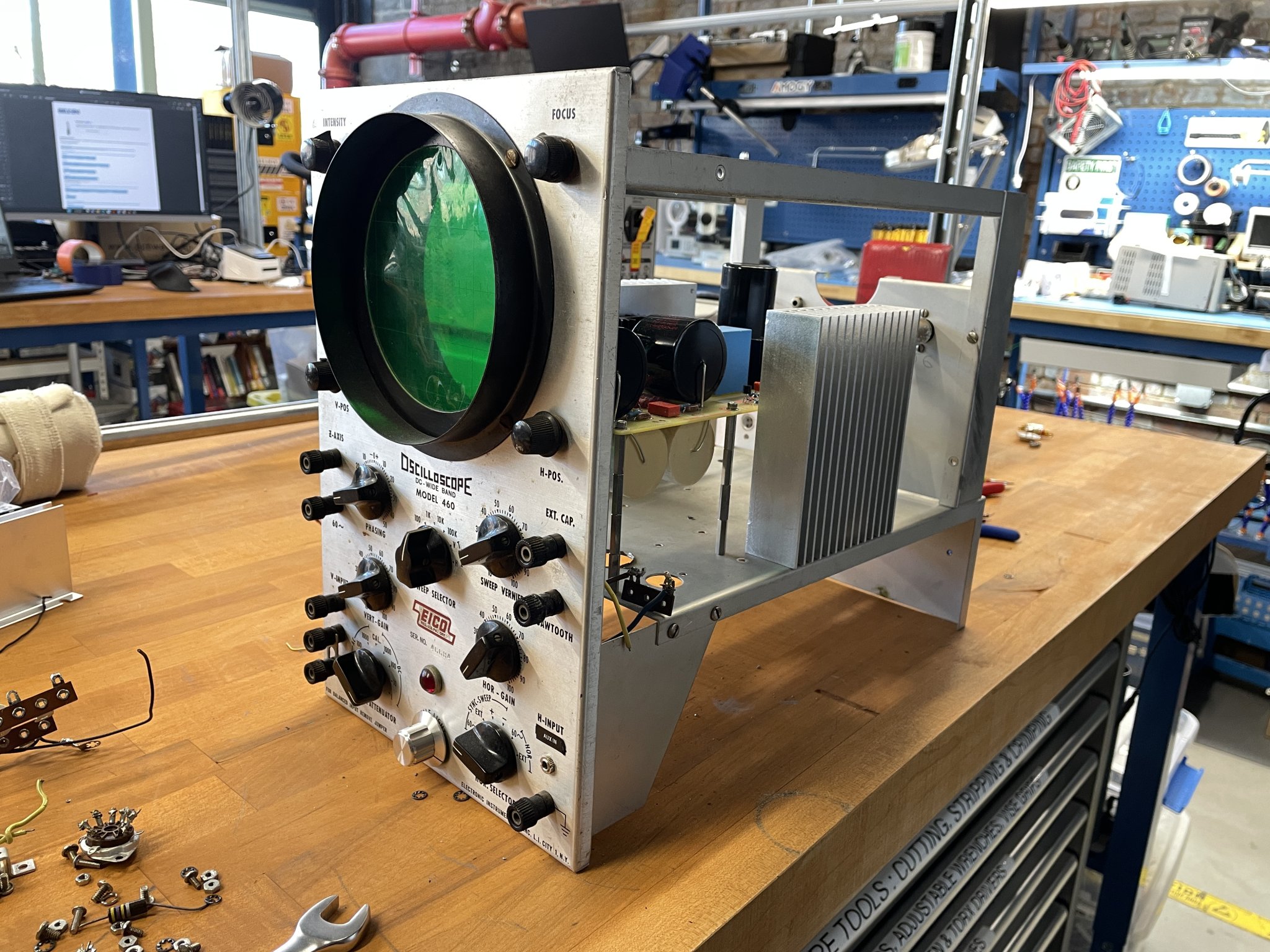

I have an interesting build worth noting:
This is a "Conrad Johnson PV-12" 12AU7 preamplifier kit and 2x JLH1969 10W 2N3055 amplifiers. Of course, it has been stuffed into an old EICO O-scope.
Reactions: rediceman
