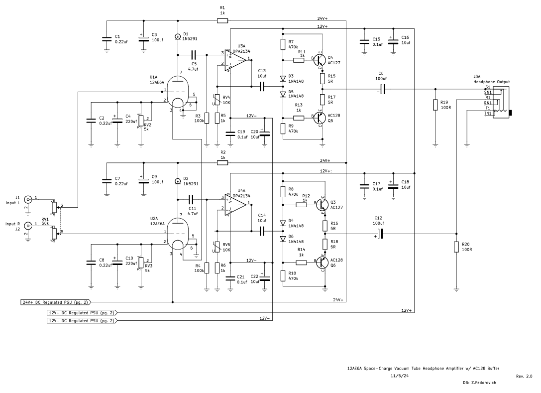

I would include the output section into the op amp feedback loop.
That would leave only tube sound.

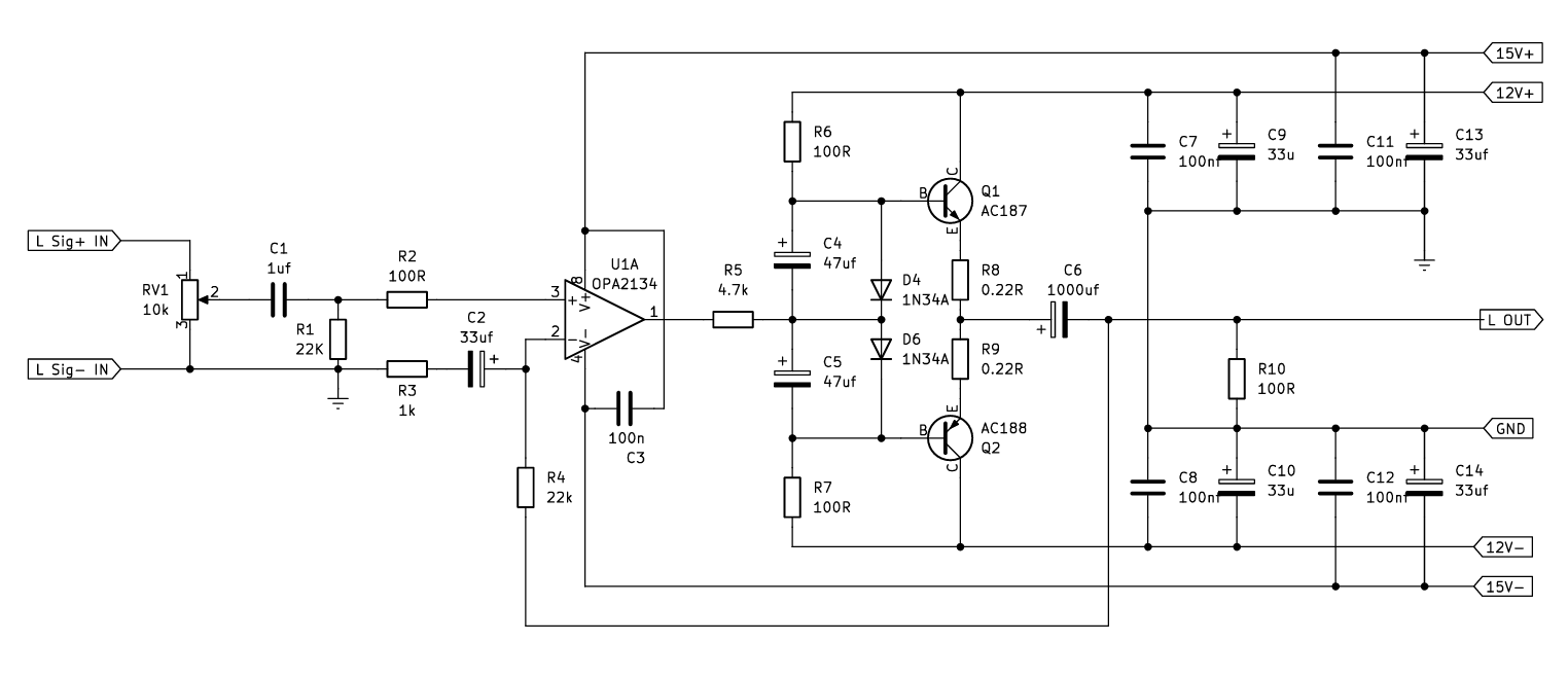

I am liking the simplified version. Sorry it looks so much like ESP's headphone amp but with germanium, but it's a classical topology that works well. I am enjoying our conversation so I would like to touch on a few points for academic purposes at least (since this is your final version)
I'll refer back to the discussion on Rod's headphone amp again- There is frustratingly little ability to dial in the bias current in Rod's design (attached below just for quick reference), he just depends upon the 1N4148 bias diodes D1 and D2 to have a slightly higher forward drop than the transistors, and has some adjustability with R5/R6 to set the diode current, keeping it above about 2mA. I am unsure how the 1N34A forward drop compares to that of the output transistors- that will be important to breadboard and check very early. With respect to the emitter resistors R8 and R9, in Rod's design he indicates that the 10 ohm values can be increased as high as 22 ohms, it will reduce the available output power but won't affect output impedance, but will reduce the amount of current that can be drawn by the load. I can attest that with the 1N4148 devices for bias on these BD139/140, and 10 Ohm emitter resistors there is LOTS of power, and zero (audibly) detected crossover distortion. Again, your mileage may vary- I'm interested to know how the 1N34's do. At least you have the option of increasing the emitter resistors if needed to reduce bias current. I also assert that the output devices only really need to be slightly on to eliminate crossover distortion, because the op-amp has such high open loop gain and fast slew rate it can cross a small dead gap without it being audible. I prefer the devices be on a little further, maybe at least 10mA? bias current, but any more than that seems just a waste and can cause thermal problems. I like the battery powered idea, so less is more when it comes to this quiescent current.

For the resistor values chosen for R8, R9 of 0.22R: The circuit's quiescent current is determined by the voltage across the diodes (1N34A) and emitter resistors (R8 and R9). Increasing R8 and R9 from 0.22R to 10R would drastically reduce the quiescent current, likely introducing significant crossover distortion. The value should be correct, but it could be increased to around ~0.47R to slightly increase thermal stability, while minimizing crossover distortion.
Neither the op-amp nor the output transistors can tell the difference between +/- rails with ground bias or a single ended supply with a virtual ground. If your R1 were tied to a well bypassed virtual ground divider at VDD/2 and the supply single ended, (and your output cap back in place after feedback) no other changes would be necessary and the op-amp and output devices would behave exactly the same with no clue. The op-amp would drive the final output to VDD/2 to keep the V- input the same voltage as the V+ input. (the advantage of DC feedback and using an op-amp) The output transistors would have no clue and no change to their operating points would occur. The relative voltage differences between their terminals would be identical with the output sitting at VDD/2. Again, I'm a "minimal capacitors in the audio path" kind of guy, so I did not mind building a supply twice as complicated to be able to eliminate them. The output will be at ground in your design, no question. The op-amp will use the full force of it's open loop gain to guarantee that, so long as your output transistors do not rail and saturate at one extreme because of some major imbalance problem.As for the power rails, I've worked on worse things. They could run on 12V+ with a virtual ground at mid supply, This could be done. However, the AC187/AC188 output stage relies on symmetrical voltage swing for proper biasing and thermal stability. A single-ended supply shifts the quiescent bias point to 6V instead of 0V, affecting how the transistors operate. If the Germanium pair needs +/- rails, why not do the same for the entire circuit? The OPA2134 could run on 9V+/-, but it may reduce dynamic range a little bit on high energy passages if the amp is driven hard.

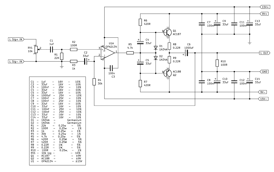

There will be no voltage on the output, guarantee it.Here's the simplified version, If there's little to no DC voltage at the output, we can omit C6 and R10. I think at 9V+/-, the Germaniums should remain stable with adequate heatsinks and thermal drift leading to any DC bias getting through should be no concern.
We can power the gain and buffer stage on shared, decoupled rails. This may increase crosstalk a little bit, but I don't think it would be too noticeable.
Given the simple power supply, this could easily be a portable AC or battery powered headphone amp
Yes, you can power both stages on the same supply. Rod indicates an unregulated supply can be used, but does not recommend it (I think) just because some who build the amp will use the high gain value and I expect some hum would be possible. Rod seems more concerned about the non-linear current consumption of the output stage messing with a possible upstream pre-amp. Fortunately the op-amp has really excellent power supply rejection ratio, and even if there were relatively large ripple on the supply rails, the op-amp would just drive the outputs harder at times to compensate and still manage to produce a low noise low distortion copy of the input. Ripple is well within the pass band of the amplifier so it should be as easily cancelled as the signal amplified.

@stocktrader200 The output section already has a feedback loop to input of the Op Amp. This actually makes the circuit more linear and reduces distortion. Depending on the resistance in this network, it can retain or reduce some of the 2nd order harmonic distortion that many people liken to “tube sound”. My opinion is that Germanium designs do not sound like vacuum tube designs, although they both share some common distortion and soft clipping characteristics.
