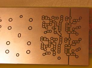

No one has mentioned anything regarding my PCB at all, does this mean it looks okay? Or no one has looked it over 😀 I can understand that as its a pain to do. But I would appreciate it greatly if someone could, someone who knows how its supposed to be wired up. Another set of eyes are far better then just one, and may pick up on something that isn't correct.

5th element said:1) Is my PCB layout good enough?

Hi Matt.
I'm checking out your layout now and the only mistake I see is that the polarity marking of D2 is wrong. The stripe should be facing left not right. You probably installed this part the correct way on your board but check again to be sure. The right half of the board isn't routed as well as the left half of the board is but everything else is connected correctly from what I can see. Are pins 1, 5, 8 of the op amp tied to ground or are they left floating?

the sensing bridge measuring the output and feeding the opamp inputs is not well laid out. I suspect this is not the cause of your problems. You do realise this is a bridge? Both sensor ends of the bridge must go to the outlet connections.

One other thing in the startup process: The non-inverting input of the opamp must have higher voltage than the inverting, if not the opamp won't lift itself in it's hair. This can be especially tricky if you use a LM431 as reference and don't pay attention for voltages under the set reference voltage. If you want 5 volts out you may use a LED (instead of the zener) as voltage shifter at the opamp output.
Hi Janneman,
the bottom ends of the measuring bridge are both terminated on the ground plane. Could this cause part of a sensing/oscillation problem?
5th,
the bridge sides are Vsense to r8+r9 to 0v sense and Vsense to r5+u10 to 0V sense.
The two junctions allow measurement of the difference and are monitored by the opamp input pins. That bridge should be kept completely independent of any contamination from other parts of the circuit. The V sense and 0V sense at the top and bottom of the measuring bridge should be taken to the final outputs feeding the downstream circuit.
Could you cut the ground plane top to bottom under the opamp? and then return pin 4 back to the left hand side?
I note that pin 1 and r9 ground have the same symbol. Are these both connected to ground? What about pin4? it looks like the unterminated pins 5 & 8!
5th,

The ground plane is cut on the PCB, see attached picture, all the 0v sense parts are connected to the RHS copper. The components connected to power ground, in the schematic, are attached to the LHS copper.
The unused pins of the opamp are not connected to anything, that would be pins 1,5 and 8. Pin 4 solders to the LHS power ground copper.
How do you recommend I wire this up for testing? At the moment, I've made one small join between LHS and RHS copper, and connected V sense directly to the output.
AndrewT said:
Thanks Ill look into it.
When you test you don't have to worry about the sensing function. Just short them on the pcb. You may also start without a preregulator AND taking the supply voltage for the opamp from the raw voltage. If it then works the basic circuit works. If you then move the supply voltage then you'll have startup phenominas and stability issues. Ideal conditions for the opamp is when the output voltage from the opamp is about half of the output voltage. It should be at least well within the opamp's limits which is 2 under supply voltage and 2 volts above ground.
Start to use a rather average opamp in speed. OPA134 is OK and the pass transistor could be BD139 if you don't have D44H11. A slow transistor like 2-4 MHz is not a good idea to use.
If you use AD825 you will have a perfect pcb otherwise you'll have oscillations. If you'll check ALW's boards you'll have an idea how it could look like. Check his starground concept. My pcb is smaller and uses a groundding concept similar to stargrounding.
AndrewT said:Hi Janneman,
the bottom ends of the measuring bridge are both terminated on the ground plane. Could this cause part of a sensing/oscillation problem?[snip]
Well, so far we have no clue what the problem is, don't we? Why going around in circles speculating (unless you enjoy wasting time as inefficiently as possible)?
Just measure, and get it fixed.
Jan Didden
