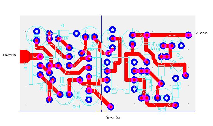

First I should start off by saying - I know this circuit is very sensitive to layout and I pretty much went at it with total disregard for adhering to any specific layout rules(because I designed it before I read anything -.-). However the goal was to keep it relatively compact, so all traces are quite short. The PCB is double sided so the topside is used for ground.
What I am about to say may be complete drivel and I am sure someone will enlighten me if it is. I am assuming, that even if the circuit layout is 'bad' it will still work, even if the max potential of the design isn’t realised.
What I have built is electrically sound, in that all the components connect to all the right places. At least I 'think' it is, I checked the PCB layout against ALWs circuit 3-4 times before etching and then, having constructed the thing, probably agonized over it half a dozen times more – I can see nothing wrong.
FWIW there are 4 regs powering a DAC, running at +12 +5 +3.3 and -12V. From what I gather, as this is using the same ground plane, the '0v' sense points are basically not used and all the ground points are connected to the ground plane.
I have designed the PCB so that there are separate 'islands' for different grounds. One for power ground, one small one for digital ground and then another for analogue ground. Essentially all the ground points (on the ALW diagram) NOT listed as the '0v' sense point are soldered directly to power ground. Then all the points listed as 0v sense are soldered onto the ground plane the regulator circuit will be powering. The idea here, that I could use the sensing function of the circuit and take wires from the different ground planes back to the star ground of the case. The different ground areas are close together so they can all be connected together without any hassle. From what I understand this is not quite how the circuit works, so the analogue and digital grounds were connected to power ground.
I am using a 2.5V reference (LM336Z-2.5) with a 3.3v zener 1N5333B in all the circuits. There was some confusion in the ALW pdf file where the parts list and schematics didn't match up, I have however tried using a 1N5342 6.8v zener, but not a high voltage reference. Regardless it seems the 3.3 and 5v versions are supposed to work from a 2.5v reference and a 3.3v zener.
The resistors used for setting output voltage were all calculated with the standard formula listed in the datasheet for the ALW regs.
Bottom line is once built they do not work.

Bonsai said:Post a picture and your layout - that way we can all look at it and offer some advice.
OK here is a picture of the schematic for a +ve version.
Ignore the polarity of the capacitors and diodes as they were not set when designing the PCB, as I always build things with the component data sheets and schematics in front of me.
The first diode on the left is the LED. I am aware that the orientation of the voltage reference is incorrect, its a diode remember, but its a transistor case, so I thought I'd just mention it. All the transistors have been installed relative to how the PCB is lay out.
Also I have removed the ground plane to make viewing it easier, just assume that if there is anything unconnected, it probably goes to ground.
Many thanks again, I know looking over someone elses PCB can be a headache, but I'd really like to get to the bottom of why this isn't working.
Matt

peranders said:Pin 7 of the opamp, can you tell me where you have connected it on the pcb?
The trace beneath the pin? The output.

My main concern was with the layout, does this look alright then?
