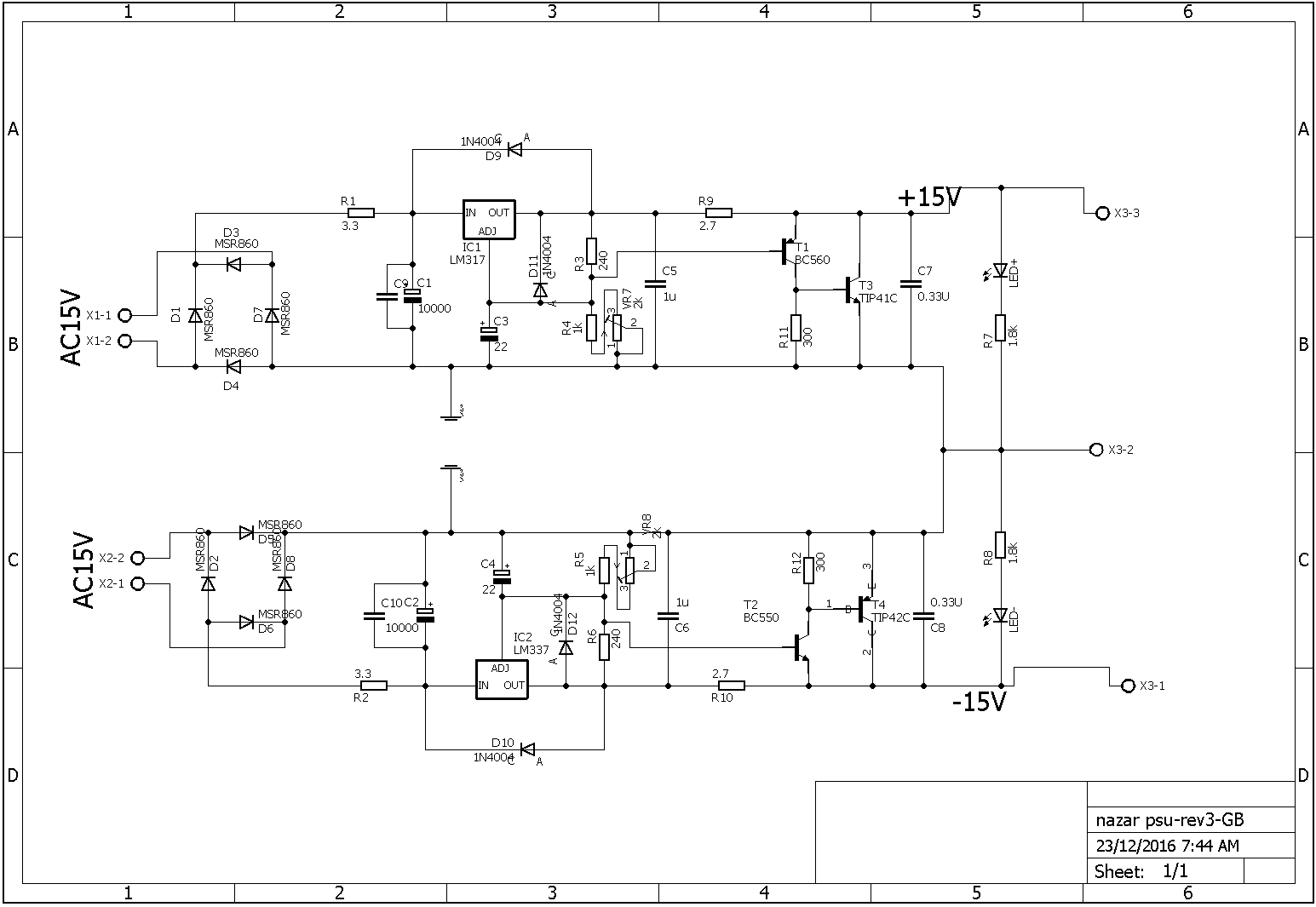

ok so i think i have a 17-0-17 1amp traffo, that will do okay i guess?
Sent from my A0001 using Tapatalk
No, the design calls for a trafo with dual secondaries. Get one from here http://www.torotrans.com/ and go for 50-60VA trafo with dual secondaries.
Thank you.No, the design calls for a trafo with dual secondaries. Get one from here http://www.torotrans.com/ and go for 50-60VA trafo with dual secondaries.
No, the design calls for a trafo with dual secondaries. Get one from here Toroidal Transformers, Toroidal Power Transformers, Manufacturer, Pune, India and go for 50-60VA trafo with dual secondaries.
that design uses a +ve reg and a -ve reg.Thank you.
You can easily alter it (very slightly) to work with a centre tapped transformer.
just remove 4 of the rectifier diodes and add two links to 4 of the empty pads.
as he doesnt have a suitable trafo, its better to go for a new dual secondary transformer. which can be converted to a center tapped easily for other builds in future if required. your post here http://www.diyaudio.com/forums/pass-labs/298369-jumas-head-amp-9.html#post4879724
He already has a suitable transformer.as he doesnt have a suitable trafo, its better to go for a new dual secondary transformer. ..................
The centre tapped will work after making the small modification I gave in my previous post.
Ah my bad, I was under the impression that its 12-0-12 trafo which was mentioned earlier. how i dont know.
