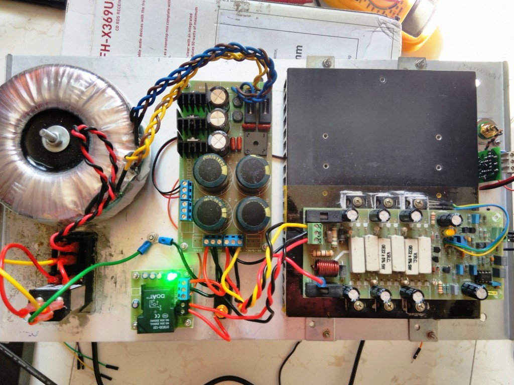

Nice work Prasi. I think this is the first photo I have seen of your actual amps.
Btw, I just finished my JFET source follower amp in stereo. Sounds real nice:
I got the DC offset down to 2mV and stable.
Why have you braided the triplets out of the transformer?
That just increases the emi.
And you have some untwisted wires, again increasing emi.
Everything is quiet with this amp as of now. will twist some more, if needed. it was a quick build for testing the buffer and see if I can use this amp+buffer combo for driving my HT sub channel. I am going to replace the PSU caps with something more robust! 10000uFx 2 per rail(currently they are 4700uFx2). xfr is also a measly 24-0-24VAC 250 VA. will be replacing with 400 VA 40-0-40VAC, to give some gut power.
i am not so skilled +fat fingers🙂 clumsy.
But one thing to note here, the wires are quite short be it power or signal wires + everything is well separated AC mains , AC secondary and DC and signal.

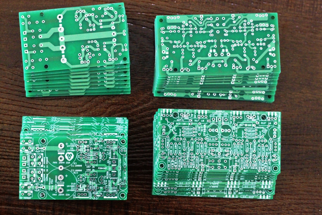

Nice boards! You are going to be real busy mailing them out.
Basic green colored PCBs are still my favorite. 🙂
yes, green is synonymous with anything related to electronics since the beginning.
i am already very very busy with my HT build and Paul Carmody's sprite boombox build (ND-90) + furniture work at home. haven't had time to look at anything else.
I will start contacting people soon.

Finally the wait is over and PCB's are here.
reg
Prasi
Looking good

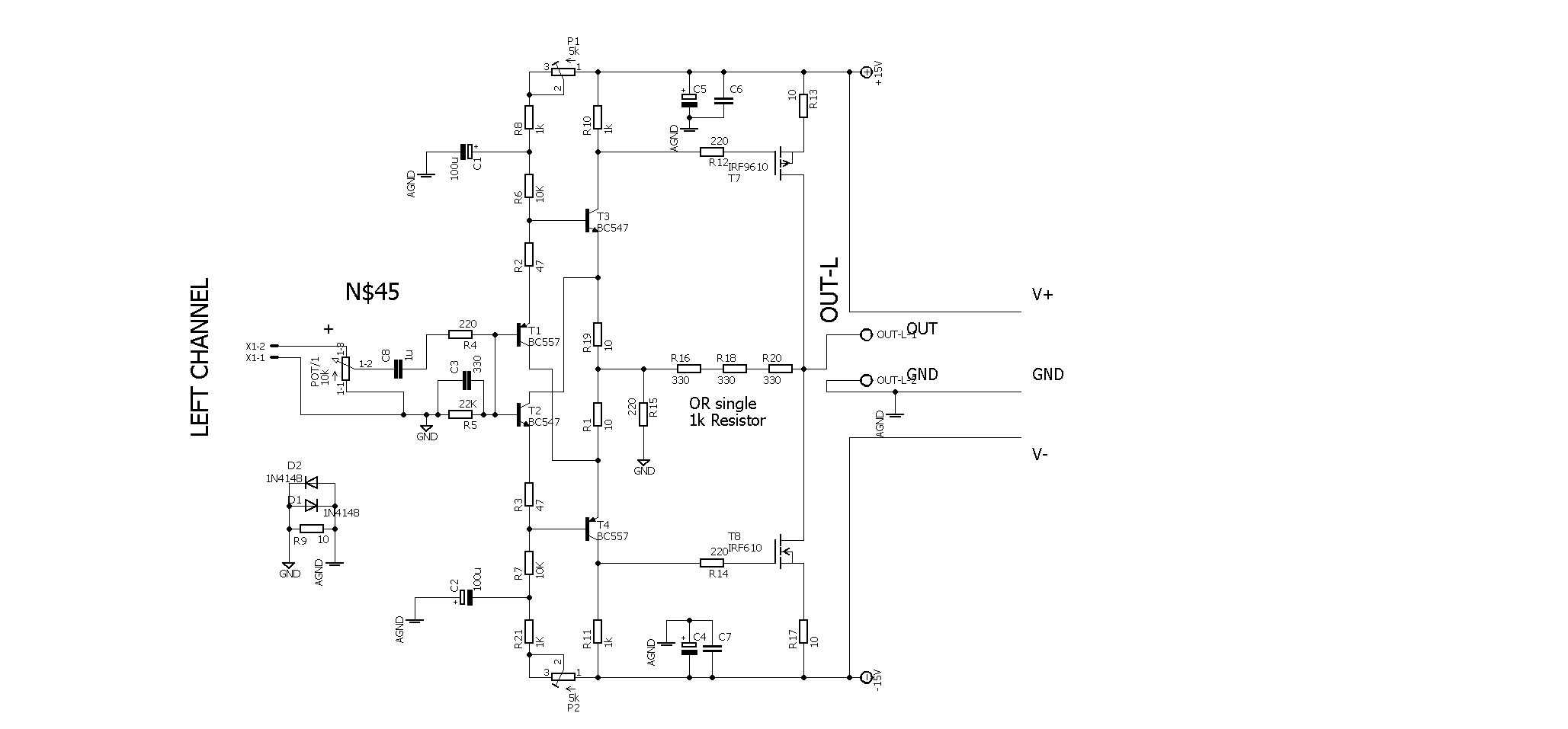

Can you kindly post the Schematics for each of the PCBs in the same post? I practically forgot what I asked for. Also the info will be useful for others visiting the thread later.
schematics for the PSU http://www.diyaudio.com/forums/pass-labs/298369-jumas-head-amp-11.html#post4881036
sch for Juma HA, one channel.
R5 value if using coupling cap can be 100k as suggested by juma. feed back could be three 330 R or one 1 k resistor. C3 is optional and can be left out entirely as per original sch. for good hygiene builds (read Juma's post in reply to XRK). C5, C4, C7, C6 are also optional.
