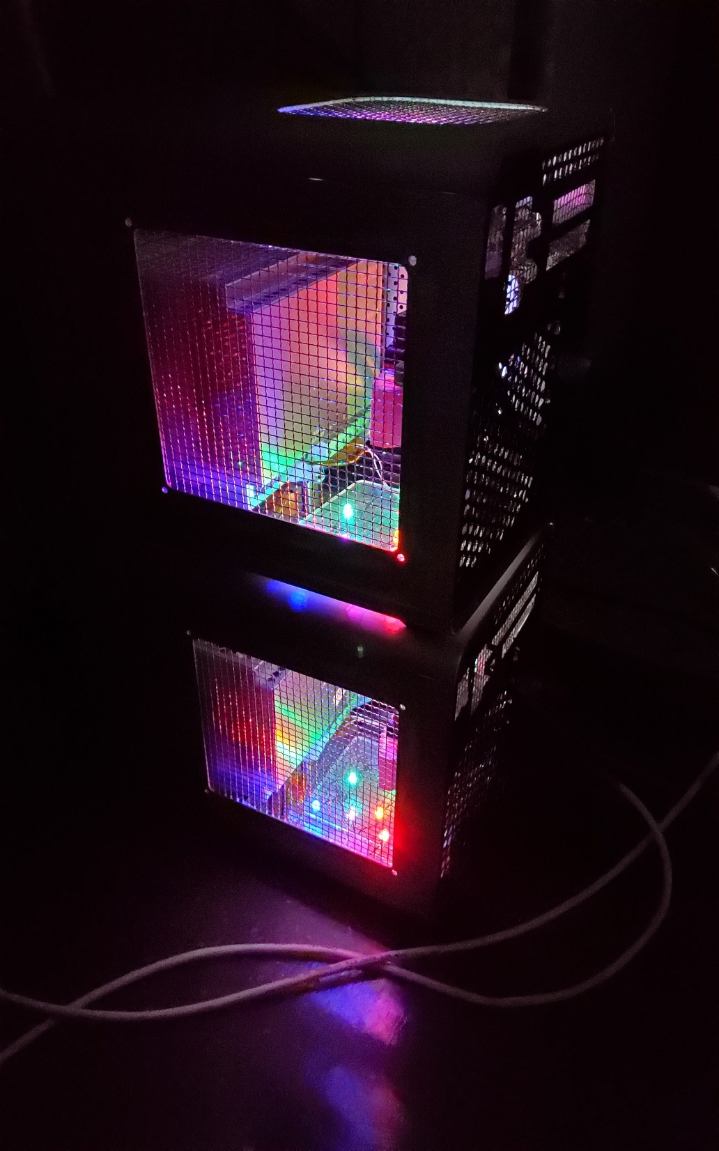

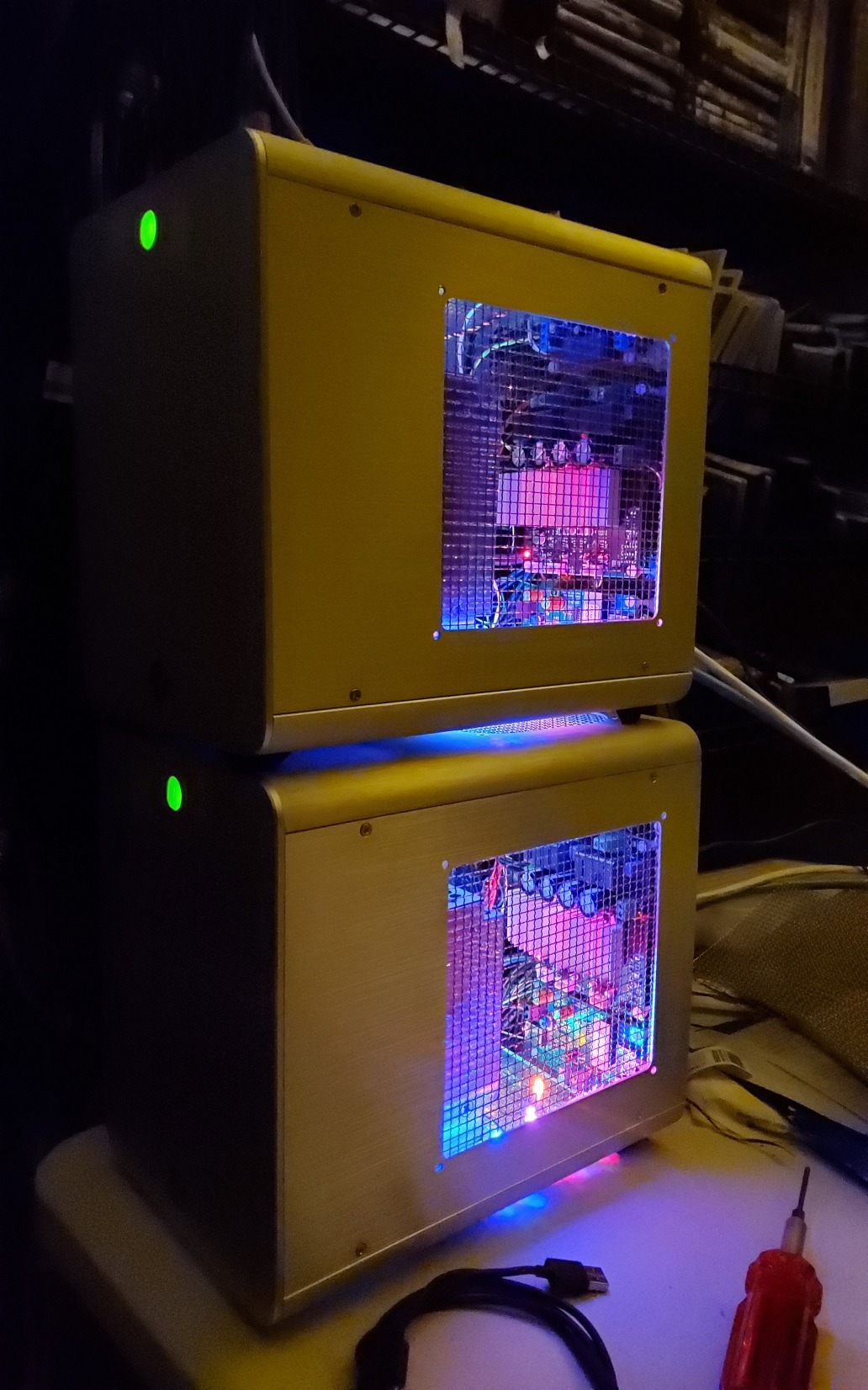

It was time to upgrade the TPA3116 to TPA 3255. Same as the Silver Dragons but with an older Quint PSU (13A Boost). Didn't split out the EQ and no squirrels to fight. Tried connecting the rails soldered directly to the storage caps but it ran hot. Adding the power to the proper power terminals normalized (total 12 gauge) It's cooking ~ 4W total/idle @48V. Runs pretty hot idle at @52V Noise floor -100dB+ pure silver ground and speaker wires. All Neutrik connectors. XLR3/Speakon/Powercon Three PCB UPC1237 power on delay, 3e-Audio Amp, Xkitz 2way cross. Star ground, off of chassis ground screw. AC/signal/PSU Neg

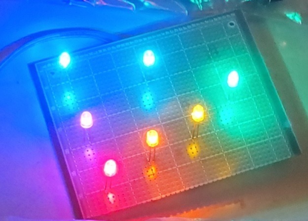

HP Green LED Pilot and seven LEDs Red/Orange/Yellow/Green/Teal/Blue/Pink just for fun.
The case is a Metis Plus and I wrap the insides with stainless steel mesh to reduce the holes and replace the OEM lid screen and window.

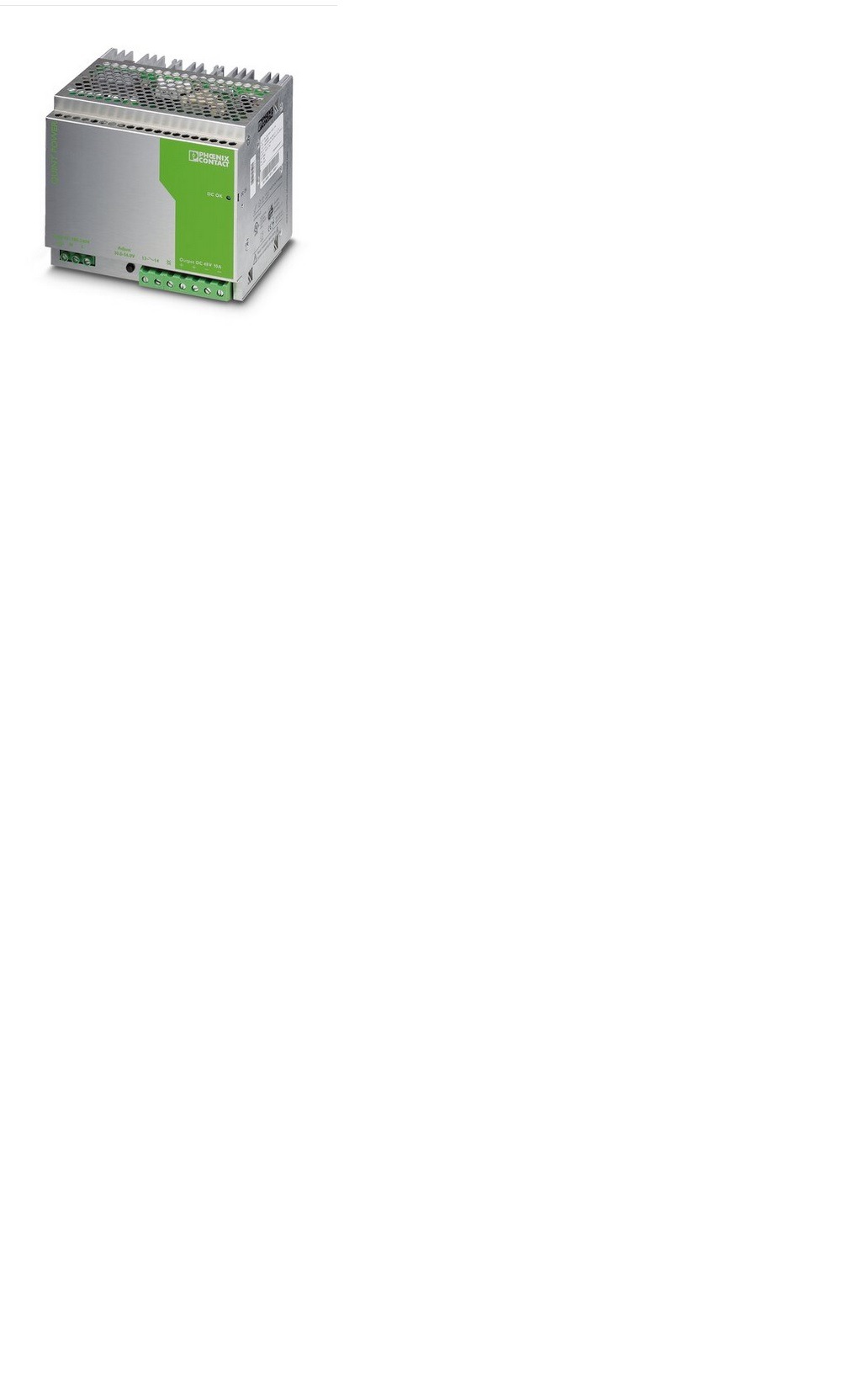

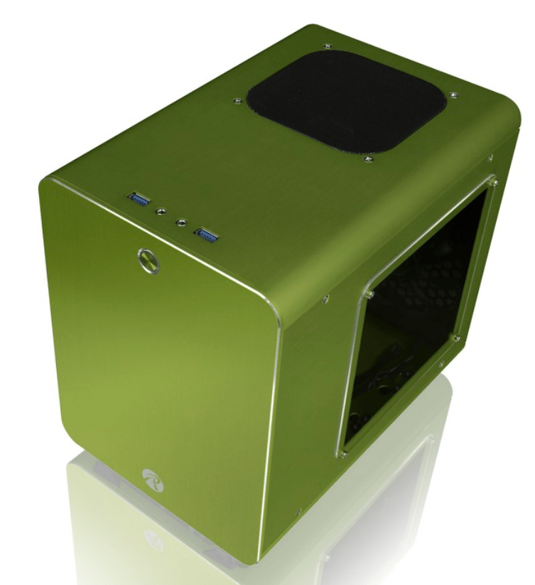

Last build in this series will be two Phoenix Contact 24V/20A connected in series, with two 3eAudio TPA3255. All stuffed into a Metis Plus case. So 4x 250W. I was going to go with bridged inputs per Amp PCB but still on the fence if I should put in the xkitz LR24 crossovers. A phunky thing would be to put in a three way cross and loop out the hi/mid for other Amp/using this as a sub build. I spurged and ordered a green case
