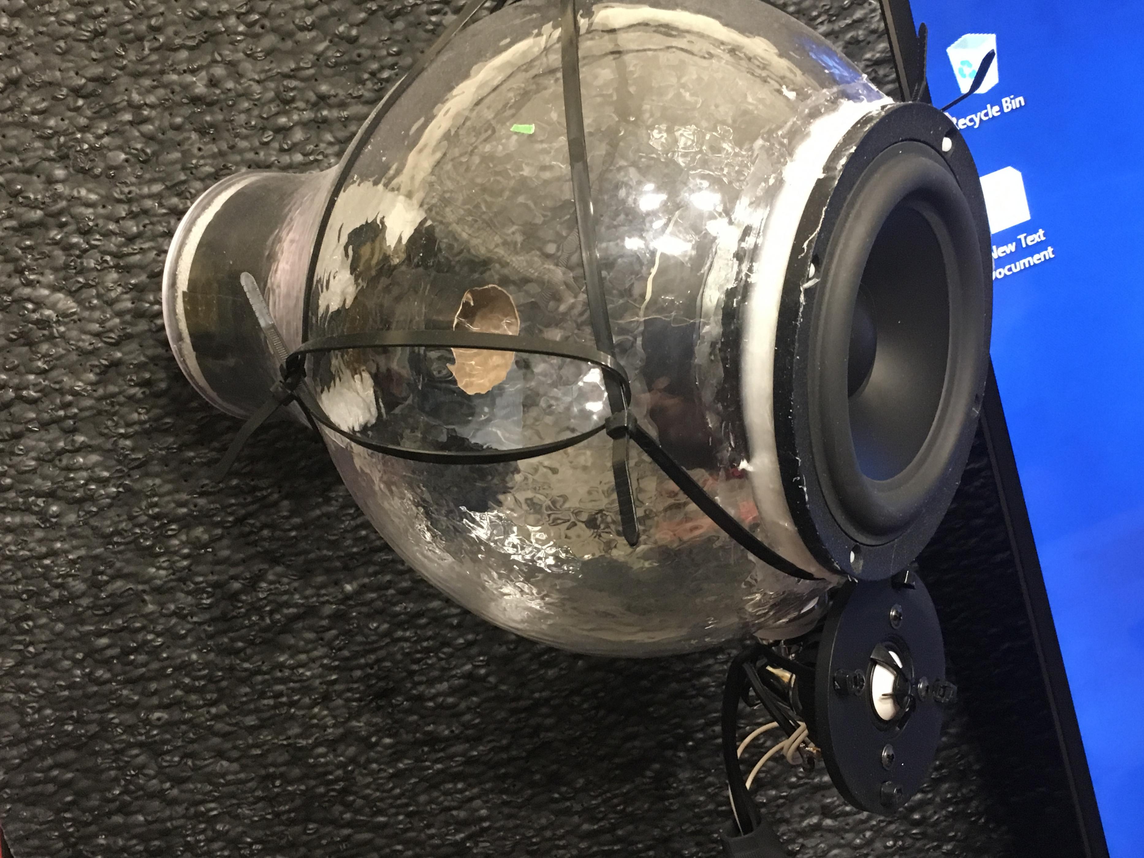

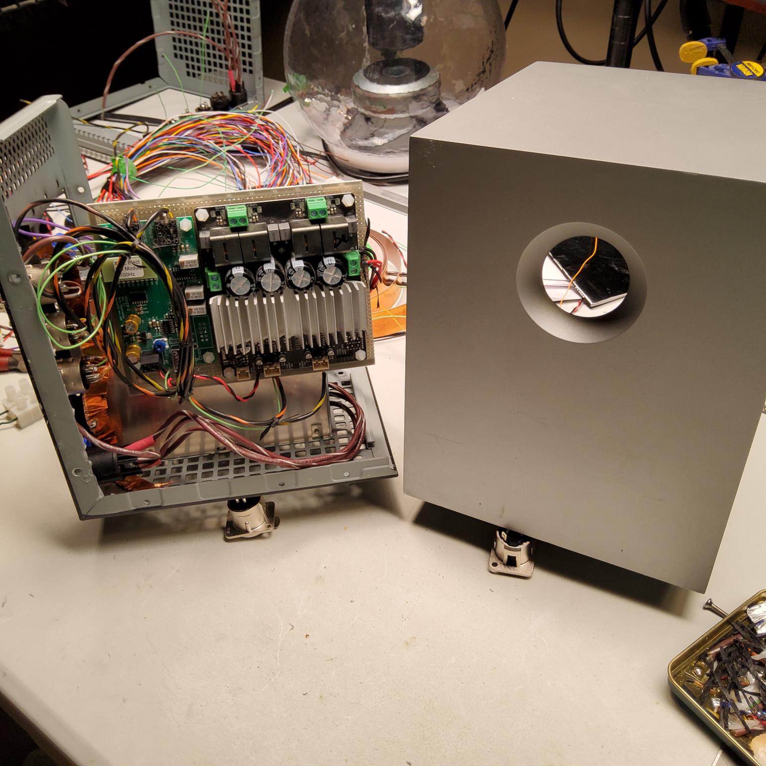

Hello and welcome to the Jugs MK II. It's been 10 years since the first Jugs shocked the world. Super Store was once again the inspiration: there must be someone there looking out for me. Any way down to business. These speakers come as a complete system. Starting with an SMSL m7 DAC driving a Breeze Audio Linkwitz Riley 2 way 24dB octave 2KHz crossover and 2 Breeze Audio TPA3116 Texas Instruments Amps(Bi-AMPed). Power comes from a Phoenix Contact Trio 24VDC/10A power supply.

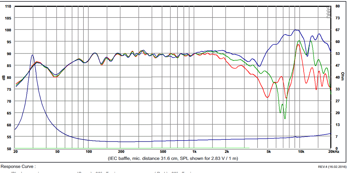

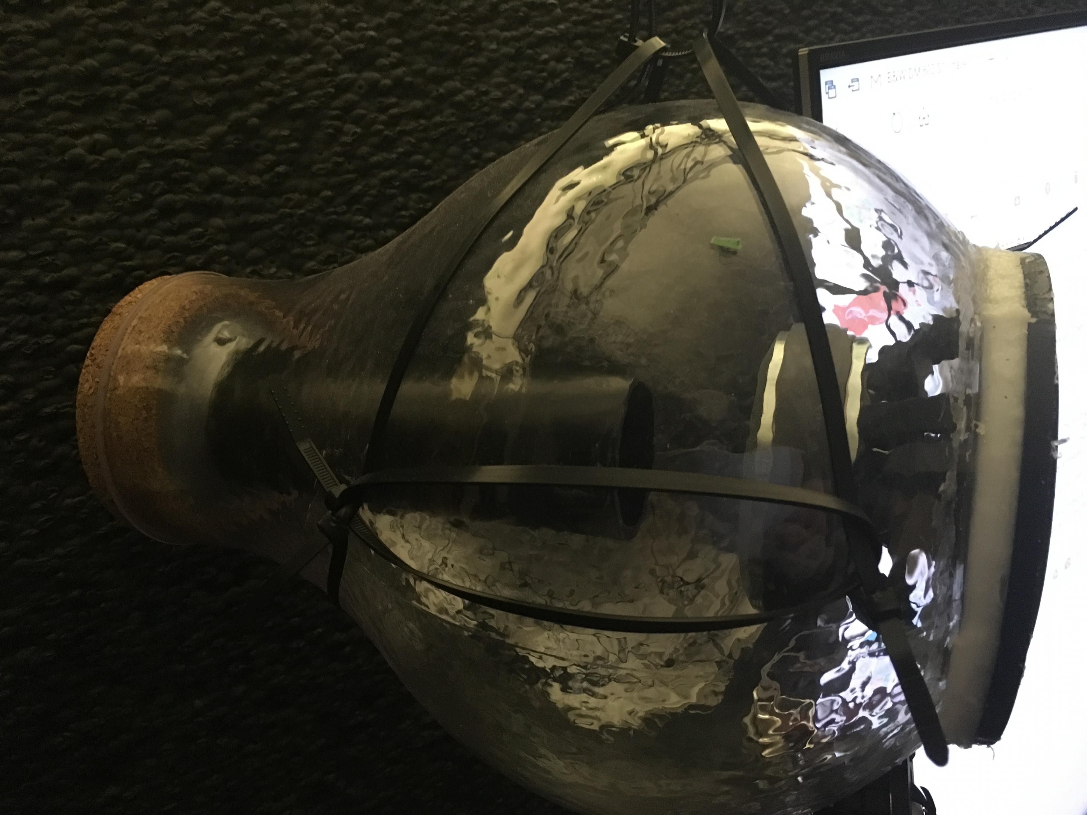

The speakers are built into a 7 liter jug with a 5cm x 20cm (2" PVC tube) port (60Hz). I'm using the a SB Acoustics 5" PolyProp speaker sb15mfc304 with an Eton 26 HD 3 tweeter.
So what's the big deal, I had to post this. Well the bass extension is down to 47Hz! and they don't seem to screw anything up. These babies are inviting the neighbors over to party. LOL I got everything at ebay, Solen, Amazon and Super Store ~$1100 Canadian

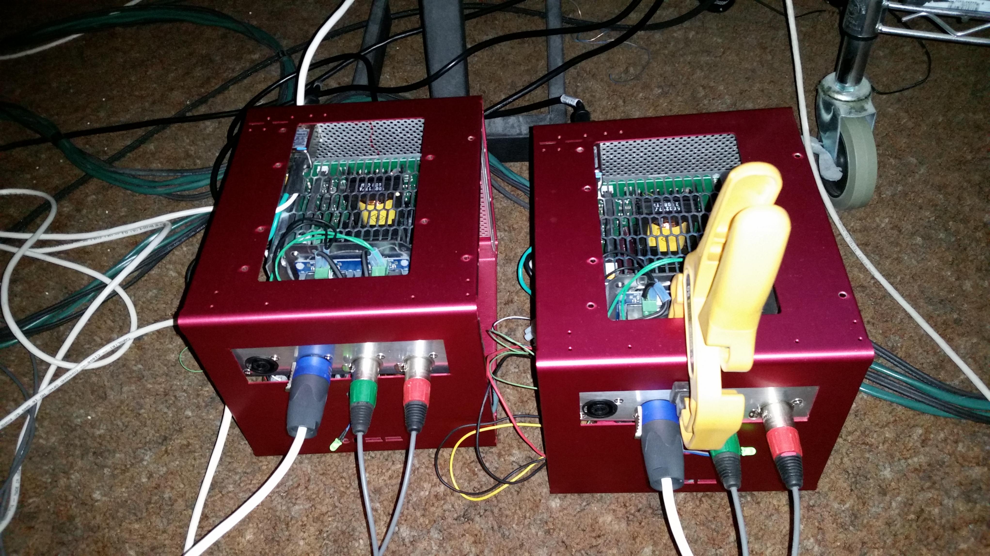

Tweak monkeys can swap the opAMPs, and adjust the supply voltage.
I would crack rebutter the TPA 3116s.
Have a nice day.

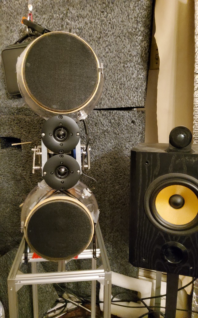

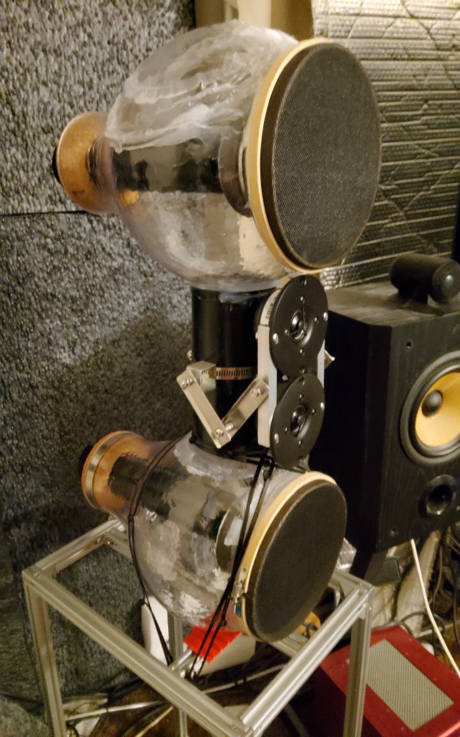

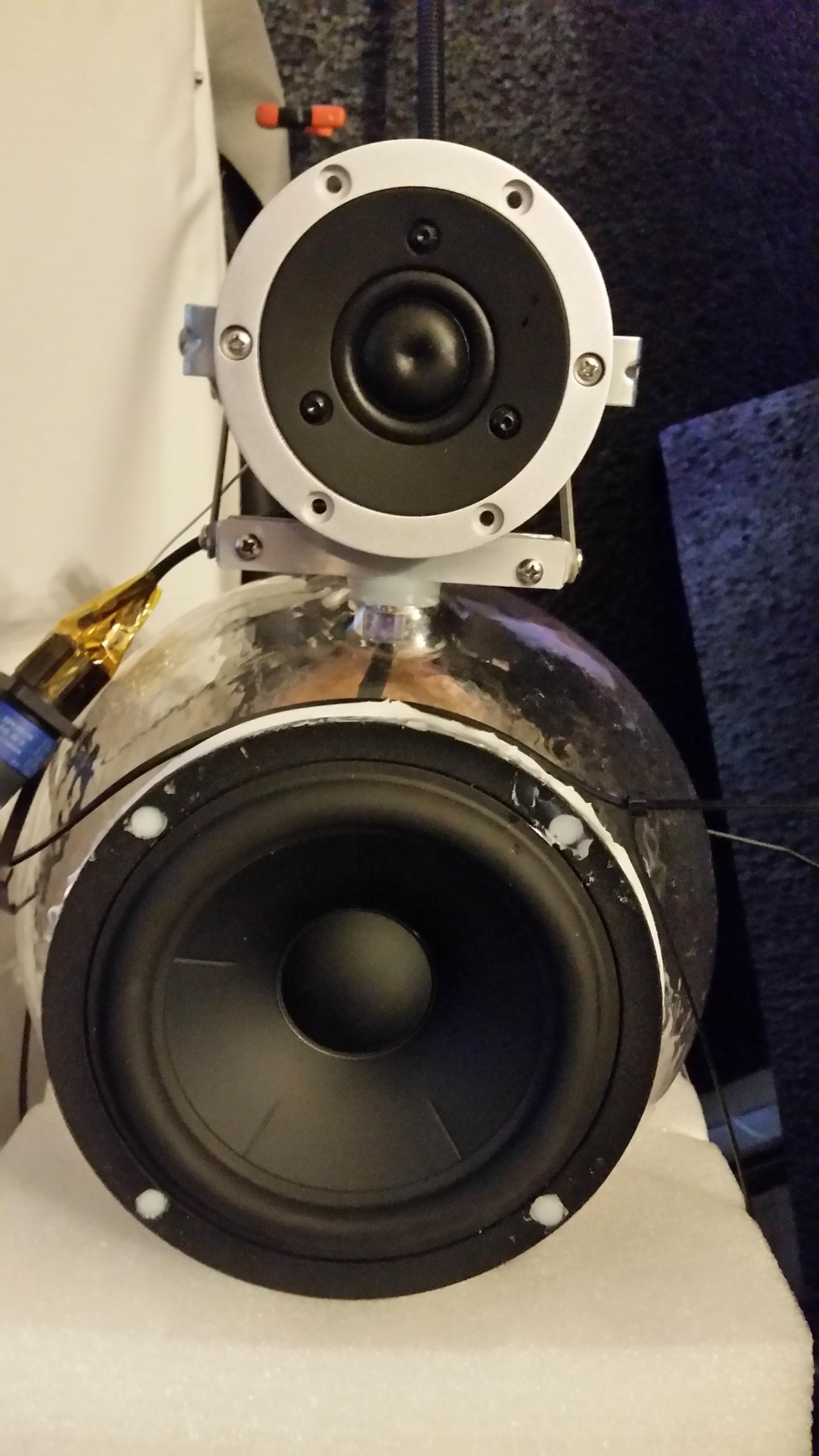

The first pass at the golden ears went well. The 6" Aluminum Black drivers (SB Acoustics SB17NBAC35-4) were more at ease, and the 2" ports could use a flare; but didn't huff and puff too much. Paired with the Satori (SB Acoustics tw29rn) traded better mid-range for top end shine. The preferred port tuning was 50Hz (35cm).

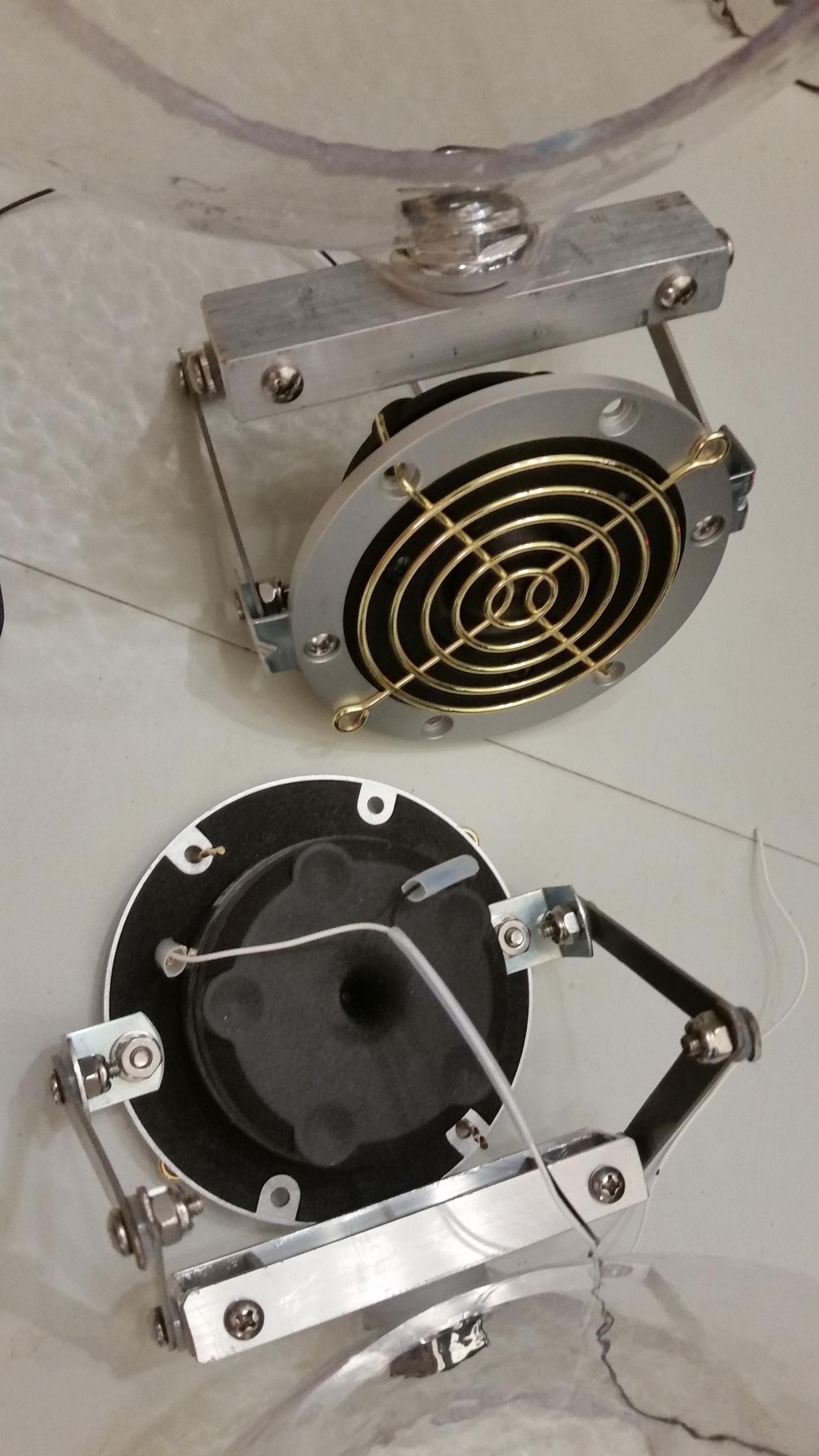

I built my own Meccano set (lots of work)/ tweeter mounts. So now time line is just a matter tweaking. They allow pan/tilt/zoom/height adjustment.

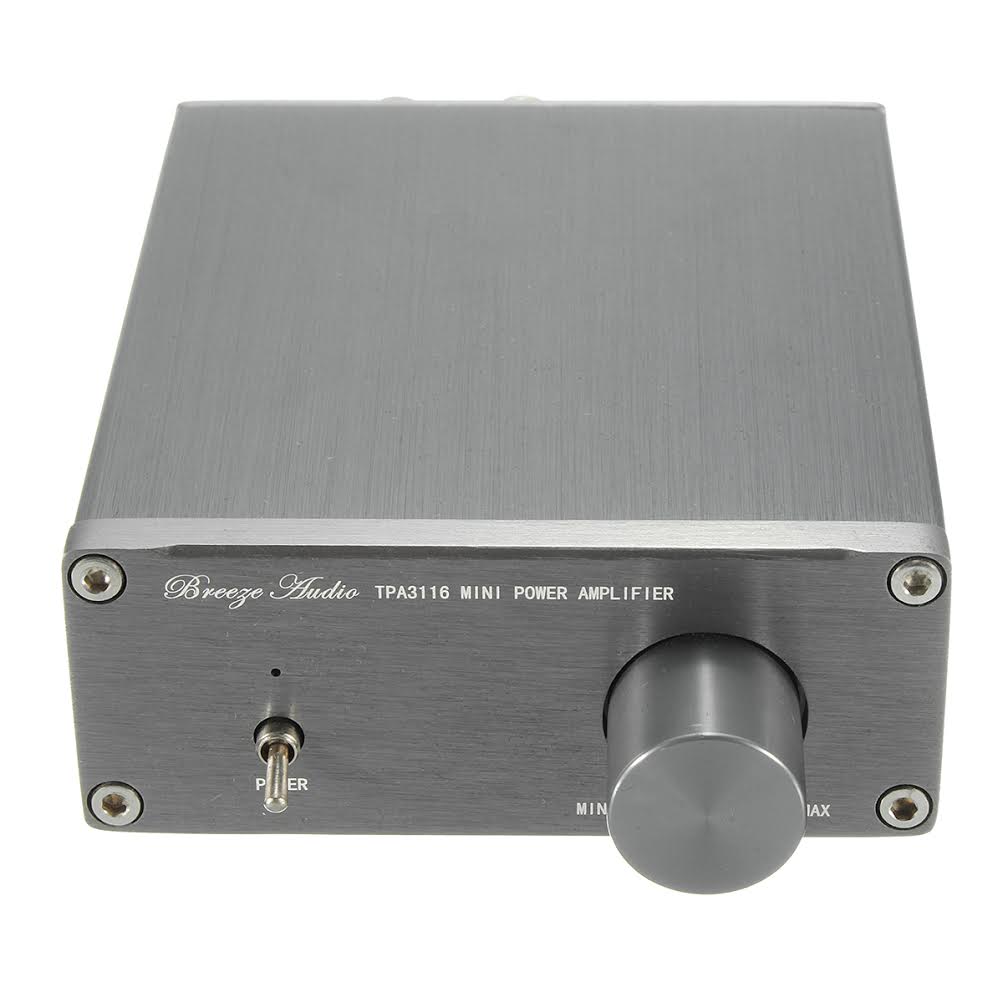

The Breeze Audio TPA3116 didn't turn their Sanyo knockoff caps inside out, nor did they break a sweat driving things real loud (@24VDC).

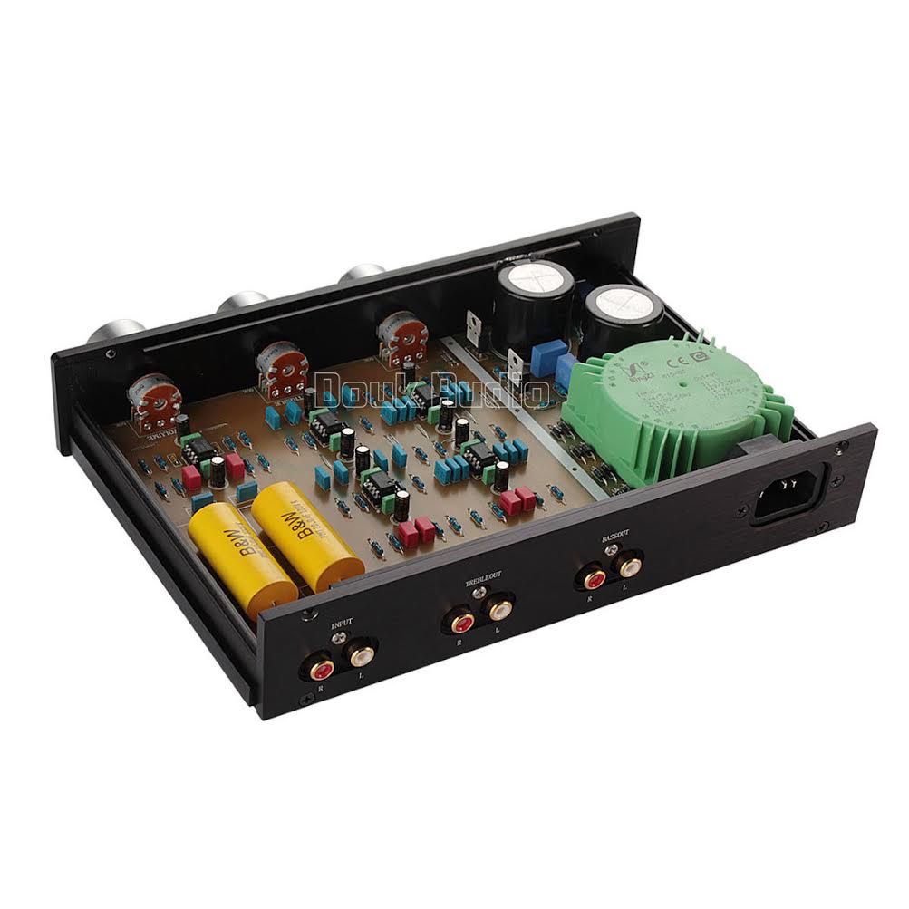

The Breeze Audio LR24 crossover, sounds better at full volume. I'd guess the pot is on the output and increases the output impedance when not cranked. So you have to deal with volume up steam(SMSL m7). Which isn't a problem with the great noise floor of these components.

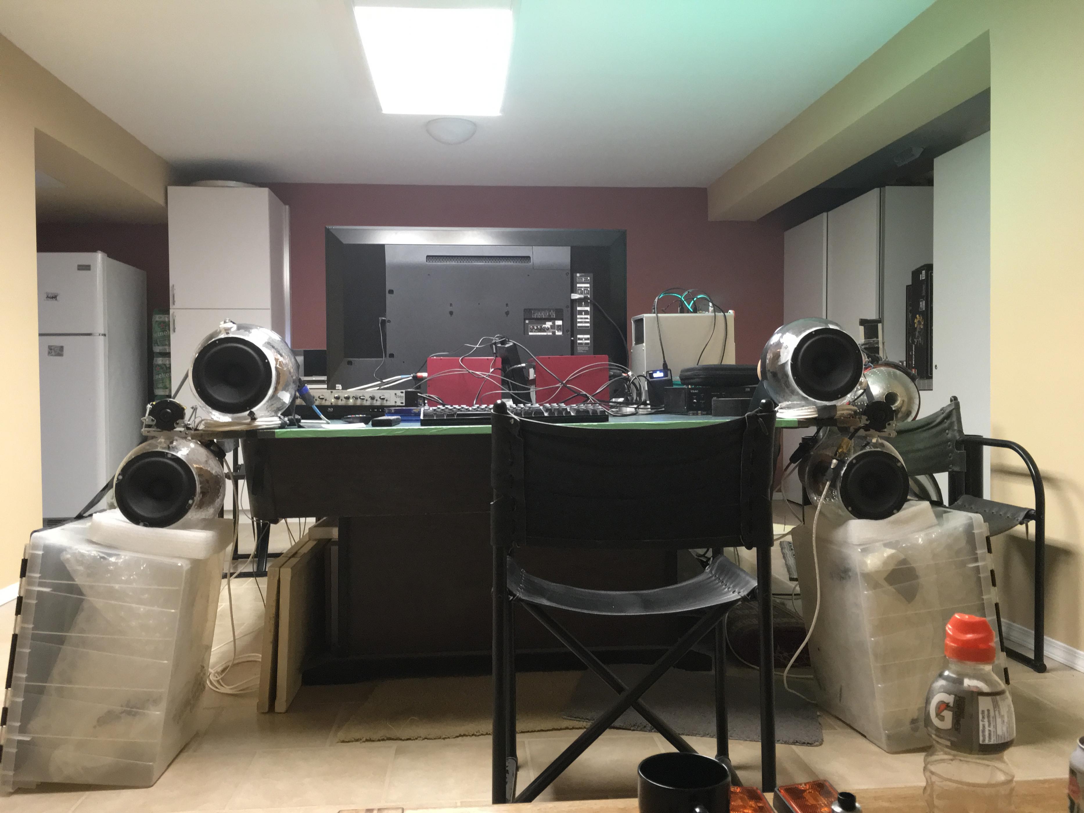

The final setup was a 12" equilateral triangle in a large studio. The speakers didn't have a problem filling in the center.
At home the 2" ports bipolar dysfunction was tamed with acoustic treatment behind them, or else there was a mid-range cancellation.
Super happy with the way these are coming along!
There are three potential problems:
1> the SMSL m7 DAC wakes from power off with the volume rather high
2> powering down the crossover before the Amps has a thump
3> discharging (personal) static electricity on the speaks, makes a loud pop

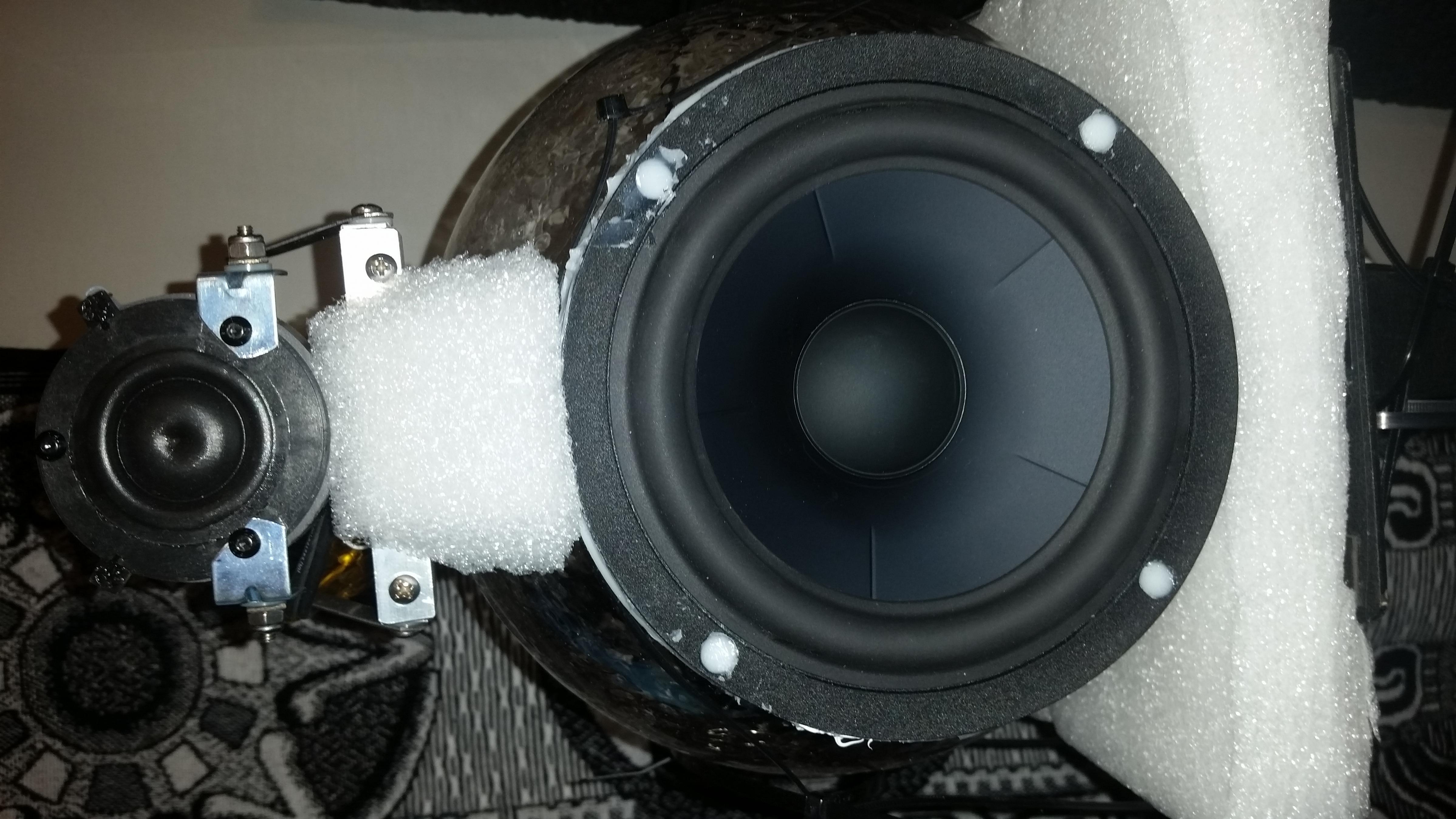

I see your point and will try to detect/measure any diffraction anomalies. I think a better approach: if needed. Cut off the flange to 70mm and add a shallow horn wrapping back to a bullet shape like a half football stuck on the back of the tweeter. That way there would be a smoother transition/no edge. The formulas are for piston type drivers so there are problems using them on a ring radiator.
If B&W can put a tweeter on a cabinet without a baffle, maybe I can..
Thx gave me something to dig into.

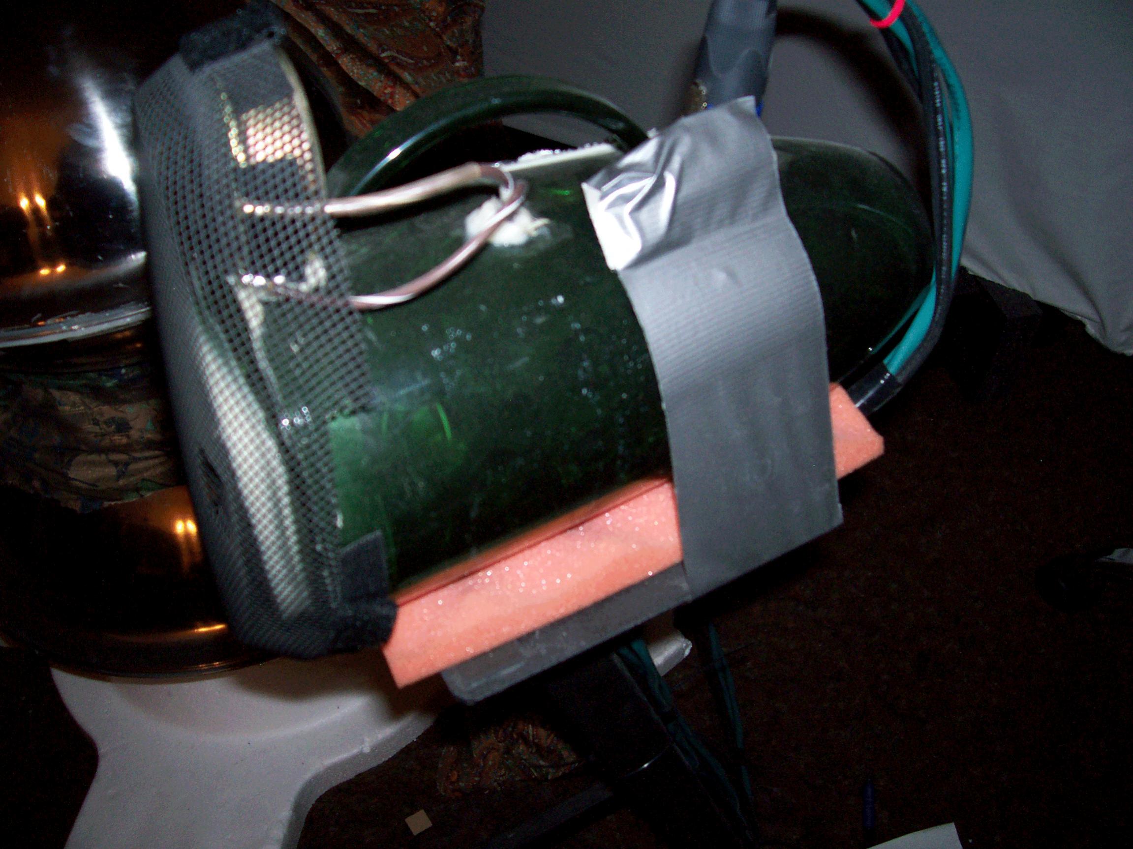

"Trimming" the "baffle"(reduce the physical diameter) on the Satori tw29r to 70mm. If my math is right it moves the baffle step to 2.45Khz. {F=343m/s / 140mm} With the crossover at 2.2KHz the majority of energy from the tweeter is in half space (directional).
Do you think that will improve the level discontinuity?
The "piston" diameter is ~35mm
Removed the Satori mounting ring, reducing the "baffle" to ~70mm. Added a foam ram between the tweeter and woofer (can't get the tweeter closer without modding the mount ~175mm).
Reduced the PSU to (min) 21.78V... sounds more relaxed, maybe?
Time for a golden extended home demo.
On to the Jugs MK II.6 Poly builds.
Still real happy. There is some resonance on the jug surface which will have to be looked into. Maybe a heavy rubber ring or two: compression fit. Suspending the jug just touching a body of water: should make it easy to see which frequencies (sweep it) are coming out sideways(don't have a contact mic/pressure sensor).
I found some small 120Vac relays so it should be possible to interlock the TPA3116 mute feature with it's power supply(ac) and crossover power(ac) (idiot proofing).

On a side: I have switched to TPA3255 chip amps and things keep getting better. More detail and better low end at low levels. I'm using the 3e-Audio version and have a ground plane noise spike getting into the frontend probably from the passive Vmid. Not a fan of the single supply frontend. But that is another story. The PCB is clean to about 70W per channel so it's not all tears.
I put a UPC 1237 speaker protection PCB in. I had to defeat the "protection" (lifted the sense resistors) and increased the series resistor for the coils. One leg of each output goes thought the relays. So it's just a turn on/off mute. Using a larger version of the Trio PSU 48VDC/10A all in a Lian Li PC case

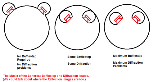

HaHa, the Jugs that shocked the World! I suppose this is a Nautilus idea in the end. 🙂
The teardrop shape has some advantages.
It does seem that TMM's idea of a similar treatment of the tweeter has some merit.

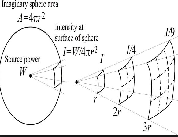

I did a thought experiment a while back on spherical loudspeakers. It gets away from the square box in the square room.
In thinking outside the box, I think people were playing with IKEA salad bowls as enclosures. I conclude this would be an excellent idea for home HiFi for Eskimos. You, know... perfect for Igloos. 😎

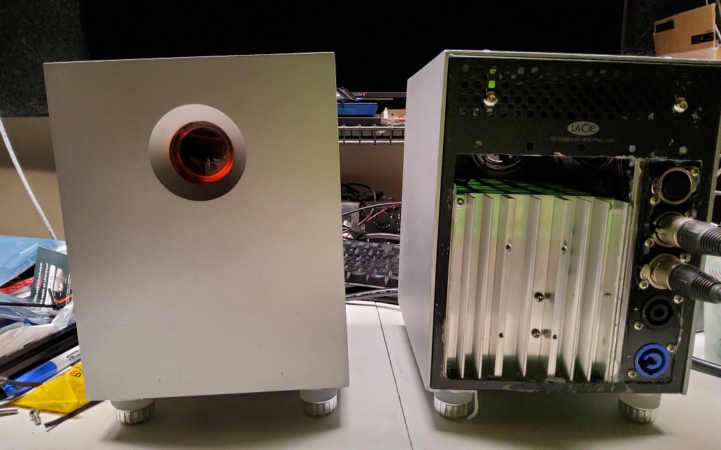

Here are some pictures of the original Jugs. They don't really go down as far as you'd like to match up with a Sub properly (80Hz) but they are fantastic for surround gaming (localizing that wolf in the forest). Delco 3" Poly / JBL Ti 1" in a 2 liter jug. Chuck in recycled perforated mat for stuffing, for a little dampening. Simple Cap/coil crossover: jazzed with battery bias and foil coil crossed @3.5KHz
As for the round speakers, see the thread below, for my take on that.

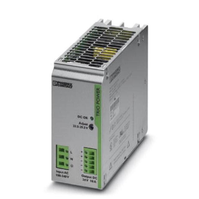

Had a couple days to hammer the new TPA3255 (3e-Audio version) and they worked very well. The Phoenix Contacted Trio 48V/10A supplies had no problem. I did trip the protection when the power cord fell out...But that doesn't count.
The setup was too low for a great image (no stands yet). But this pile worked in a completely untreated room without being sharp or ringy. I can see why MTM is so popular. The two bass drivers muddle the point source so you get a large driver sound. Like ~4 times larger. When they get real stands/combined... it will be clear if the image is sharp.
