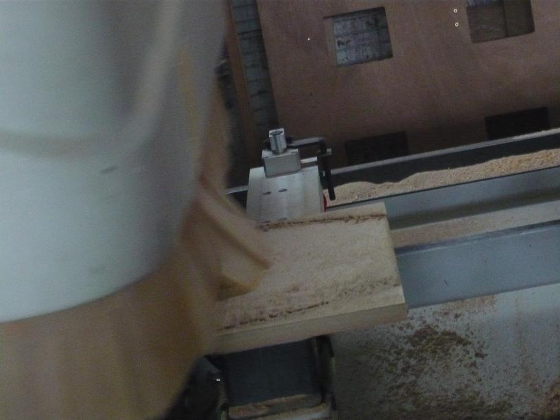

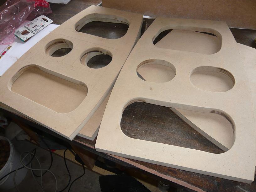

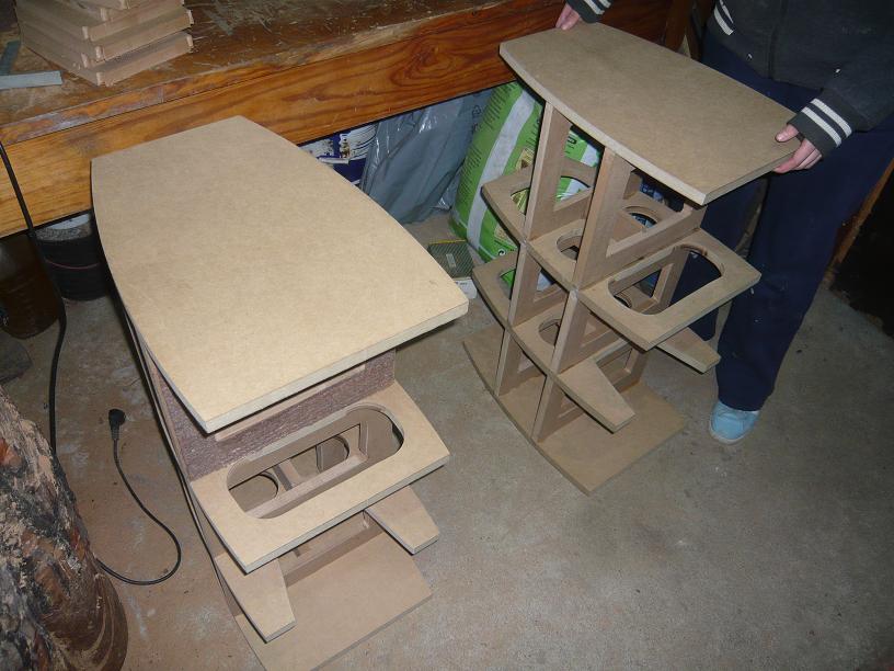

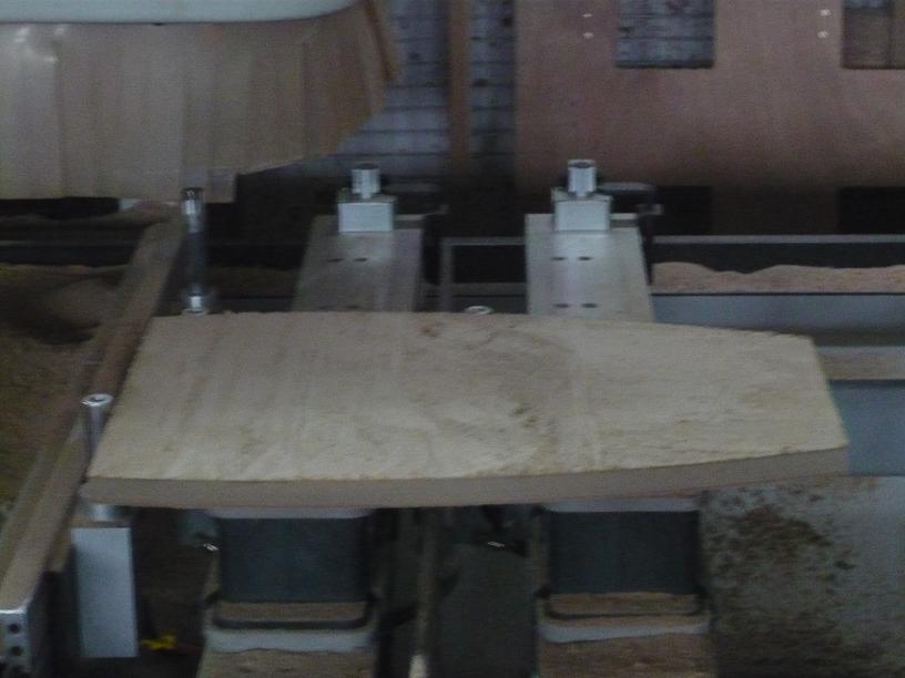

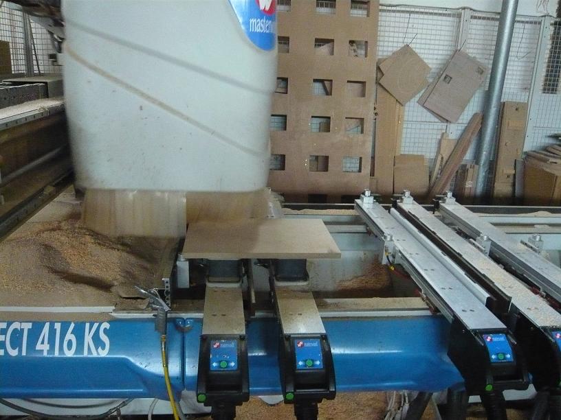

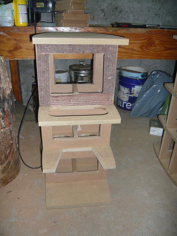

Since I wanted the cabinets to be curved, I needed to use a CNC that I was able to find neer the place I live. This pictures were taken in 2009-12-28.
In the last two pictures is possible to understand the final shape of the enclousure.

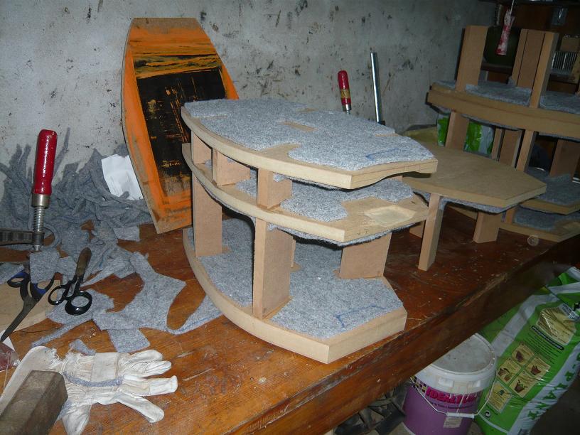

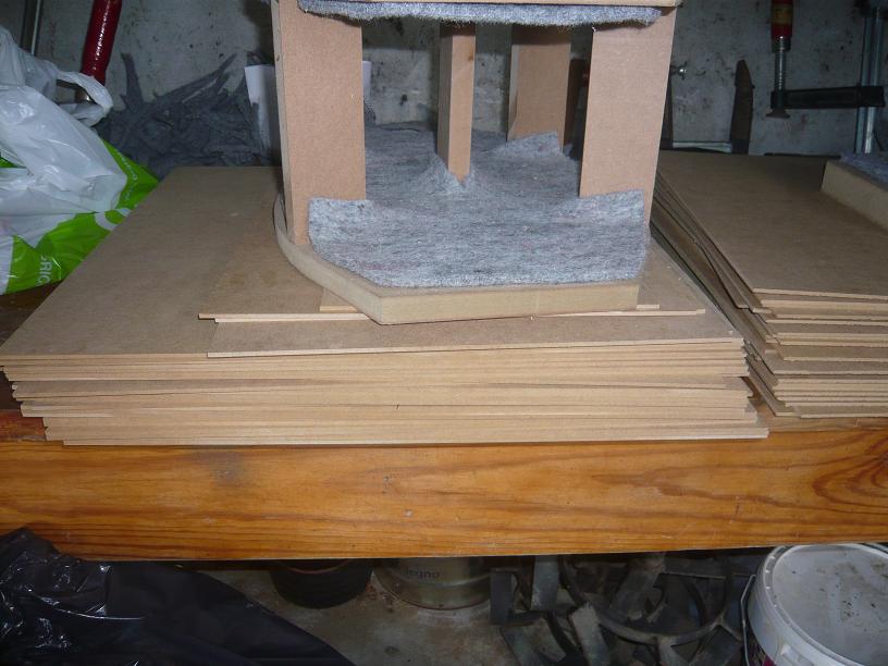

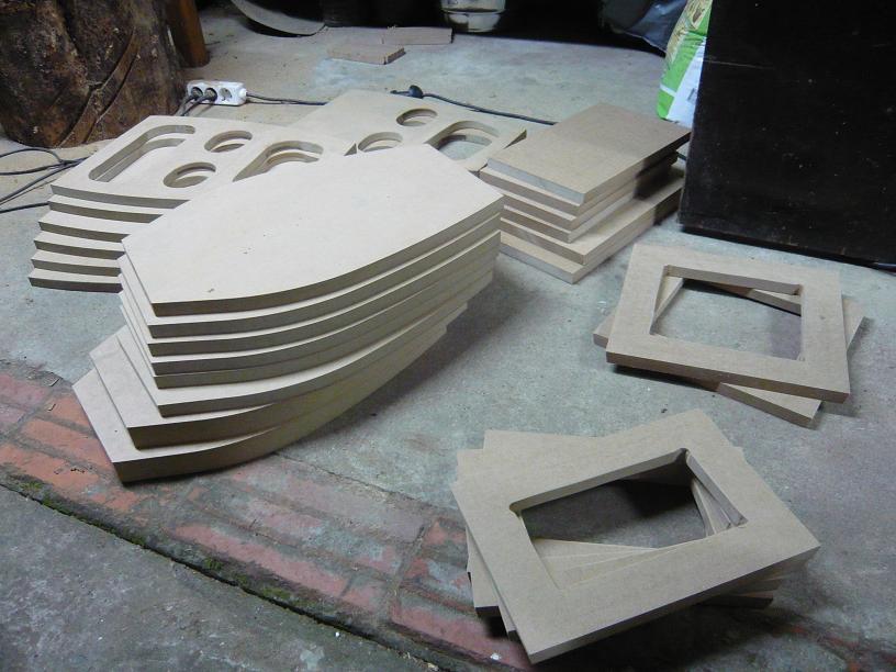

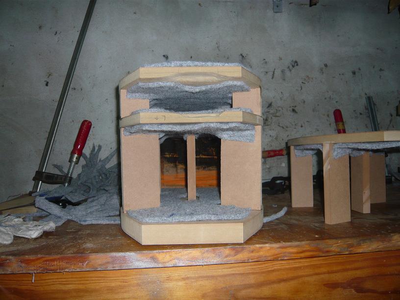

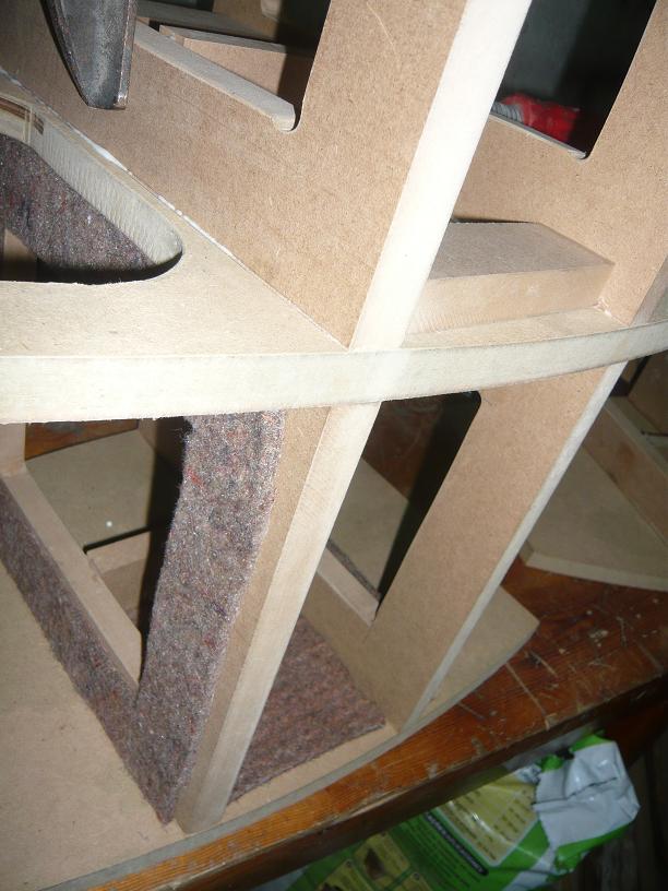

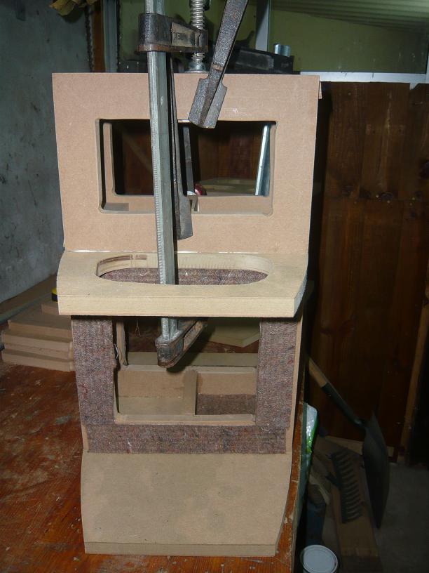

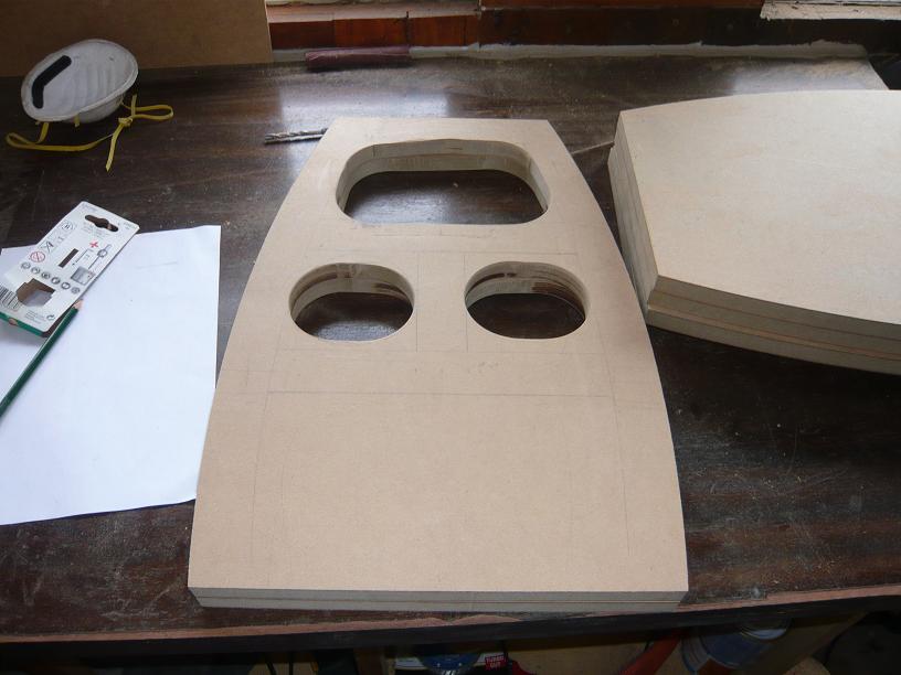

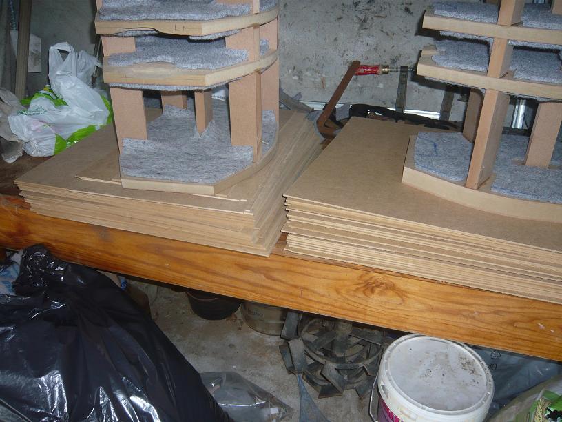

It tool a few days after to bought the adicional wood. I needed wood for the internal bracing, for the front baffles and back of the box, soo I used 19 mm MDF (3/4"). I also needed to create that curved side wall of the loudspeaker. Insted of cutting lots of pieces with the shape wanted with the CNC and stack all them on top of each other, i.e., several layers ($$$ being the reason not to do it), I used MDF with 3 mm (1/8") in the side walls, using 6 layers. Pictures will so better this technique.

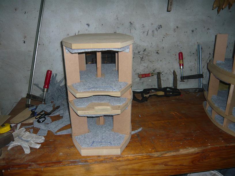

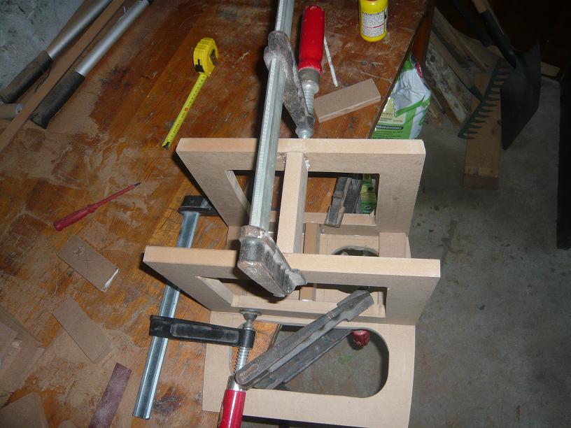

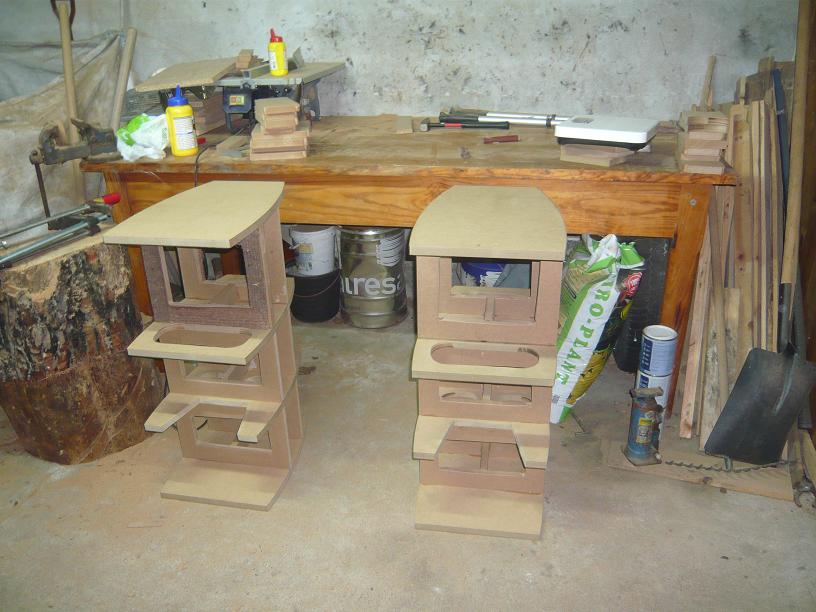

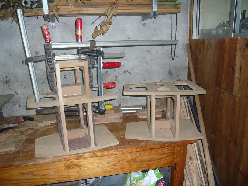

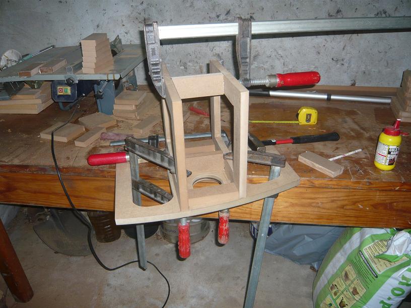

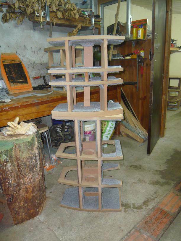

First the pieces of the internal bracing (2010-01-17):
Yes, it seems. 🙂

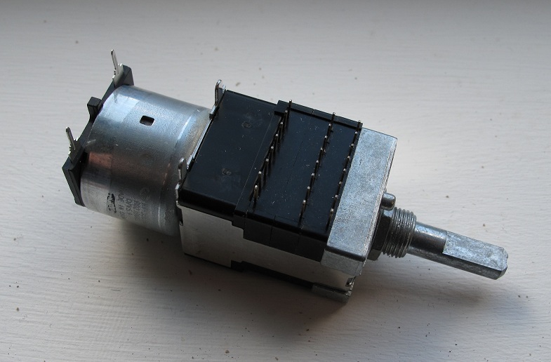

As to a 6 channel volume control Mouser stock a nice 6 channel pot at very little expense. I have one of these, although I am yet to use it, it does seem to be made to a decent enough standard.
Pot.
Hi 5th element.
Finally I'm showing something here 🙂
It's nice to be finally building something isn't it 🙂
Can you provide more information about those volume controlers? I didn't understood how they work 🙁
It's just a normal stereo, motor driven, potentiometer, except that it has three of them stacked together.
Attached is an image of the underside showing the three rows of pins, one row for each stereo section. The connection pinout is a standard one for this type of pot.
The pinout is detailed here.

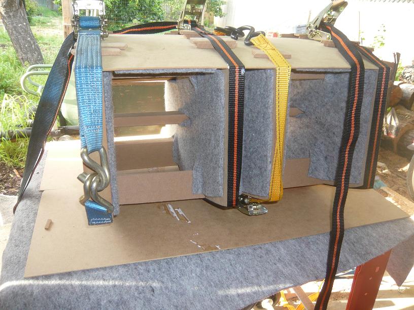

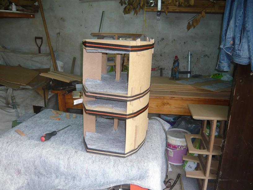

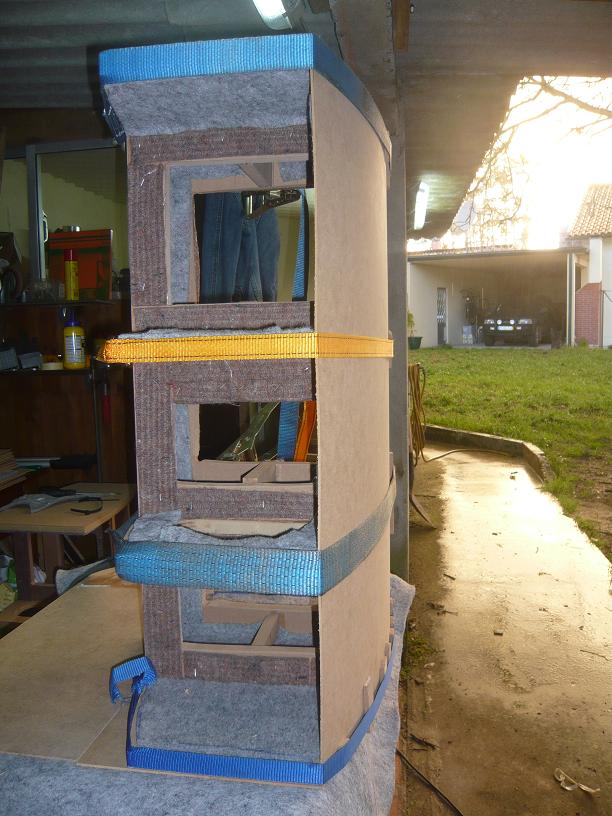

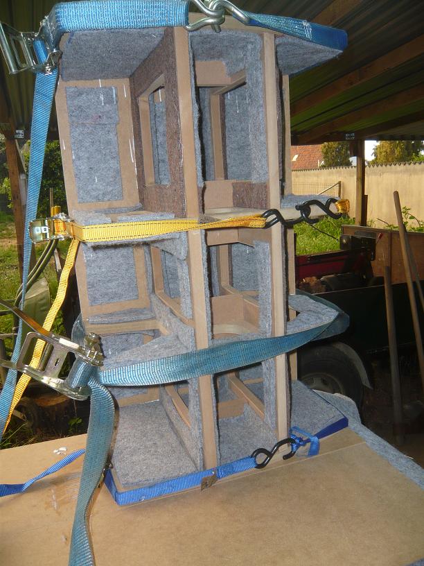

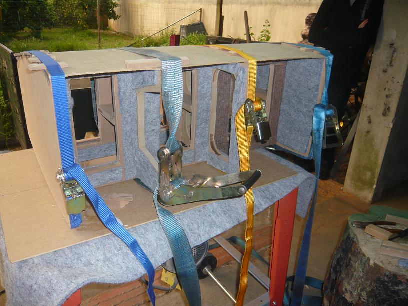

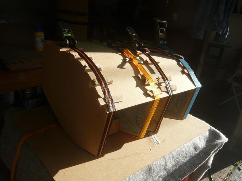

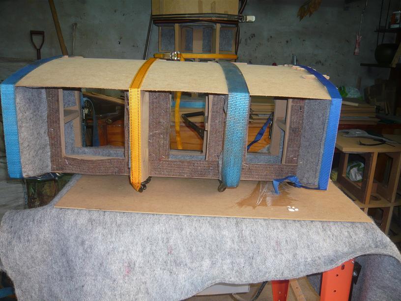

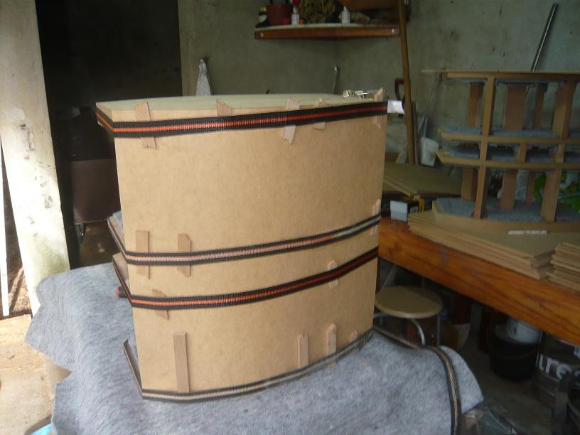

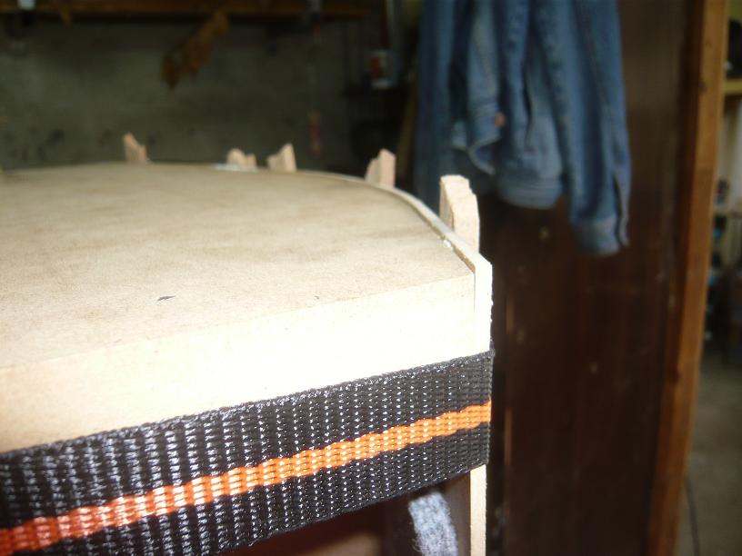

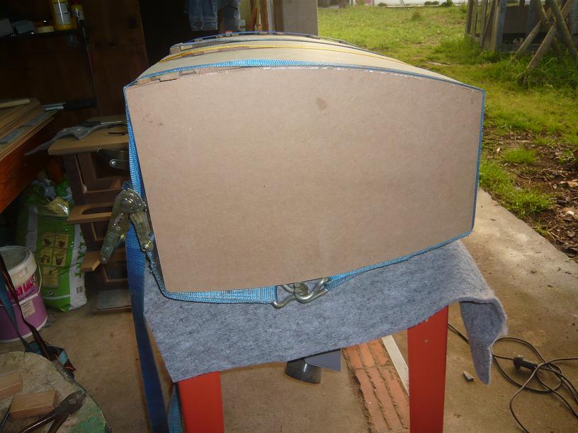

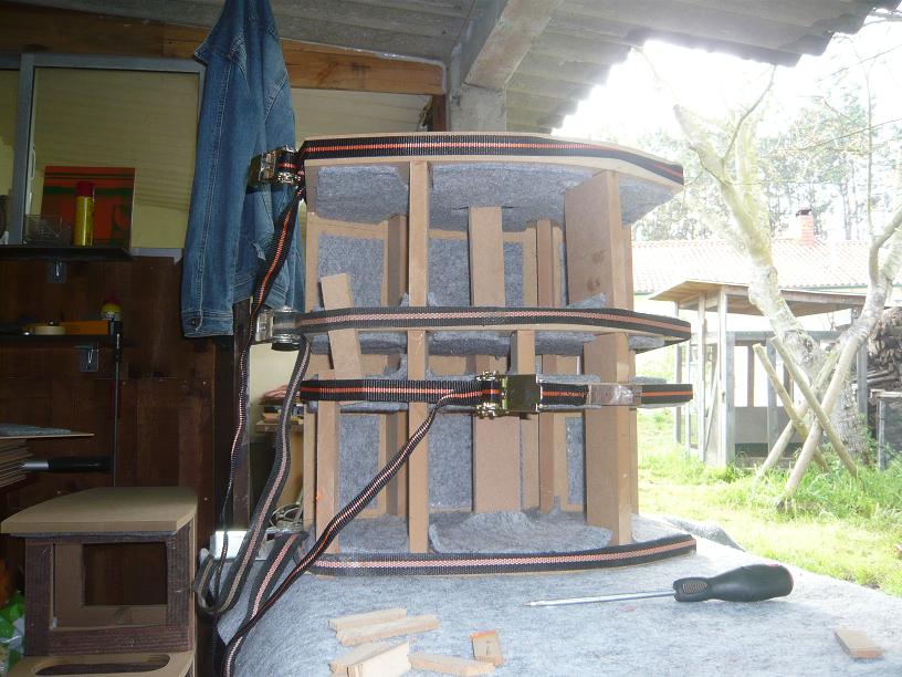

2010-04-18 was a great day. It was the day that I had glued the first side wall piece to the internal structure. I was very anxious to see how it would work.
I had glued the first pieces with a friend of mine. It took one 1:15h to get the first piece glued. :worship:
But when I looked how it resulted, I was very pleased. After that we got more confident in our work and managed to glue the pieces faster.

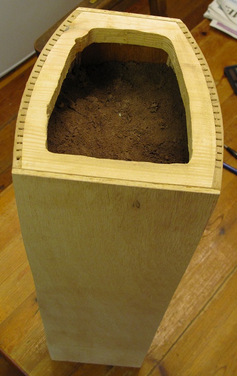

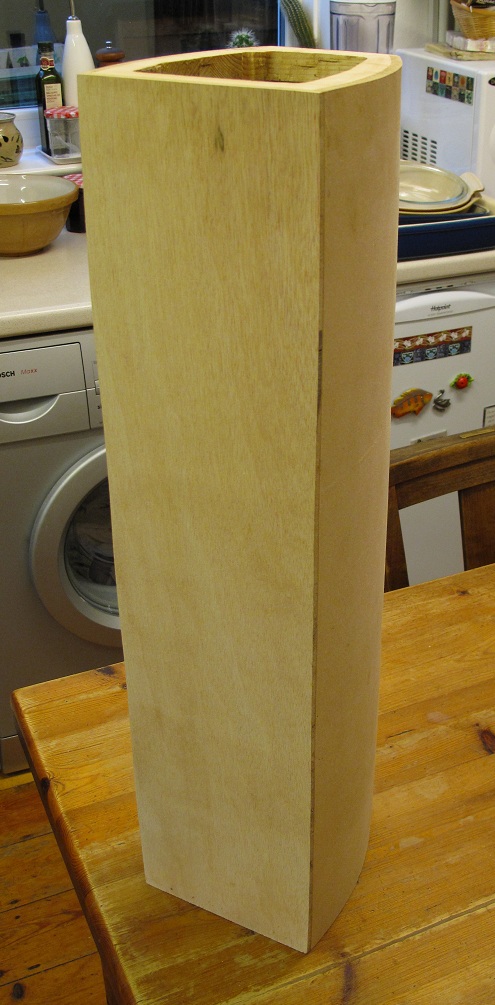

The construction technique looks very similar to what I am using at the moment to make a pair of stands.
I used google sketchup to draw the template shape, printed it out, stuck it to a piece of plywood then cut the wood to the shape of the print out.
Afterwards I used a template cutter on the router to make 8 of the same thing, then wrapped bendy MDF around the template, then filled it with mortar.
My description is horrendous so I'll just show a couple of pictures instead.
attachment.php
attachment.php
That's as far as I've currently got 🙂 One main column for one stand. I really wanted to check if the thin carcass could support the weight of all the mortar, which it could. It now weighs almost 19kgs.
