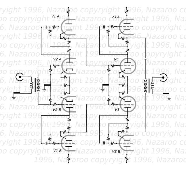

The Mu Follower Again:
My ears were drawn back again to the Mu-Follower.
Why was it so pure? Why was it noiseless?
(1) It was a Constant Current circuit. Sure. That explained part of its magic: The Power supply was never asked to do more than it always did. Ripple did not increase with varying music signals. But that wasn't the whole story:
(2) It was a Very High Resistance circuit. Most of any noise voltage appearing in the Power Supply was divided across the high resistance portion of the series-circuit. This second fact was what gave the circuit an almost miraculous PSRR. Most of the noise was dissipated as heat in a non-amplifying part of the circuit off from the signal path.
Because of this, the Mu-Follower is the ideal preamp circuit. Critiques aside, it reproduces and amplifies the cleanest signal possible in a tube circuit. Its only drawback, the requirement of a relatively high impedance load, is no limitation for a preamp: You merely add a high-quality cathode-follower as the next stage.

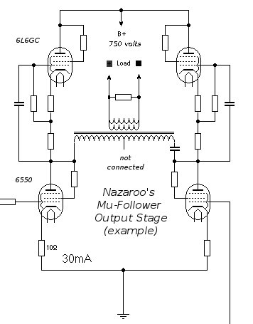

Output Transformer Blues
I turned back to the Output transformer. I studied its behavior more closely.
A balanced D.C. current in its bifilar primary winding was supposed to do two things:
(1) cancel itself out, preventing any magnetization of the iron core, which would use up precious saturation headroom.
(2) reject 99% of powersupply hum and noise, because this also would be balanced in the primary.
(1) cancel itself out?
I thought about it. This is actually nonsense.
In a Push-Pull circuit, the tube on one side conducts more,
while the tube on the other side conducts less.
Its current, not voltage that magnetizes iron;
the currents must swing significantly from side to side in the primary. This means that these currents are sucking back iron-domains, and if the current wave-form isn't a duplicate of the original signal, power is being used in the transformer not belonging to the signal. Any distortion products are also being distorted also in phase due to hysteresis. To put it bluntly, transformers amplify distortion, adding yet more.
It became obvious to me that one must prevent any distortion from entering the transformer in the first place, at all costs.
(2) reject 99% of powersupply hum?
Now lets imagine a 120 Hz ripple (with harmonics).
While there is no music signal,
and the current is balanced on each side of the primary,
we know each tube is acting like a static resistor (and diode in series).
The same percentage (amplitude) of the ripple voltage appears across each half-winding in the primary.
So far so good.
The voltages and opposing forces cancel:
no PS ripple is transmitted to the secondary,
and no current is induced in the iron core either.
Now suppose the music signal is a 30 Hz bass-note.
For the first two cycles, the music signal unbalances the two tubes:
one conducts more, and the other less current.
The voltage also rises at one plate and falls at the other.
now there is momentarily a "D.C." (slow changing A.C.) across the whole primary.
In slow motion if you will, one tube acts as a large resistor,
and the other acts as a small one.
More current flows down one half-winding, magnetizing the core.
(so far so good, because this is the music signal).
But now the PS Ripple also appears more on one leg than the other,
because of these slowing changing voltage-dividers.
The PS Ripple, modulated by the music signal is pushed into the secondary as an AC voltage.
This happens four times (in alternate directions) every 30 Hz.
But most critically important, it is happening most of the time!
During this low music signal, there is darn little PSRR!
The same rule applies again:
We must never let the PS ripple appear across any part of the primary!
One obvious rule, if there weren't enough reasons already,
is not to include a transformer in a multistage feedback loop!
What circuit achieves both goals?
The Mu Follower.
It became obvious to me that not only would the Mu-Follower work in the Output stage, it was essential!

Here is the circuit for the WWII version of my amp, one of the first I built.
You can see why it is the cleanest of sounds:
Only two stages. Less than most preamps!
Two transformers.
3 caps.
It is an elegant solution to sonic purity.
Here are some notes:
I used Jensen transformers for the input;
any good output transformer will do.
It requires two heater supplies, one for the upper tubes, one for the lower.
Either float the upper or DC offset it from the powersupply at around 300 volts.
It requires two power supplies, 400-500 for the 1st stage, 700-800 for the 2nd.
The PSRR is so good, you only need simple, modest PS circuits.
You can run the 1st stage off a resistor/cap leg from the main B+.
The top tube was a 5998 in the power section (V3 A, V3 B).
You can also try a couple of 6L6s or 6V6s, in triode-mode.
The bottoms were a 1625s. 807s are equivalents (triode mode with the usual precautions)
6SN7s or 12AX7s will do in the first stage.

The mu-follower is a useful circuit, but as you say it needs a high impedance load to give its best. It doesn't get this in an output stage.
The AC current in the normal P-P OPT primary is largely balanced by the AC current in the secondary. The DC current is largely balanced by being in opposite directions in the two legs. It is true that ripple IM does not cancel in the same way that ripple itself does. I only realised that myself relatively recently, but I assume it has been known by others for decades.
If you want to go down the inefficient route of keeping DC out of the OPT then I would have thought that a push-pull SRPP pair would work better, combined with better supply rail regulation to eliminate ripple. The SRPP was actually designed to be an output stage!
PS: Ripple IM in any push-pull circuit will add, while ripple itself cancels, so the p-p mu-follower suffers from exactly the same issue as a normal OPT.

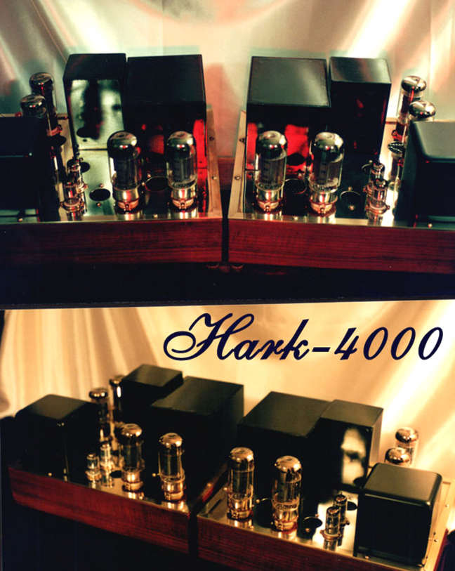

Here's a pic of the pair that went on the A/B challenge:

That I can agree with. Get the circuit right, and then component selection is the icing on the cake. Far too many people want to make a cake out of icing!nazaroo said:My scientific brain demanded that no 'magical thinking' was allowed. If great amps could be made, they could be made with ordinary parts. They shouldn't and didn't need exotic devices or gold-plated wires, or special magic weights on top of my speakers.
I note that you show one schematic based on the MU Follower, and a second schematic based on the SRPP. Which represents your prefered implementation?
I only use Mu-Followers.
The (incorrectly drawn) 'SRPP' was a drawing error in a mod I made in another thread. See the 6550 Push Pull thread for more info on that.

I'd be interested in reading your assessment of the relative advantages, both objective and subjective, of the Mu-Follower over the SRPP. 🙂
