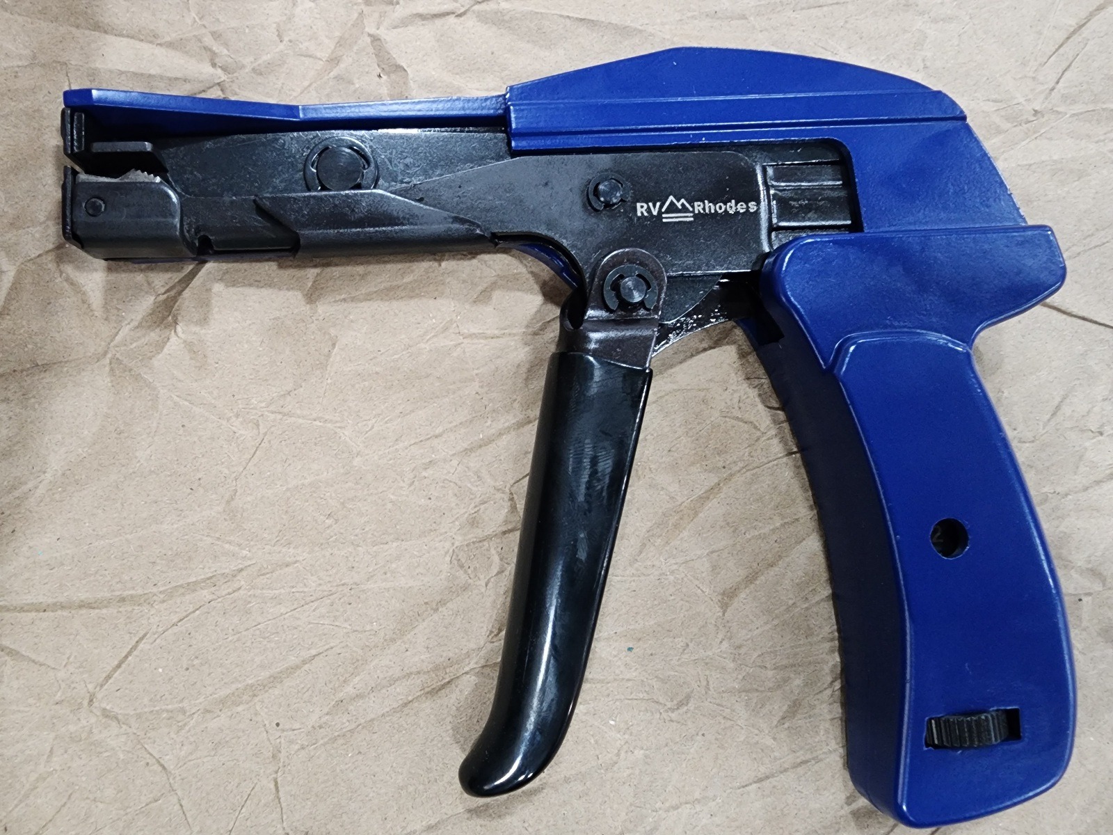

Randomly just tossing out a good tool I've come across through a fellow coworkers recommendation and now use regularly...
I use these zip tie tensioners/flush-cutters anytime I'm a zip tie-ing. They provide an adjustable and consistent tension for ever zip and cut them flush as well! Kinda spendy at $25, but I'd go with the all metal "RV Rhodes" brand if you are gonna spend the money. I have two sets and they work great. I recommend if you're looking for a good tool.

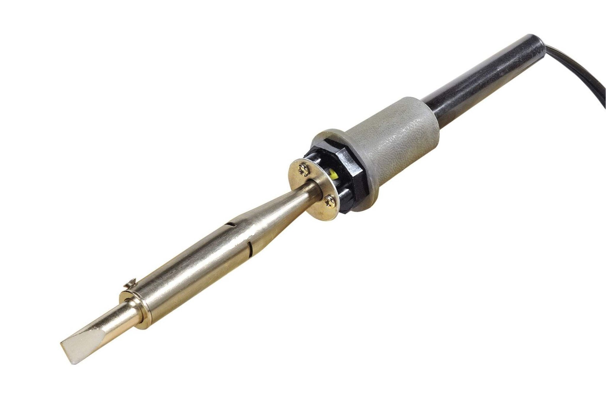

I find that it's useful to have a really powerful soldering iron for those times when I'm soldering large masses of metal like speaker terminals and other connectors. I have an old 80 watt Weller iron which I use for those occasions and it just makes life easy. The joint is done in 3 seconds and the parts don't get overheated.
