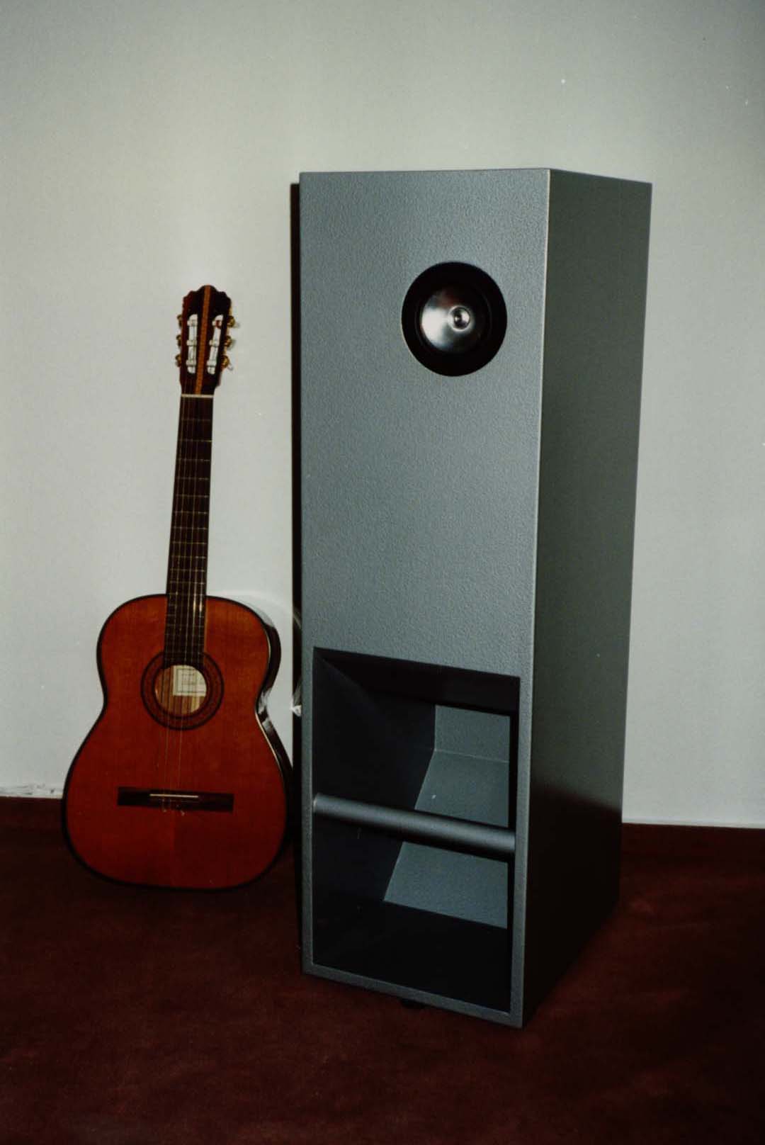

If you go for the Jordan JX92S you may also want to consider this design
Tobler-ONE: DIY Jordan JX92S Transmission Line, single driver loudspeaker
It's based on one of GM's MLTL designs for the driver. The triangular cross-section cabinet has a couple of advantages over a square-section tower: It reduces the audibility of reflections from the inside of the cabinet and it places the driver at the recommended toe-in when it is placed against a rear wall.
I've built several cabinets for this driver, including the 31" and 48" MLTLs. The 48" goes down to 35Hz and is a very enjoyable speaker to listen to. It will require some BSC to get it sounding best. The 31" rolls off at 45Hz and is a 'cooler' sound, more technically accurate. It doesn't need BSC but OTOH I've found it more sensitive to stuffing (and I'm not convinced I've got it right yet after living with it for almost a year).
The James Jordan | Evaluation and Renovation of Existing Buildings, Additions, and New Construction. also has variants on the MLTL for the JX92S but I haven't tried these (yet) so don't know how they compare with GM's designs.
Hope that's of some help.
btw, has anyone here has heard the Tuba horn-loaded enclosure - or the German HiFi magazine horn?
hifisound eShop - E.J.JORDAN HORN KOMPLETT-BAUSATZ S
