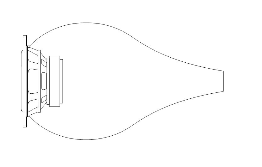

Internal structure.
When a loudspeaker driver is operating it will have as much sound emanating from the rear of the cone into the cabinet as it has emanating from its front into the room. You only want to hear that from the front of the driver. The sound from the rear of the driver will tend to reflect from the inside panels and cabinet and come back out through the cone. The material of the cone has to be thin in order to make it lightweight. Being thin will make it acoustically transparent.
The sound inside of the cabinet will be changed by the shape and size of that cabinet. At certain frequencies, where the wavelength (or a multiple of the wavelength) of the sound is equal to a cabinet dimension, you will get standing waves form. These have nodes (minimum air movement) at the cabinet walls and antinodes (maximum air movement) in the centre of the cabinet. Standing waves will act to amplify the frequencies at which they occur resulting in sound that is reflected back through the driver being very peeky. The normal method of reducing the amount of reflected sound coming back through the driver is to line the inside of the cabinet with absorbent material, wadding, like foam or wool. There is a problem with this approach. Generally the minimum amount of air movement (nodes) are located at the cabinet walls and the maximum air movement (antinodes) is in the centre of the air volume. Putting the wadding where the air movement is at a minimum is very inefficient. Ideally you would like to put most of the wadding in the centre of the speaker.
Making the walls of the cabinet non-parallel can help to prevent the formation of standing waves and make the sound reflected back through the driver less peeky. Making the inner surface of the cabinet irregular can help to further break up the sound waves but this is only really effective at higher frequencies where the size of the irregularities are larger than the wavelength of the sound.
For my cabinet I have used a very different internal shape, a cross section of which is shown below.
Perpendicular to the axis shown the section is circular at all points. The internal volume is made of two intersecting shapes. The front section is an Ellipsoid that is 20% longer along its major axis. An Ellipsoid is used rather than a sphere as a sphere has all its dimensions the same in all directions which could cause a standing wave at one frequency. By using an Ellipsoid the formation of this standing wave is avoided. The rear section is a logarithmic cone that smoothly transitions from the front section. All sound waves emanating from the driver are reflected towards the rear of the cabinet. Apart from the small flat rear panel, which is only 32mm in diameter, there are no surfaces that can reflect sound back towards the driver. As sound waves travel towards the rear of the cabinet their amplitude will become greater. To promote the sound being reflected to the rear the inside surface will be as smooth as possible so that it acts as an acoustic mirror. The absorbant wadding will be inserted in such a way that there is an equal weight of wadding per unit length of the speaker. This means that the density of the wadding will increase exponentially towards the rear of the speaker. I have a couple of hundred grams of Mundorf elves hair which is recommended to be used at 10g/litre. As the cabinets will be 4.5 litres I'll start at 45g and experiment from there. I'll start the wadding from just behind the driver with it fluffed up as much as possible by the time it gets to the back it will be compressed to about 40 times this density. In order to reflect back through the driver a sound wave would have to make it all the way through the increasing density of wadding, then reflect off the tiny rear panel (which will have a 5mm felt disk attached) and then make it all the way back through the wadding. I think that the sound wave will be almost entirely absorbed by the time it reaches the felt disk so virtually nothing will reflect back as far as the driver.
Back at the front of the speaker, the internal angle of the cabinet where the driver is mounted is 45°. This will allow the rear of the cone lots of room to breath. There will be stanchions around the mounting hardware.
Hopefully these measures will totally eliminate the rear wave from the cone and prevent any of it reflecting back through into the room. Only time will tell.
Niffy

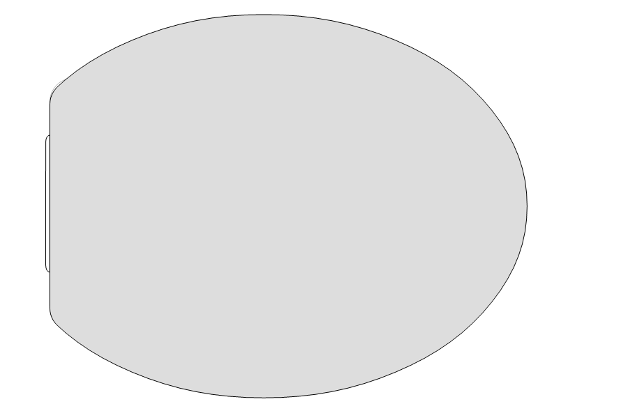

External Shape

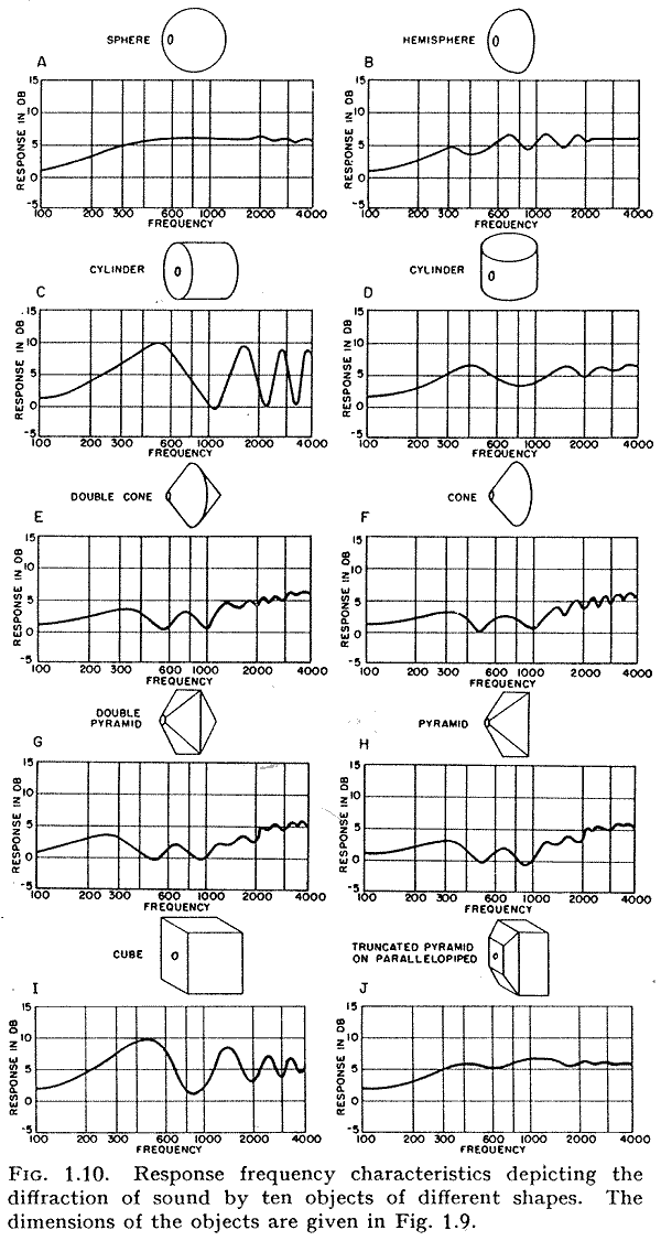

Many of you are probably aware of the study by Harry Olson into the effects of cabinet shape on diffraction. This chart is very often quoted by manufacturers. I saw it being used by two different manufacturers at this years Bristol hifi show.
The funny thing is that it is actually a really old study carried out in1950 without the benefit of modern equipment. The cabinets used were also enormous, 2 feet in diameter, and the driver quite small. The driver in the study would have acted more like a point relative to the size of the cabinets (which were made of pressed steel). I definitely don't have room for speakers this size. My cabinets are 280mm in diameter and the frame of the driver is 149mm so the attachment is going to be somewhere between a sphere and a cone. Funny how the manufacturers don't mention this. Regardless, a basically spherical shape is still going to give the best diffraction characteristics.

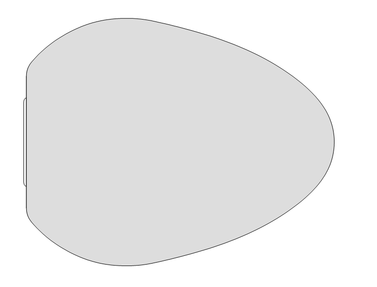

For domestic harmony I set my maximum cabinet size at 300mm high and wide and 350mm deep. I started by making the front spherical and transitioning into a parabolic rear end. Reducing the maximum diameter to 280mm improved the appearance. I still found that this looked too pointy at the back. I tried making the rear elliptical which worked better but still didn't look right.
More playing with shapes and it struck me to not use a composite shape but to go for a more simple shape and so I went for a single elliptical Cross section, an Ellipsoid.
This looks much more organic, more balanced. I really like this shape.

Many of you are probably aware of the study by Harry Olson...
Indeed. I was the one who scanned that chart.

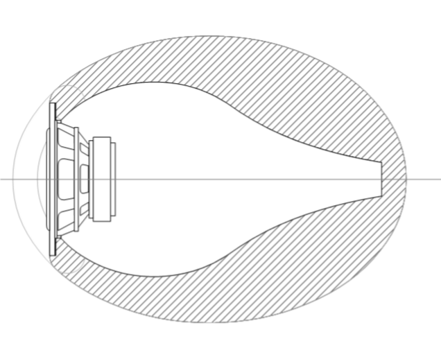

Construction.
The combination of the inner and outer parts of the cabinet.
The wall thickness varies from about 40mm at the front to a maximum of about 100mm near the rear. OK, the very back is only 24mm thick but this is only 32mm in diameter and surrounded by much thicker walls. The rear section is almost a solid block. The outer volume of the speaker is about 2.5 times the internal. The speaker will be mainly cabinet.
The cabinet will be made from 29 layers of 12mm baltic birch plywood. The cabinet will be constructed from disks cut with a router and glued together. This will give a stepped profile. The steps will be smoothed using flap sanders. I anticipate that this will make a lot of dust. When gluing the layers together each layer will be rotated by 45° relative to the previous. This will give the cabinet a more homogeneous rigidity. I could have used thinner ply. This would have required more layers but less sanding. It would also mix the 0° and 45° layers more making it more homogeneous. I could have used thicker ply. This would require less layers but would need more sanding. The main reason I went for 12mm is that I already have 3/4 of a sheet.
Another advantage of making the cabinets spherical is that a sphere is an inherently rigid shape. Even if you consider that the cabinet is a more conical shape where the driver mounts, a cone is also an inherently rigid shape. It's why speakers drivers are made from domes and cones. I think that the combination of the rigidity of the shape and that the speaker will have no baffle to talk of will more than compensate for any deficiencies that translam may have. Add to this the thickness of the material used and that translam should have better damping. A large ply panel, even well braced, is going to have a more resonant character.
Having such a thick wall will make the cabinet acoustically opaque.
I have seen quite a few translam builds where the layers are stacked horizontally and quite a few where the layers are stacked vertically left to right. So far I haven't seen any where the layers are stacked vertically front to back. I hope there isn't a reason for this that I have overlooked.
Niffy
...the rigidity of the shape and that the speaker will have no baffle to talk of will more than compensate for any deficiencies that translam may have. Add to this the thickness of the material used and that translam should have better damping
The rididity will be affected by the construction (reducing it), but the wall thickness should compensate. Divide wall thicknesses by about 2 to get the eqivalent of what the sheet used in the intended direction will be. In the thick parts you could also add a cavity to be filled with something other than wood.
I see no reason to make the assumption about damping.
dave
