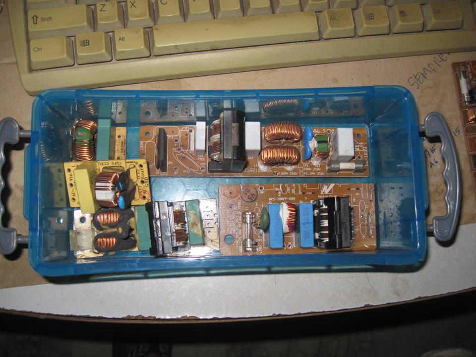

Agrees Gusser and that's why I consulted Jon way back when.
My inductors are custom wound with very heavy gauge copper
wire wound over an stack of I plates thats use making EI transformers
There's harding any voltage drop even under high current draw. You
can hear it with heavy low bass music especially from Kudo drums
Cheers
btw, ATX psus, and some old color tv's uses these emi filters,
i harvest many of them for later reuse in many of my projects...
