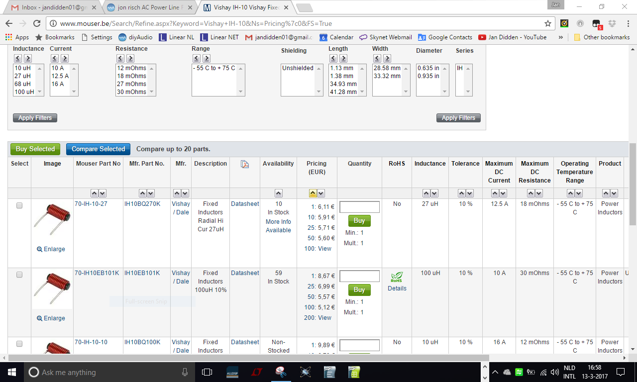

Thanks - I know - I will use 8 pieces of this inductor (in Europe is 220-240Vac).
I just can't locate the part where I could buy 8 pieces and not 100 and in Europe.... 🙁
Irwin AR thnx
best regards
tomy
inductors
sun:
Mouser, a division of TTI in the US, will ship to Europe. The Vishay inductors are quite expensive in small quantities, but will cost you less than the 100 Vishay or JW Miller minimums from TTI or Future in Europe.
Maybe you can set up a Euro group buy? The JW Miller inductors should run under 3 euro in quantities >= 100.

Mouser offers free shipping on orders above € 50 to most European countries.
Jan
